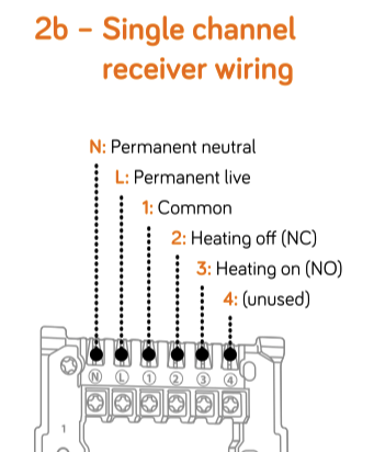

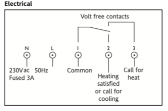

I'm looking at replacing a Drayton Digistat RF system with a Hive. Because of the £70 price difference and to save having to wait in for an engineer I'm looking at doing it myself. The wiring for the two devices looks as if it will be a straight swap out, even using the same backplate for the receiver.
Hive on the left, Drayton on the right:
Can anyone tell me if I'm correct in this assumption?
Many thanks in advance.

Yes it is just a straight swap you can even reuse the existing backplate.
A quick footnote. I was able to use the same backplate, didn't even need to swap the cable, Hive just clipped on. One (hopefully) small point, there was no wire going to terminal 2, the 'off' connection. Doesn't seem to affect the operation in any way so I've just accepted it.
There shouldn't be any connection to the off position, your system doesn't need it.
That's what I had assumed, many thanks for confirmation.

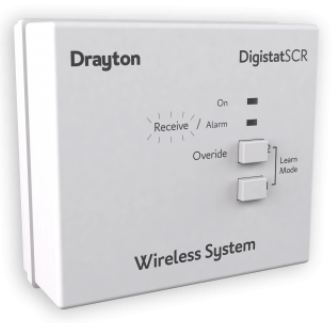

Hi, the backplate for the existing Drayton SCR controller, the box connected to the boiler, was almost identical to the one provided with the Hive. Two screws on the base loosen and the front of the unit lifts up and removes. The 5 connectors along the top edge are identical on each unit, there were only the 3 wires as mentioned in my previous posts, so not too confusing, and the Hive simply plugged back in, tighten screws and that's it. I'm guessing this is a standard that has been adopted on newish systems, the original unit is less than a year old, this was it:
