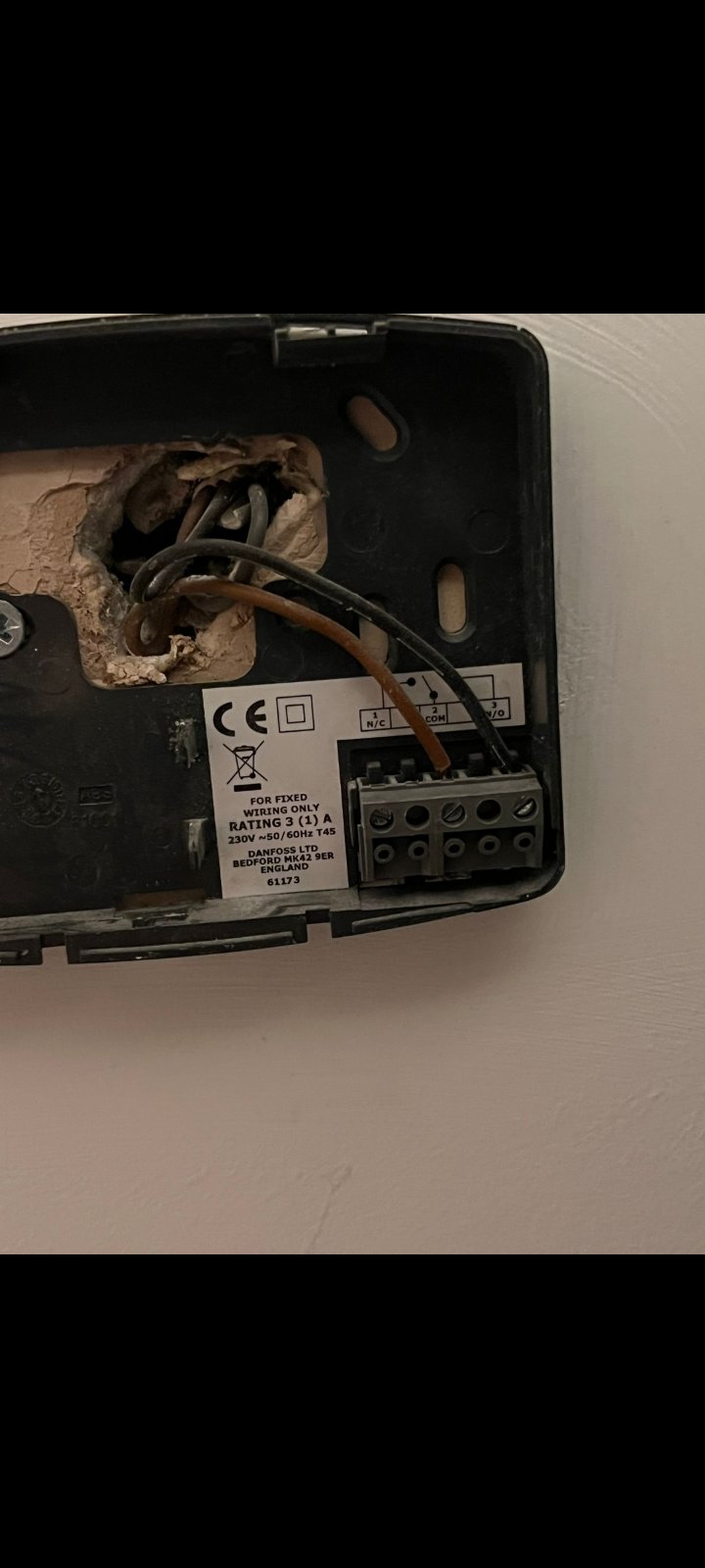

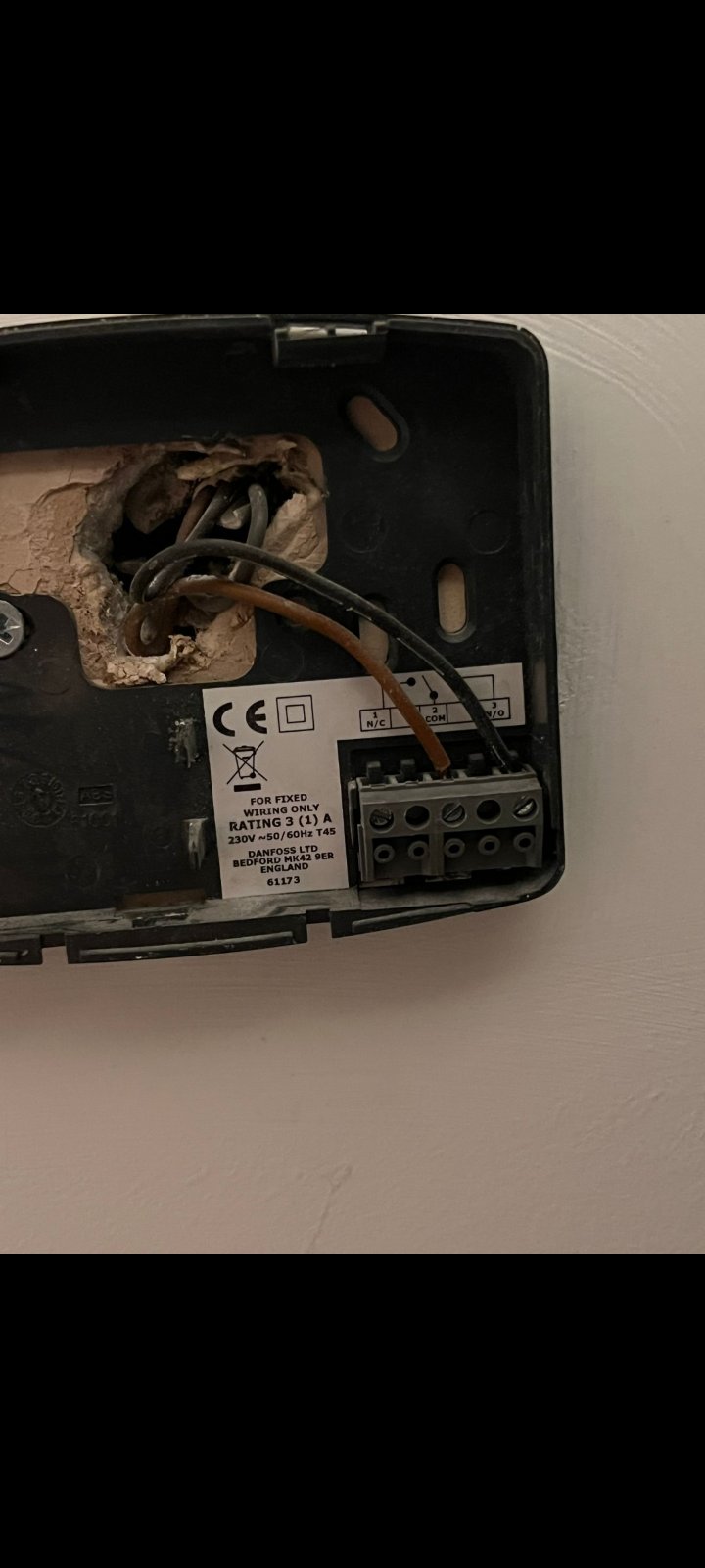

Would a hive stat wire on to this? Is a s-plan plus, 3 zones. Currently only 2 wires to the stat. Live and switch live?
Wires
Yes, but probably best with changing existing programmer if there is one, or wiring at the wiring center. You’ll also need a dual and single channel Hive. Whereas the Drayton Wiser does a 3 channel (x2 Heating and hot water). Yes, existing is live and switched. If you wanted the receiver in place of that, you need to confirm there’s a permanent live and a permanent neutral.
Thanks I think that is the stat and programmers?
Programmable room thermostats, so in a sense, yes they are. In which case, better in the wiring center for the Hive, if you’re still planning on it.
So I'd have to alter wires in the wiring centre to fit a hive?
Yes, or trace the wires at existing to ascertain if they’re connected. If they are then you can utilise them, if not, connect at the wiring center and receivers can go there. Personally I think it would be easier to change at the wiring center. If you want an all round easier solution without changing wires, then change for mains switching battery operated programmable thermostats. I don’t understand a lot about people wanting Hive.
The is quiet abit of work to swap for a hive then. As this stat just does heating, if swapped for a normal stat. Would any single channel programmable one do?

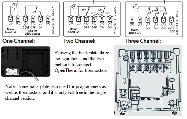

There are two types of thermostat/programmer wiring wise, those with volt free contacts, and those where the contacts are connected to the supply to the device.
Any electronic thermostat/programmer must get power from somewhere, be it battery or mains, with built-in mains power supply or external mains power supply. Nest is the odd one out, with external mains power supplies (USB) and battery powered hubs (Nest e) but Nest does not connect to TRV heads so rather a poor thermostat.
The Hive/Wiser/Honeywell etc use a common baseplate, Thermostat back plate.jpg I don't like the idea as put the wrong unit on the baseplate, and you can get 24 volts and 230 volts connected together, but it has been used for many years, so unlikely to change in a hurry. But the single channel version is volt free.
So with the single channel version, you could get the supply from elsewhere, not a good idea, as if you want to run heating from a generator at any time, it means you have not got a single supply point, but the same applies with the likes of Nest when it uses a USB supply.
