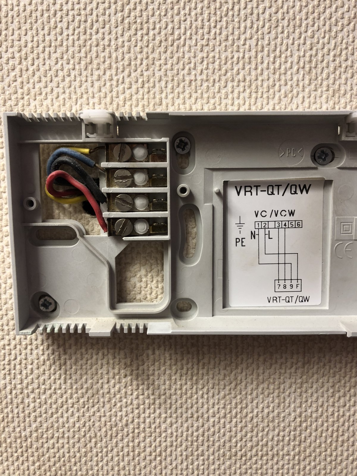

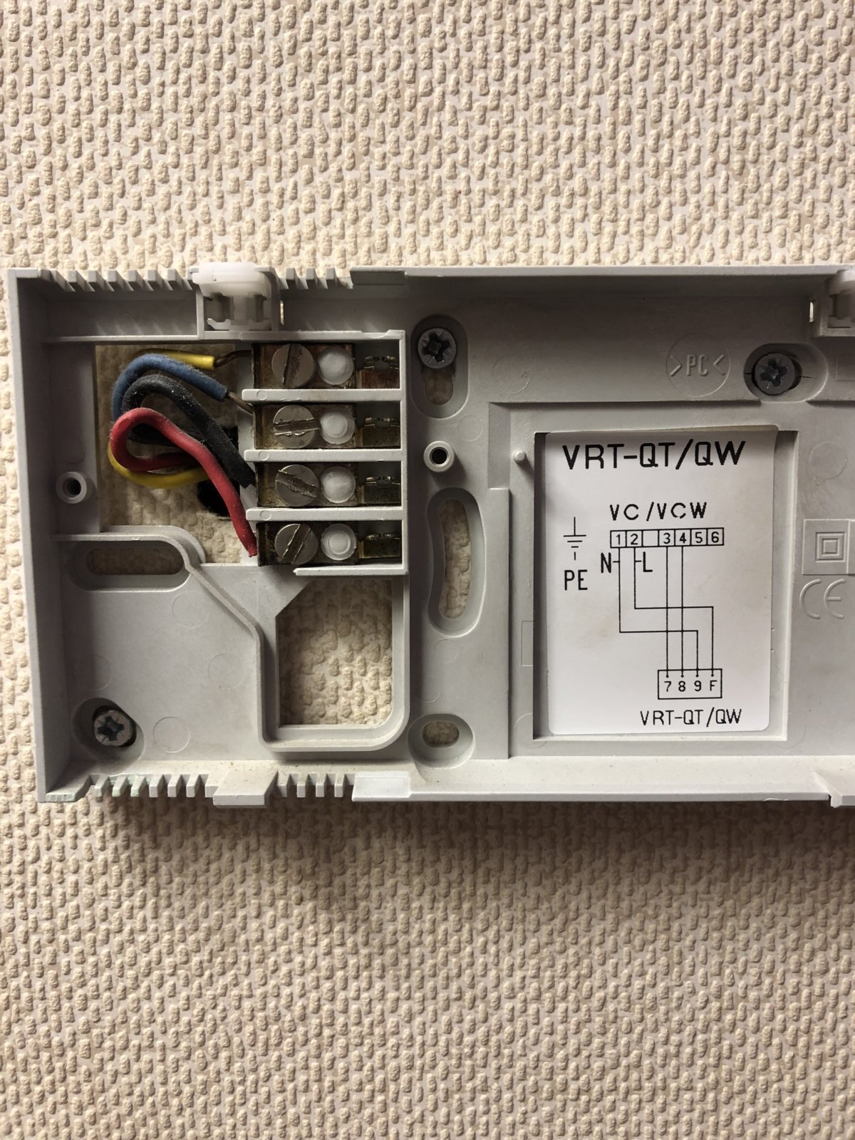

Hi,
I am wanting to fit a hive combi thermostat on a Vaillant Turbomax boiler. My existing stat is a Vaillant VRT QT 9083 with combines timer and stat (pic attached) and I am wondering if I can wire in the hive receiver directly to these wires on the basis that the hive will be controlling the same functions (timed on/off plus temp control)?
Any advice gratefully received!

OP, yes you can as per the wiring diagram in your picture. Please ignore the advice of the nonprofessionals on this site. The incompetence is breathtaking.

Thanks Dan. So the wiring from my existing VRT-QT time clock will connect in a similar manner to the Hive receiver connections?
I will pick my Hive up tomorrow so I won’t know the terminal numbering until I do but am aware that these connections can vary.
Oh - and the existing clock/stat is probably a lot wider than the hive receiver so do I need a specific back plate to adapt to the hive receiver?
I like the idea of the receiver being away from the boiler as there should be less chance of interference with the WiFi signal if the controller (hub) is closer to the hive receiver. I can then mount the stat elsewhere.
It all seems to make sense in my head but please tell me if you foresee any barriers.
Many thanks.
The Hive is supplied with it's own backplate. The existing one is removed.
Electrically, it's identical - 2 wires for the mains supply and 2 more for an on/off switch.
Hive will come with its own back plate L&N from your existing to L&N on the hive receiver, then the other two wires to 1 &3 on the Hive, doesnt matter which way round it is just a switch
Thanks Ian - I will give it a go tomorrow and post back but the wiring guide is very helpful. I appreciate all your advice guys.
