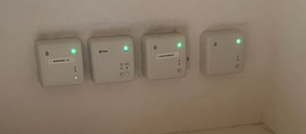

I replaced the “invisible heat” thermostats and wiring centre for a wet underfloor heating with Hive.
The underfloor heating has 4 zones with a thermostat on each zone.
The engineer installed one hive receiver for each zone. Four in total.
So far so good. It all seems to be wired correctly and working fine. However, when you select a zone to heat all the zones go on. Basically an on/off switch. I cannot warm up zones individually.

I attached some pictures of the manifolds and hive installation for reference.

Were they thermostats or heat sensors? If the latter, then it might be correct that standard thermostats do not work.
Then each Hive needs to correspond with each zone, which I suspect isn’t happening, which would possibly be the wiring up of them.

If you originally had 4 separate standard room thermostats and the system worked, then I can't think of any reason why replacing them with 4 Hives wouldn't work. From an electrical point of view a thermostat is only an on/off switch and so is the Hive. [It's the software that tells the Hive when to switch on/off that is the clever bit] So electrically, you are simply swapping one identical item for another identical item.
When you turn just one zone on, do all of the receiver lights come on?
What happens if you start with all of the zones off and then just switch one receiver on manually using the button on the front?
Having said that, I'm not familiar with an “invisible heat” make of thermostat, so it may be a non standard device. Do you have any details of them?
If dual channel have been used. I suspect that x3 single channel and one dual or all singles?
Three singles and one dual according to the OP's photo....
....if the dual is for one heating zone and hot water, I wonder what this is this doing?
Are all 4 receivers linked up to the same wireless thermostat by mistake?
Hmmm, that's what I was wondering, when I asked.
That would help determine if it's a wiring issue or not.
Hive can do 6 Zones maximum, so the number of zones isn't an issue.
It would be interesting to see the wiring behind those receivers.
