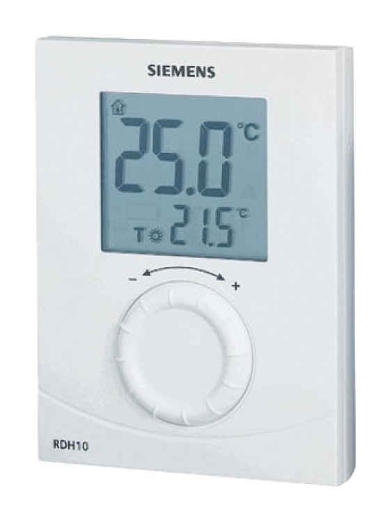

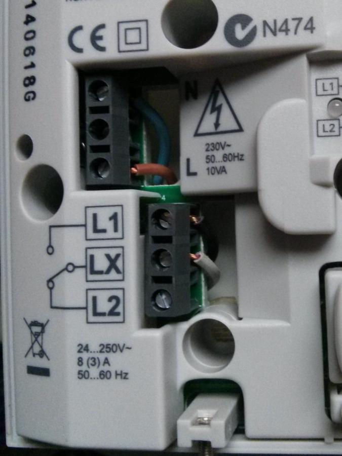

I was thinking of replacing my existing thermostat with a hive active heating kit. I currently have a Baxi Duo-tec combi 28 HE x boiler and siemens rcr10 433/gb receiver. I have included a image of how the current one is wired below(apologies for how large the image is). There is also a green/blue wire that is not connected. But that has not been connected for more than 18 months that I have been living in the current house. The manual for wiring it looks like it is at: https://w3.siemens.co.uk/buildingte...ls/documentation/Documents/RDH10RFSETData.pdf
I was looking for advice of how to wire it and if it is compatible.
Yes the Baxi is compatible and usually a combi with a receiver hooked up to a programmable thermostat is one of the easiest to swap over.
However, according to your link to the Siemens documentation, you have a Siemens RDH10RF room thermostat like the picture below linked to your receiver, which is not a 'programmable' thermostat.
So, if the RDH10RF doesn't provide any time control, what does?

Thanks for the info. The control unit is a RDJ10RF unit.Looking at the image from above that is only showing 4 wires while it appears the Hive unit on their manual online requires 5 wires. Just unsure with the LX connection if that should go to the common connection on a Hive. As well the current one seems to not have a connection for switching heating off (L2) and was seeing if the Hive would still operate if that connection is not connected up.
Since I mainly have a small house I thought a Hive would be enough, as most of the time one room in mainly used. Just I was under the impression that unit I mentioned in this post would control the temperature for if the boiler is on or not. As I thought it was a boolean true or false if it is on.
You do only need 4 wires. The wiring at the existing receiver can be identified from your photograph as follows:
Blue wire = Permanent Neutral
Brown wire = Permanent Live
Grey wire (LX) = Common
Black wire (L1) = Heating On
If / when you get a Hive, the four wires go to the terminals in the Hive receiver that are marked accordingly. You don't need a connection to 'Heating Off' as you don't have one now (L2)
But you didn't answer the question about the time control, is there a timeswitch somewhere else?
Sorry, RDH10RF, does have time controls on it. Only has 24 hour time control. So it has the same pattern as on weekend as a weekday. It as A1=heating on, A2=heating off, A3=heating on, A4=heating off. For each of the A ones it asks for a set time for that to happen, and then when run is selected it runs that pattern if it is set to automatically come on and come upto a nighttime or daytime temperature depending if the heating mode on the RDH10RF is set to keep above daytime or nighttime temperature.
OK thanks for the update. Then you only need to exchange the existing receiver for the Hive (single channel version) no further modifications are required to your system.
