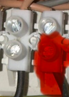

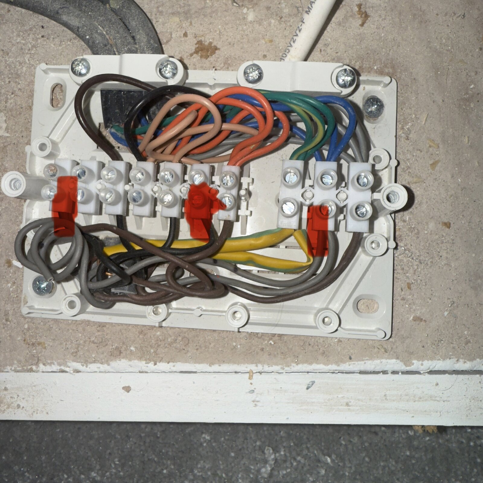

Hi DIYers!
Last night I had the misery of installing hive to our home! At least in part!
So far:
- I’ve connected up the dual receiver in place of a previous Honeywell
- I’ve removed the cable supplying the thermostat from downstairs
To do:
- Add a link to the live/switch live of the thermostat removed.
- install second receiver for upstairs - wireless stat.
QUESTIONS:
1) on the link I still need to add, the live wire shared a terminal with a switch live over in terminal 1. Am I okay to link between terminal 6 where the stats black cable was over to terminal 1 if this currently has a black cable in there from another cable?
2) I’m at an absolute loss of what my second receiver needs from this box - any idea of this would be dandy to get me on my way!
Cheers people!

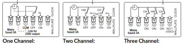

It depends on how you want it to work, I am using Drayton Wiser, which is basic same connections
you can have with Wiser I seem to remember up to 9 thermostats per channel, the two channel is designed for DHW and CH, to get two hard-wired zones with CH it needs the three channel version. In my home we have a main house, and a flat, so it would be a good idea to have the flat and the main house on hard-wired zone valves.
But within the main house, the TRV heads do the same as a hard-wired motorised valve, but allow gradually closing and opening rather than all or nothing as with a hard-wired motorised valve, and the way the boiler works, it wants the demand to slowly increase and decrease, not to be all or nothing, so unless using an old oil boiler which does not modulate, and capture the latent heat from flue gasses, the control needs to be as much as possible by the TRV heads, not any hard-wired motorised valve.
Even with my oil fired boiler, the use of TRV heads is far better as to using hard-wired zone valves, I say hard-wired, as the TRV's are zone valves, all mine are programmable, but only one is linked to the main hub.
My guess is these two 1753532784300.png need linking together, so both the old zone valves work together. But without testing, can't be sure. I am not sure, I did the right thing using the TRV head to turn the heating on/off, I assume Hive is the same as Wiser, and you can have multi-devices connected to one channel, to trigger the boiler, I have three devices, two wall thermostats and one TRV head.

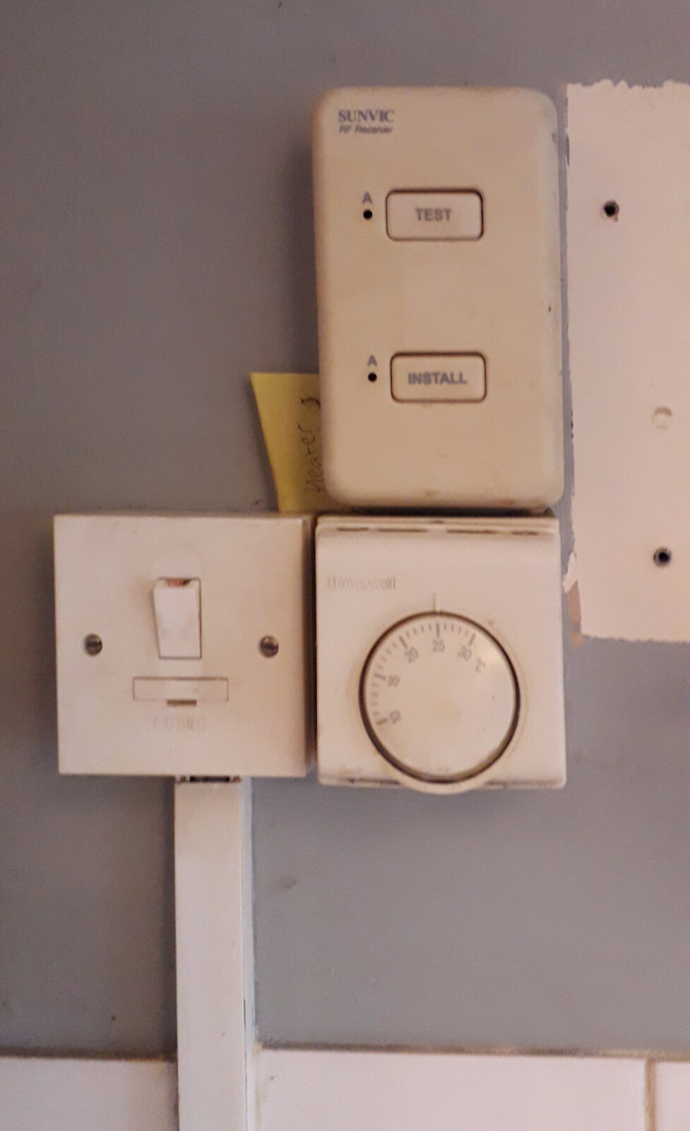

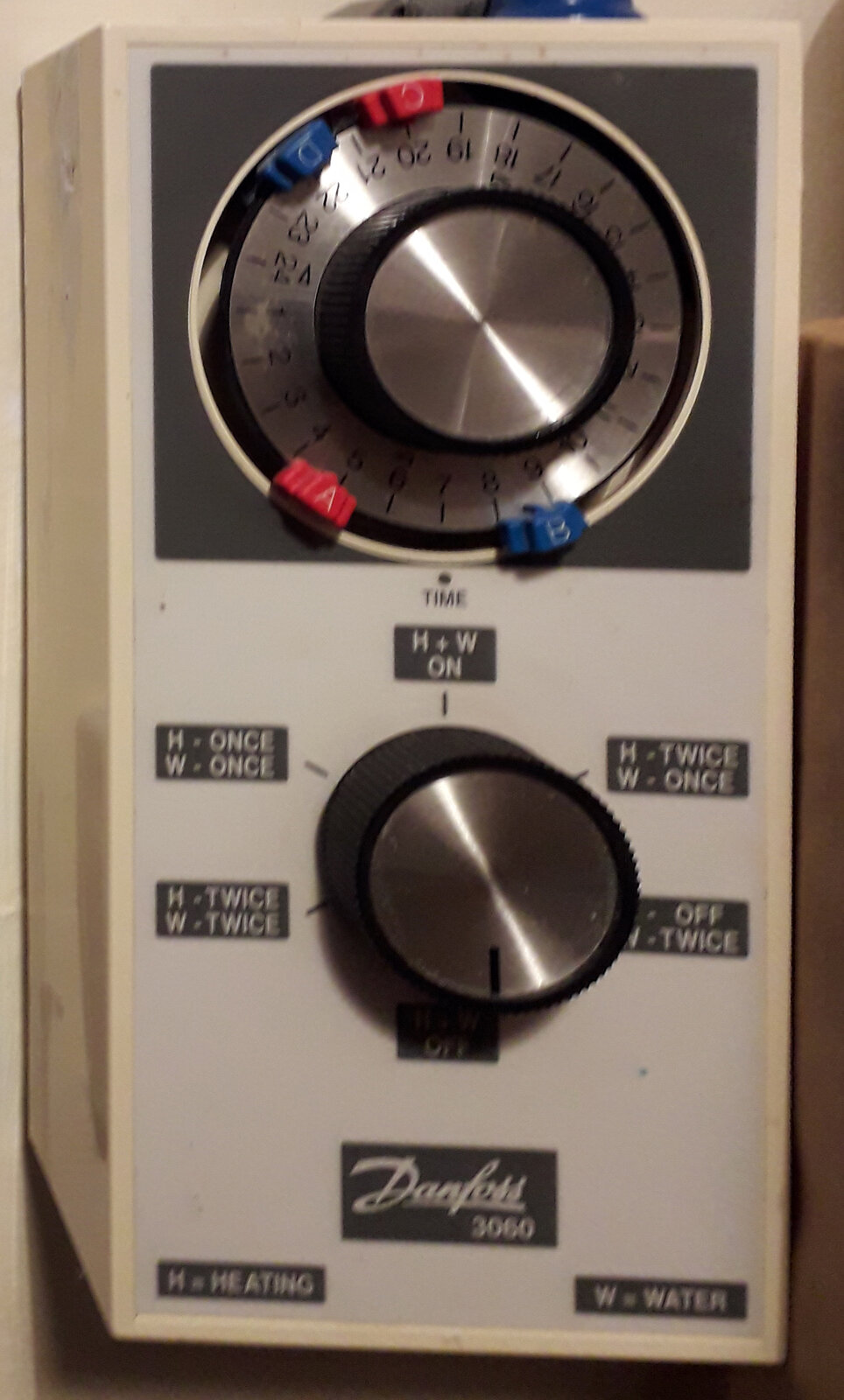

When I came to do my central heating I employed a plumber to do the plumbing work, had not expected him to continue with two pumps, but by the time I found out, too late. So I was left with the original programmer, Danfoss3060programmer.jpg and I had to consider what to do, the thermostat 20190619_063642.jpg never did find the wireless unit, only the receiver, and when testing the cables, the three core only had two cores working, so I decided best was to label what when where and start from scratch.
