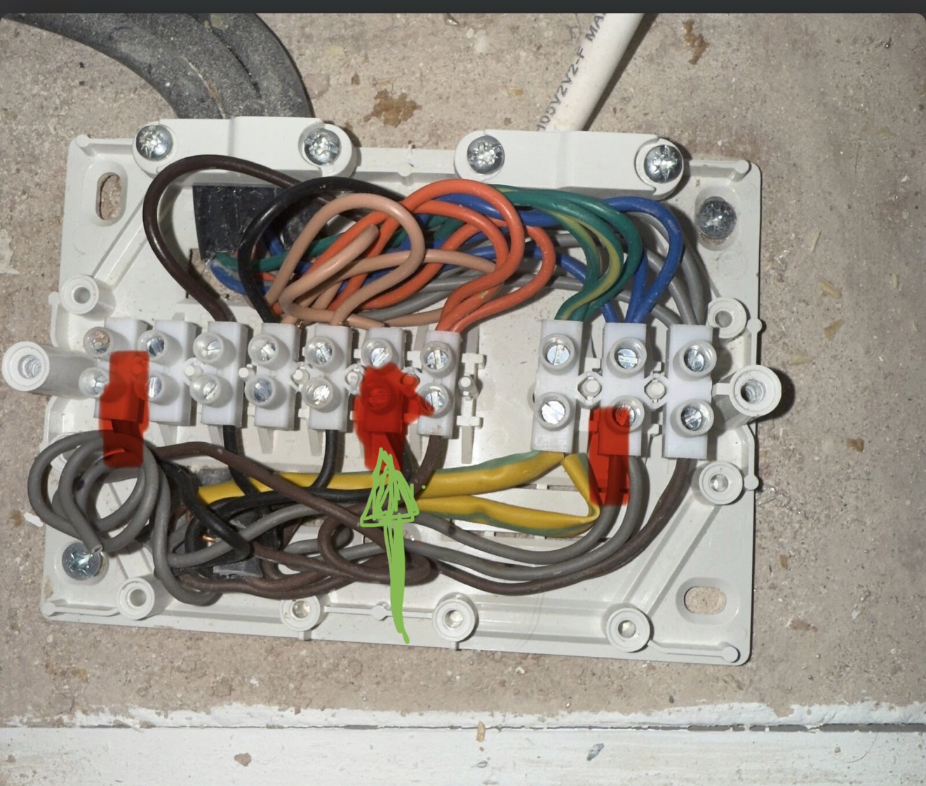

Yes the ones at the bottom are supposed to be the stat ones. Right, do me a favour, the red marked photo that you posted recently, which one was 240vac when the stat was live/turned up?
Hi!
It was the black cable 2nd in from the left at the bottom marked with green arrow!
The new hive stat fires up the boiler but no action so assuming I’ve cocked something up wire wise!

So no bridge is required, the black which was the stat, if dead the other end can be safely terminated. Your additional Hive needs to send the heating on in place of that.
Can’t see that happening tbh. If the boiler fires when demand created, then I’d say it’s something else

So further testing and mauling and the issue seems to indeed be with the zone valves. On manual the boiler is working as normal and the radiators are heating up. However on the normal mode I get nothing from them. They click so I’m assuming the signal is reaching the valves but the level is not moving automatically (I’m assuming it should), do you think I’ve removed the wrong cable as mentioned earlier
Pre the programmable TRV head, the heating could be split into zones, and the zone valves act as a relay, so the valve has to be open, before the boiler can fire up. And we did not have by-pass valves, this is why the zone valve had to open before the boiler turned on.
When the programmable TRV came out, we required the by-pass valve, or the pump could be pumping against closed valves. Sometimes the by-pass valve is inside the boiler, and sometimes exterior to the boiler, and the pump is on the output of the boiler, but some old boilers had the pump on the return, I have also seen where the by-pass valve is after the motorised valve, theory this is OK, but in practice the micro switches in the motorised valves have been known to fail on, so in practice better if the by-pass is before the motorised valve so if the micro switch sticks it is not pumping against a closed valve.
The whole idea of Hive, EvoHome, Wiser etc, is the TRV controls the heating, however the plumbing does need to be correct for this system, the programmable TRV forms zones without the need for hard-wired zone valves, but I have seen Hive etc fitted without the programmable TRV heads, so in some cases, the zone valves are still required, until the TRV heads are changed. In fact, I have seen multi-hive thermostats/hubs fitted, it seems there are a few Hive units, with varying ways to wire them, including OpenTherm.
