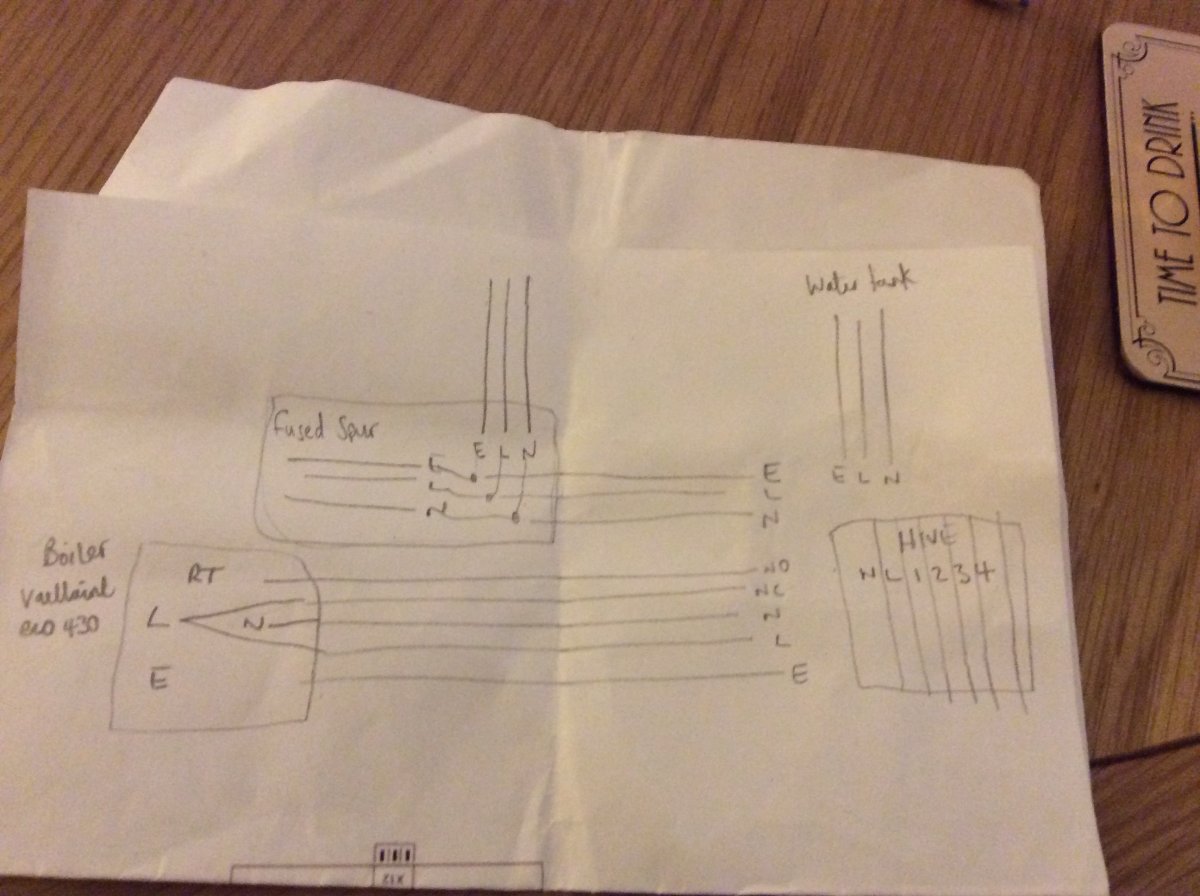

Could someone help me out with the wiring up of my active heating 1 on open vented system vaillant ecotec 430.
Many thanks.
Many thanks.
Instead of starting your own thread you have posted in the middle of someone else's!
But before posting you should read all those recent threads about similar topics.
If you did that you will see that a DIYer should not be opening up an Ecotec boiler because they are room sealed!
