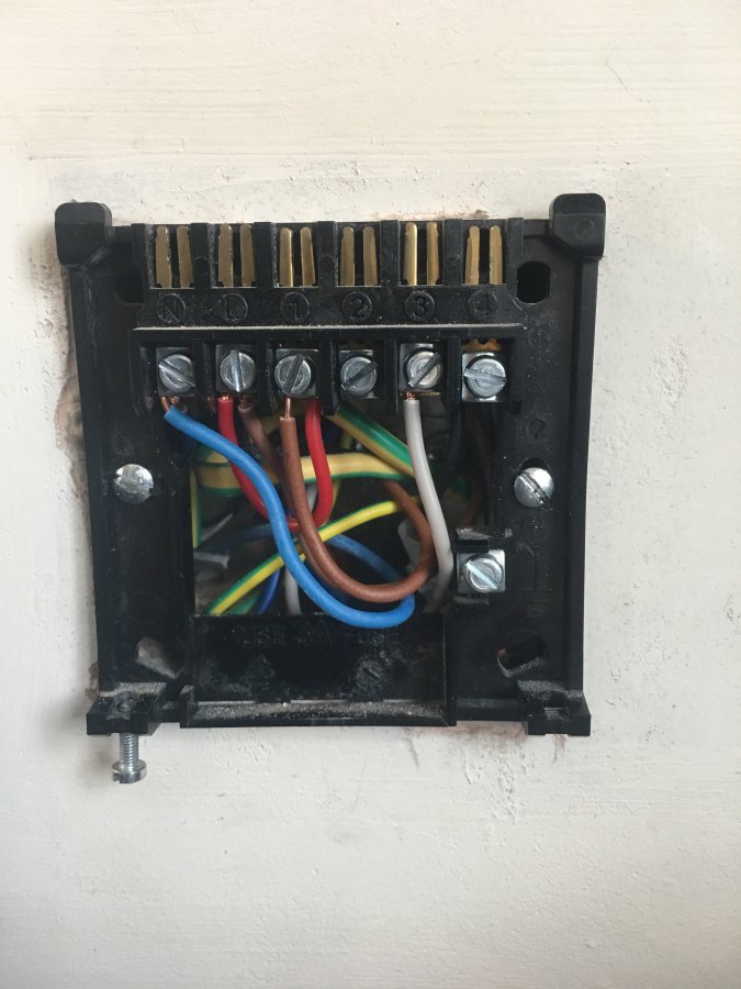

Hi All
I'm having some trouble getting my Hive 2 heating system working. The units are all connected wirelessly and the remote thermostat is working however when I try boost the heating nothing happens, nor will scheduling work so there's obviously a power connection but not a signal connection. There was an existing themostat mounted in the entrance hall which I removed to put the wireless stat in it's place and followed instructions to remove the old thermostat from the wiring centre (cables have been left in place as house is rented and we're taking Hive when we go)
I'll take some photos of what Ive done and see if someone can help me by letting me know what Ive done wrong. I am competent with electrics, ring mains and networking have just never done anything involving the boiler before.
Thanks, Spadge
Photos to follow.
That is not wired correctly at all, the black wire from the boiler flex should go to 1 with no other wires, the grey wire from the boiler flex should go to 3 with no other wires, the existing thermostat cable should be disconnected.

Thats how it was wired, I havent moved any cables simply took the wiring away from the thermostat. Landlord has given permission for us to do whatever we want.

Fixed it like you suggested and appears to be working now. Everything in these houses was shoddily built on the cheap by the building company, wiring is atrocious, plastic piping keeps leaking and they didn't use a spirit level anywhere in the house (or even a tape measure for that matter). Behind the wiring centre that small red wire between Live and 1 was already there so left it in place and the black wire was just connected straight through to the old stat. How the heating worked at all with it so wrong is beyond me.

That link should be removed and the 2 brown wires connected into the L terminal. only the black and grey wires should be connected to the numbered terminals.

Yeah thats how it is now and appears to be working though am just trying to sort the pressure out as its crept way too high.
