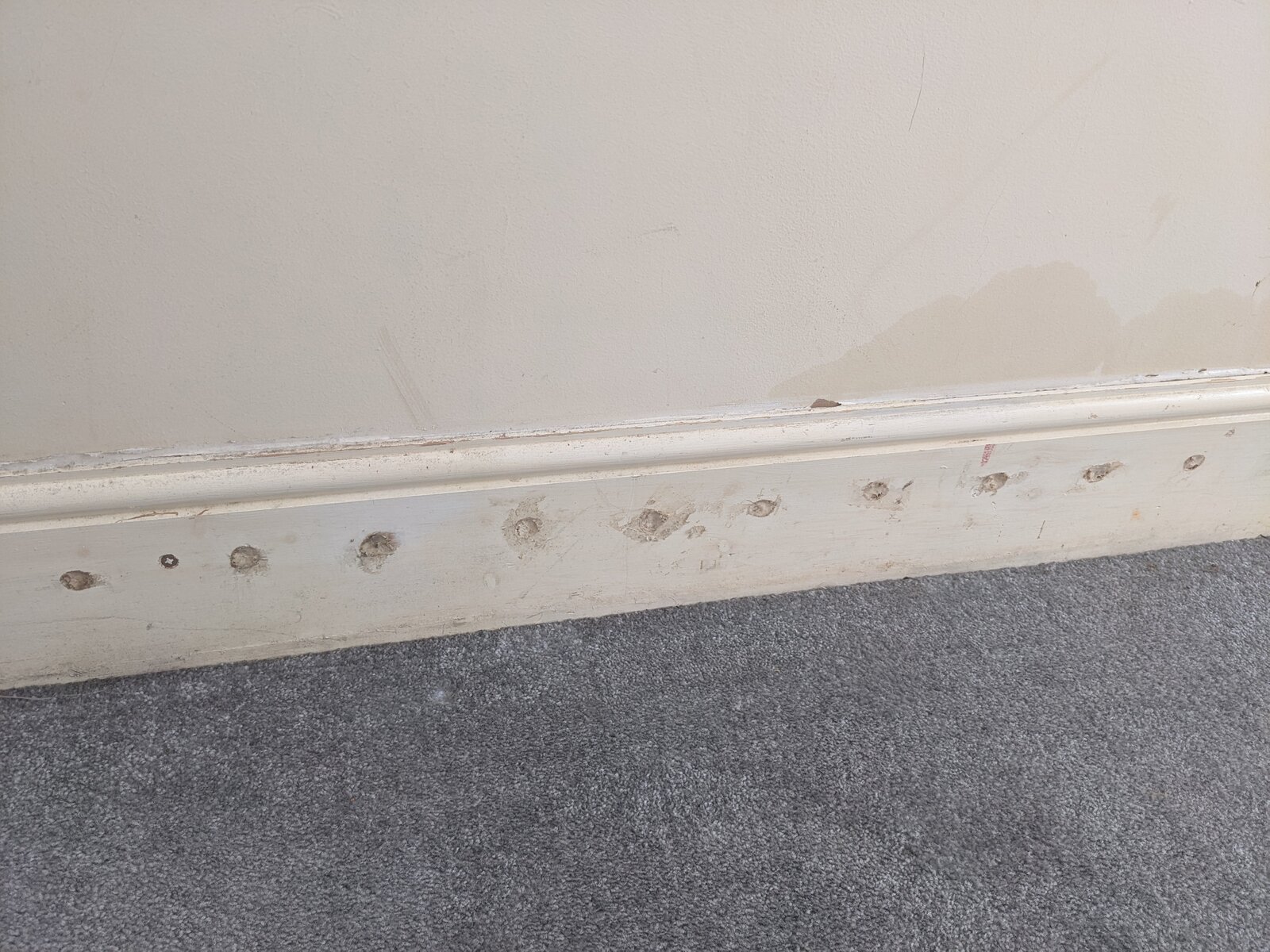

Hi all,

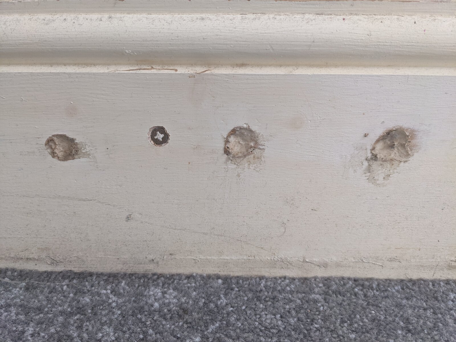

We're currently looking at buying a house that's a bit of a project. I was a little concerned when I found that a fair amount of the skirting boards on the ground floor had holes drilled in them. I've attached a picture for reference, you can see they've been filled afterwards. I know this is usually related to some sort of damp proofing or DPC injection.
Is this a significant cause for concern generally? For context, the house was built before DPC was introduced as mandatory (around 1860's I think). There were obvious signs of dampness and moisture - mould on some surfaces and a very musty smell.
I can't help but think it's a little odd that they didn't even take off the skirting to drill the holes? Is this indicative of a bodge job? Is there also a circumstance where rising damp issues are just impossible to fix?
Obviously, I'll be having a building survey if I go ahead with the purchase but I don't know much about damp, so if this is a huge red flag then I'd rather save the survey costs!

Whoever ruined the skirting was a bodging idiot but as to the extent of any rising damp ("a huge red flag") - how would we know on the basis of 900mm of skirting pics? There's a shadow on the plaster in pic1. but nothing else to indicate damp.

There are simple ways of dealing with all & any rising damp - in terms of buying a house in 2022 then its a nothing.
Come back here after the survey and get further help.
not really, the problem is getting professional advice and professionals to sort it out.
Generally most damp problems are fully fixable - and permanent if done properly.
a damp wall can be stripped back to bare brick, fit a membrane like Oldroyd and then plaster
Obviously you want to find the source of the problem too.
The holes in the skirting are laughable - only a complete muppet wouldn’t ping off the skirtings first
OK, thanks both.
Yeh I wasn't expecting a full assessment based on those pictures. Would guess then from the holes in the skirting that it's possible the guys who made the first damp proofing attempt may not have done a great job...
