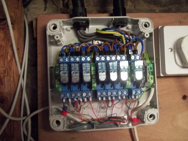

For simple ON - OFF control of mains voltage I use DIN rail mounted relay sockets in a consumer unit housing.
The space under the relay can be filled with plug in indicator LEDs to show the state of the relay.
The relays I use are Finder but other compatible makes can be found
For single pole change over relay 40.61 base 95.83
For two pole change over relay 40.52 base 95.85

Impressed with your set-up.
