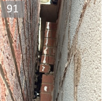

Hi everyone, hope you are all well.
We are in the process of purchasing a property and wondered if I could get some advice on a red flag raised as part of our building survey, just so we know where we stand with the sellers and any initial discussions we need to have with them.
The surveyor has said the following:
"Between the subject property and the left neighbouring property, the lean-to wall is found to have shifted, with the wall detached. We would recommend complete reconstruction where the roof and wall have been compromised. This requires opening up to reconstruct. We would recommend that a structural engineer further examine."
I have attached a photo that the surveyor took which shows part of the side brick wall (left of the property) giving way.

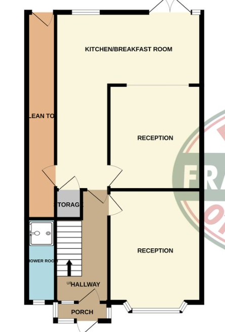

So, I have cycled through the photos and my memory of the house when we went to last visit. I have also attached the floorplan which may help visualise things!

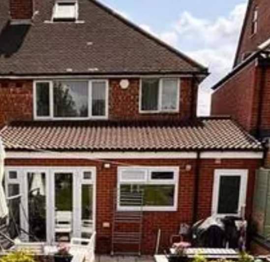

The house has had a number of extensions. To the rear of the main structure (non converted) of the house, there is a rear extension which was a kitchen extension.

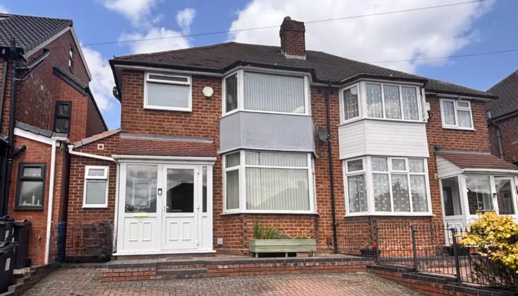

To the left of the porch in the above picture there is a two part extension. where the small window is (left of the porch) there is a small shower room which i understand was extended first.
Beyond that a second extension was done which goes the length of the building (to the end of the kitchen extension) effectively covering what would have been an alleyway (labelled the lean to). This is just used as storage. From my memory, this storage space had exposed blockwork on the interior.
So as far as my understanding is correct, there are effectively two parts of the side extension. It looks like the original wall of the house still remains and has been extended alongside the kitchen wall.
So what i think they have done is bricked up the front of the house and maybe up to where the shower room goes to. From the rear of the building they have also bricked the wall but I am guessing from the side of the house they only went so far with the external bricks.

It clearly needs to be removed and/or reconstructed. As the owner did the works he should be able to provide copies of building regs approvals. If you’re still interested adjust the price accordingly, a builder should be able to give you quotes.

The block work may well be sufficient but I would want to investigate how the brickwork came away. Looking against the pics it may have happened when the gutters and gutter board were attached. A bodge but not all bodges are automatically structural problems. The other issue might be whether the footings are up to scratch. Either way you need to be aware of any impact on the mortgage offer and re saleability

I'm not a builder, but it's obvious the wall has not been properly constructed. I mean, the brickwork is pretty much falling down! This strongly suggests it has not been built to proper building standards. The brickwork has not been properly supported from below, so as others have said the footings may be inadequate.
Single skin exterior blockwork is also poor building standards. I don't know what the rules are on this but I expect it's not up to scratch and someone else will comment to confirm.

I can't work out what's going on in that photo of the bricks and blocks but it's definitely not good or normal.

It's a very curious movement to say the least. It looks as though the top part of the pier has moved outwards. The wall itself looks straight and it doesn't appear to be a foundation issue. Is ther any sign of damage inside? Evidence of damp?

thanks for your reply - as far as i can tell, there are no signs of damage on the inside and no signs of damp. The lean to is not habitable and is effectively just an enclosed alley leading to the garden (used for storage and a space for the washer/ dryer/ boiler)
I will get hold of all the building regs and take a long a builder to get them to have a look.
