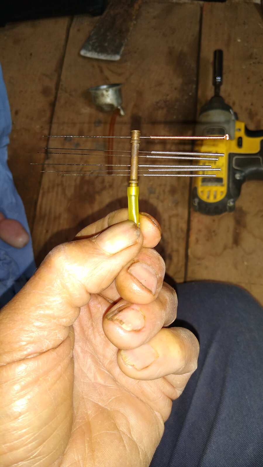

Fuel bowl seemed full, had main jet and emulsion tube out all pass brake cleaner nicely
Are the cross drillings also clean?
It does sound like fuel starvation. Slow tickover will most likely be on a slow running jet, which then transfers to main jet when throttle opened. As it's a honda, if you can't clear it, take it to a honda dealer and get it sorted. It's a great engine and should just run.
