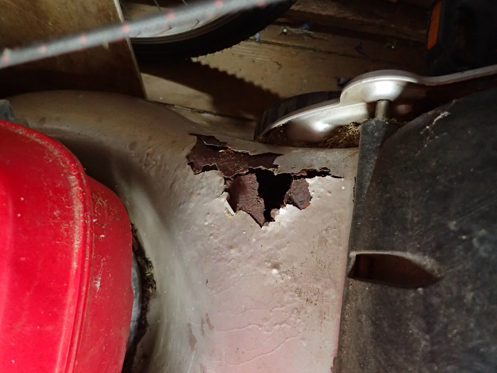

Please see picture attached.
Is there anyway to save this deck ?
Could it be patched ?
If so what would the best materiel to use.

Just cover the hole with gaffer tape or similar ( both sides) and you’ll get another couple of years out of it.....no point in doing more as there will be lots more corrosion there.

Thanks have some silver duct tape will give it a go.
Gave it a scrape off today wounding weather to pop rivet a patch over hole area.

By all means faff around with plating if you want....you'll get a couple more years out of it but the end result will be the same.
If you order a new deck, the colours are blue (old) or silver (recent) and whether it's self propelled or not are the important points.
If its a 21" machine, the bolt on grass deflectors on the deck underside will need replacing too - the 16" and 18" machines don't have them.

What silver paint would you suggest ?
Is it worth putting Kurust on deck first ?
I think I will go ahead and put a patch on the deck hole after cleaning off the rust bubbles.

For paint, Hammerite smooth, brush or spray. Kurust will help existing rust to some degree but whether its worth the cost is up to you! Any rust bubbles are coming from the underside.
Only personally speaking but I'd rather redeck an Izy (if the engine is ok) rather than buy a new B&Q special.
Enjoy the project! Drain out the oil and petrol before turning the thing over.
John
for the deck underside - Waxoyl!
I do minę once a year and whilst there is surface rust the deck is still solid. Pressure wash the underside 2 or 3 times a season. Wet grass will destroy the deck quicker than anything. Wet grass sticks like S1ht to the underside.

Advice should Kurust treat the area then smooth Hammerite under & top of the deck ?
Then pop rivet a pierce of thin alley over the area ?
Should last longer than Duct tape.
I think you'll find the rust is a lot more advanced once you've cleaned off the underside but there's nothing wrong with what you propose.
