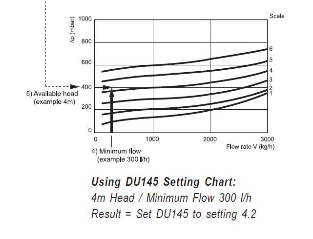

Going back to the ABV again, if the CH is on only (no HW) and even if some TRVs are throttled down or closed is there still no bypassing through the ABV?

No, the pipe exiting the ABV is cold until it activates. The pipework from boiler/pump is about 4.5m of 32mm copper reducing to 28mm into the ABV and zone valves.
With the CH only on can you adjust the ABV very very slowly until it just starts bypassing then shut off the CH.
I can turn the ABV all the way down to 0 and nothing happens. The pipe coming from the ABV stays cold. The pipe going to the ABV is hot. I have left the ABV setting on 2.

I’m investigating an issue where randomly when my CH thermostat stops calling for heat the boiler and pump (it’s a system boiler) turns off and I hear a pipe knocking with a single thud somewhere in the ceiling. This happens whilst the pump is still in overrun and doesn’t happen all the time. My question is, can I manually latch the CH zone valve open without damaging the motor in the valve head. I want to check if it’s the zone valve closing that causes the thud.
I had the same with mine a few years ago. It turned out to be the auto bypass valve opening. Adjusting it cured the problem. Happened every night about 15 minutes after going to bed. I ended up finding it by holding my hand on the ABV and as soon as the heating or hot water reached demand or the system switched off, bang! As it opened.
