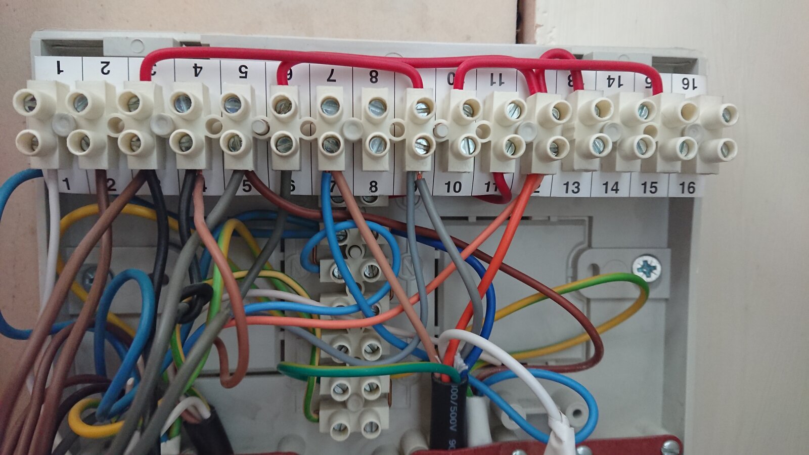

Here's the wiring centre. Can you see anything which looks wrong? Unfortunately the wiring doesn't match the guide on the wiring centre. Possibly because I have a system boiler? I changed the wires one by one from old to the new.
Number 7 has a brown and blue so I'm suspicious of it now.The HW zone valve has the flex coming in under number 10.
Who carried out the wiring? Number 7 states grey, but none are in number 7, also did you purchase the correct actuator? - there appears to be a white wire, usually found in 3 port mid position valves.
Wiring centre all done before I moved in so at least three years ago. Boiler and controls are 15 years old so probably all that old.
The zone valve leaflet said white was rarely used and should be safely isolated so that's what I did. I think it's something to do with pumped CH/ gravity HW.
