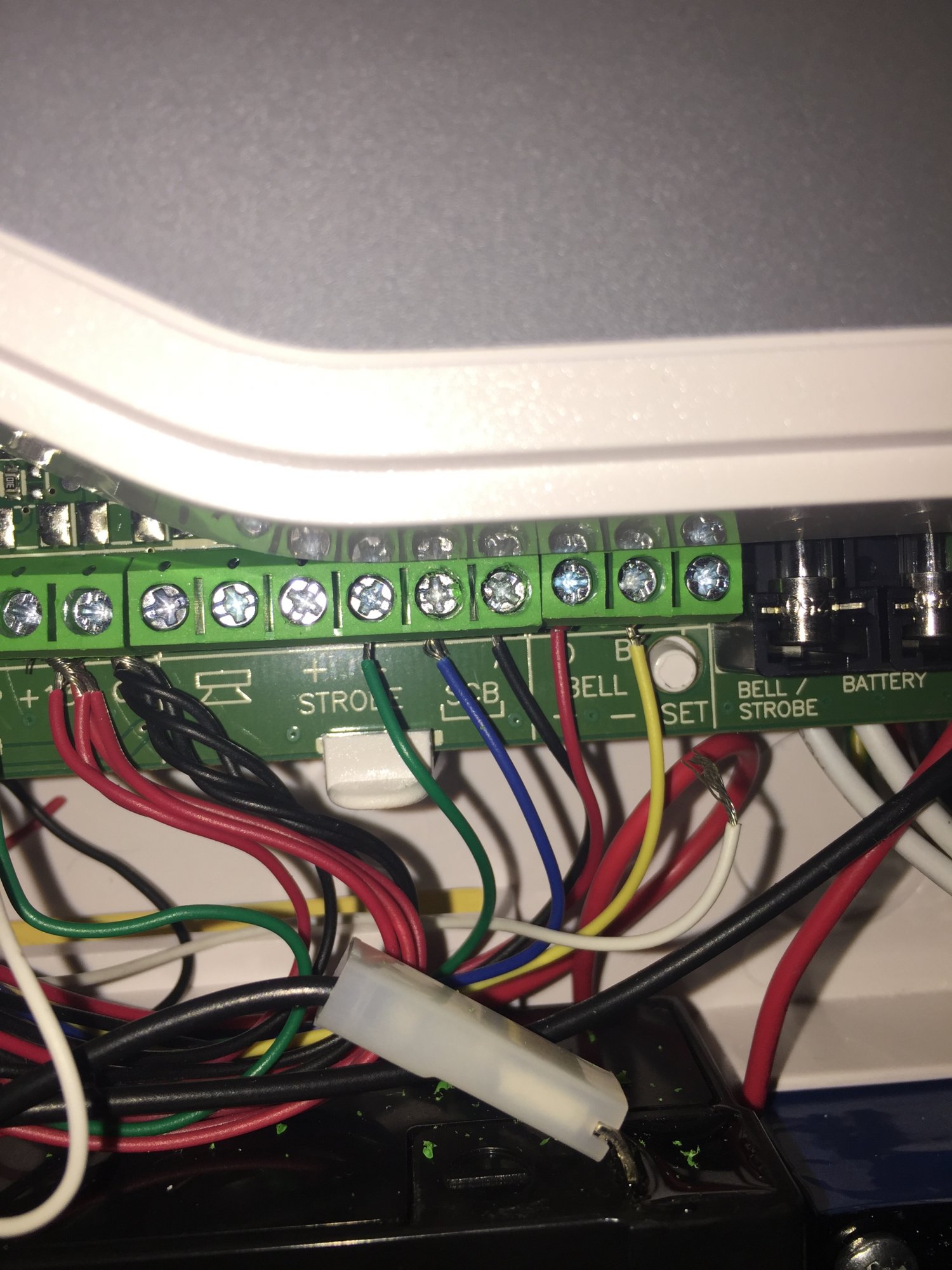

hi hope you guys can help,
Tried replacing my horrible looking bell box today for a phronix delta bell X
Alarm and old bell were working fine before hand but now I'm getting tamper fault lock out
I have wired bell as instructions say for my alarm below left hand side is panel right is new bell box!
D - 12v+
A - 12v-
B- bell
Strobe- - stb
T - tamper
T - linked back to 12v-
Any help would be amazing as no siren or strobes when in engineer mode and I test them

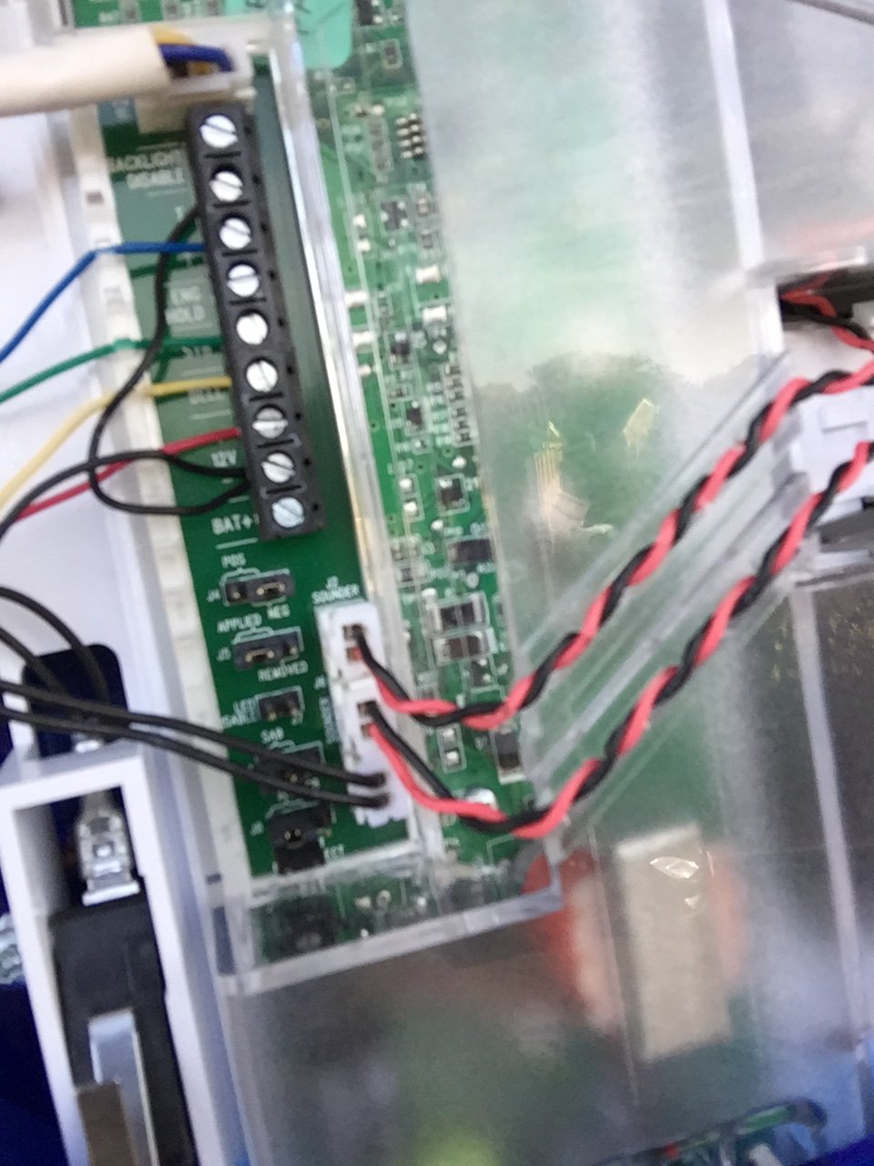

Yes it was mate! Yeah have got a link between them two in the bell! I don't think so what are the jumpers?
Have you adjusted the back tamper ? The screw that pushes the micro switch outwards ? You will have to fit the jumper to enable the internal battery .

Remove blue tamper return wire in panel , set meter to DC , measure between the blue wire and red 12+ , should be 13.8 ish if tamper closed
Hi there just tried this and did not get any reading! So got up ladder had a fiddle and tamper is closed! So I've removed inside of bell and attached to short price of cable from panel! Still no luck whatsoever ever no led nothing power is going to it as tested on meter and the triggers work when tested by dc volts any idea?
