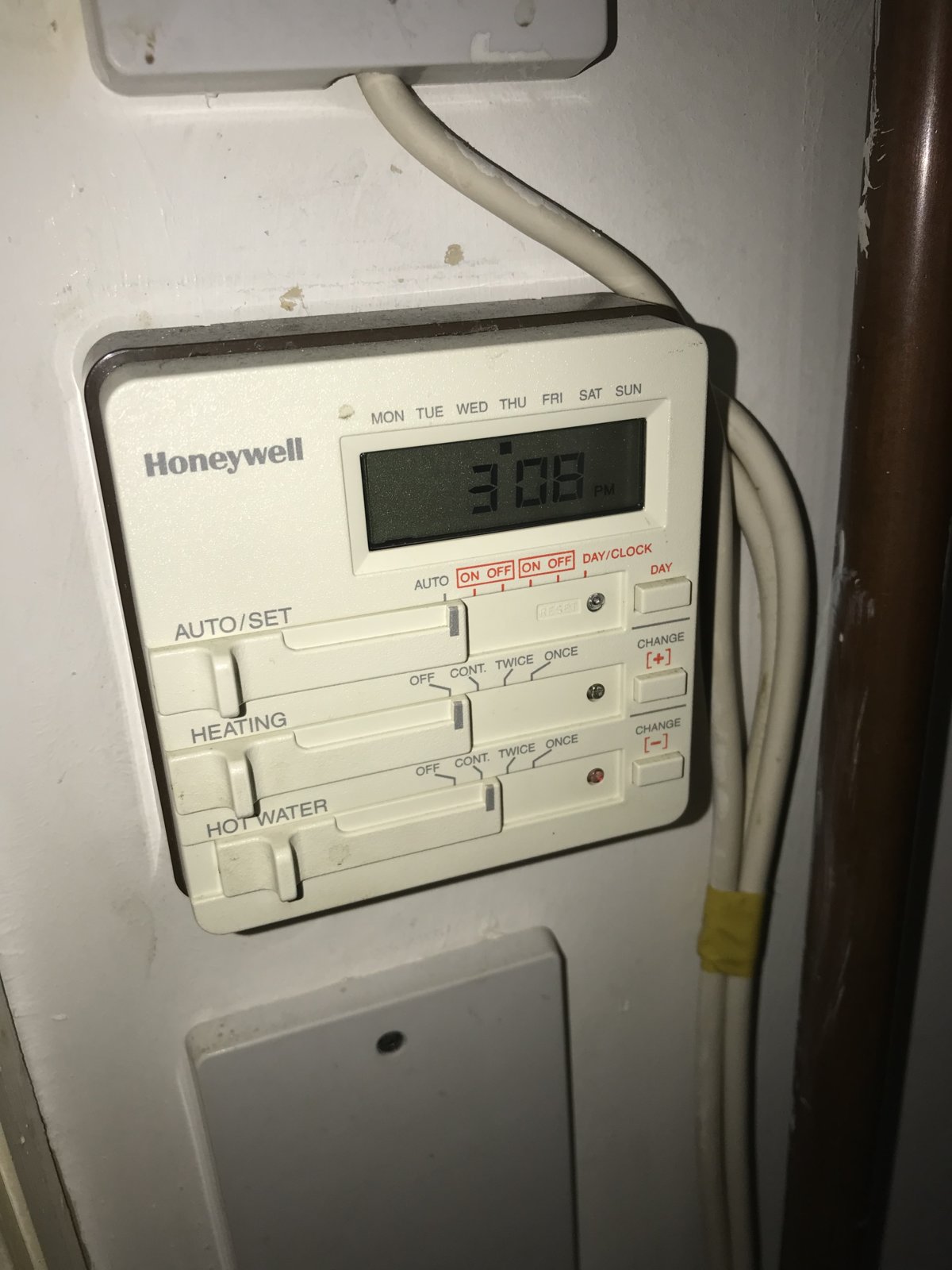

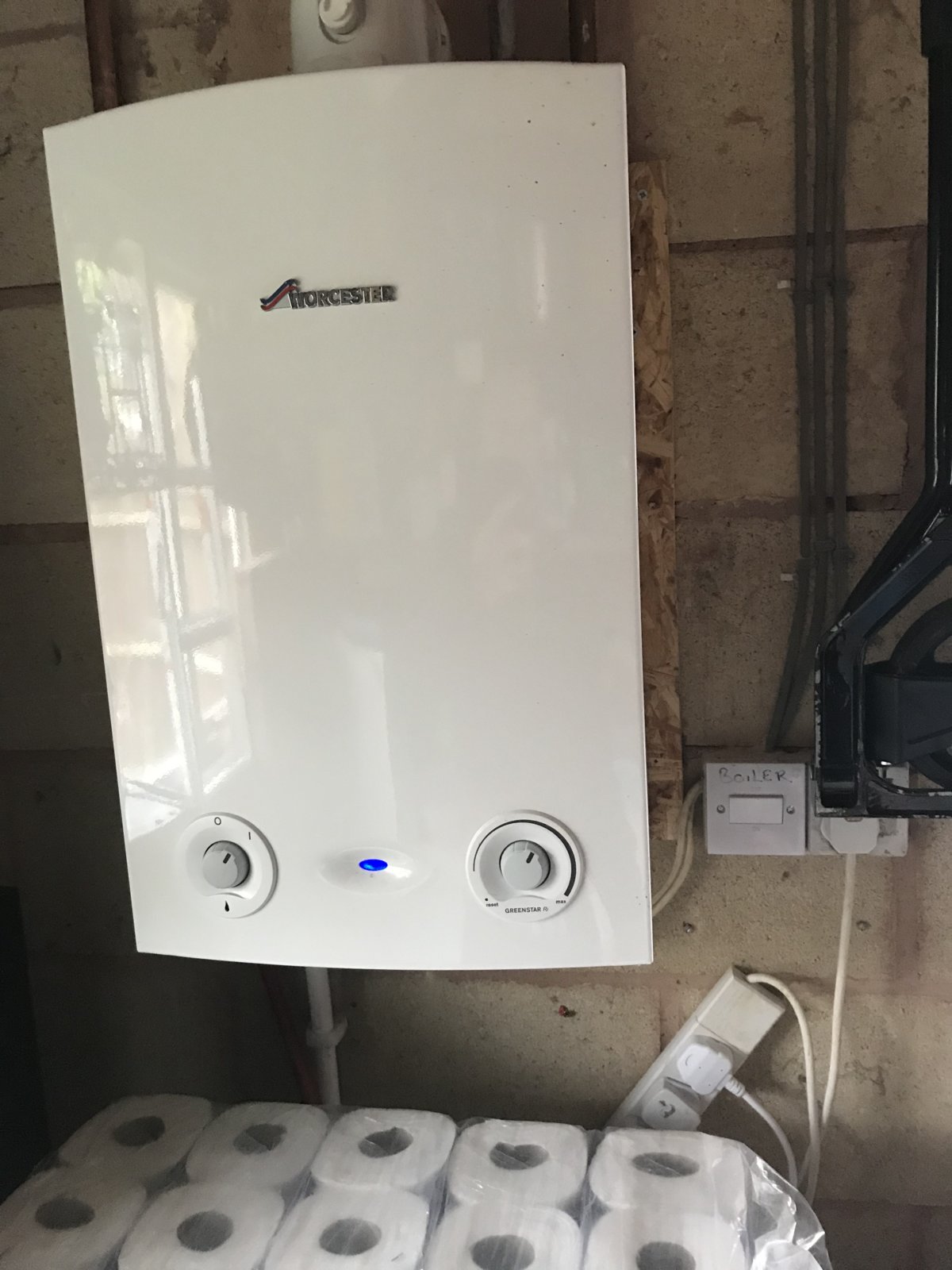

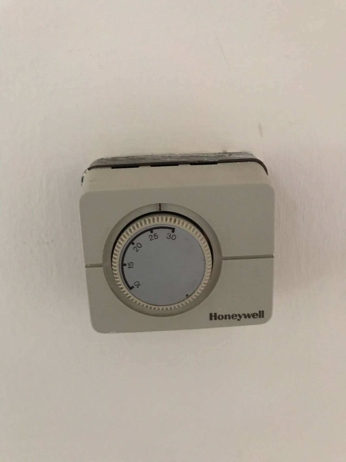

I have installed a few radio thermostats into combi boilers in the past. Simple install, simply a glorified switch. However, my new house appears to have an old heating system approx 20 years old.

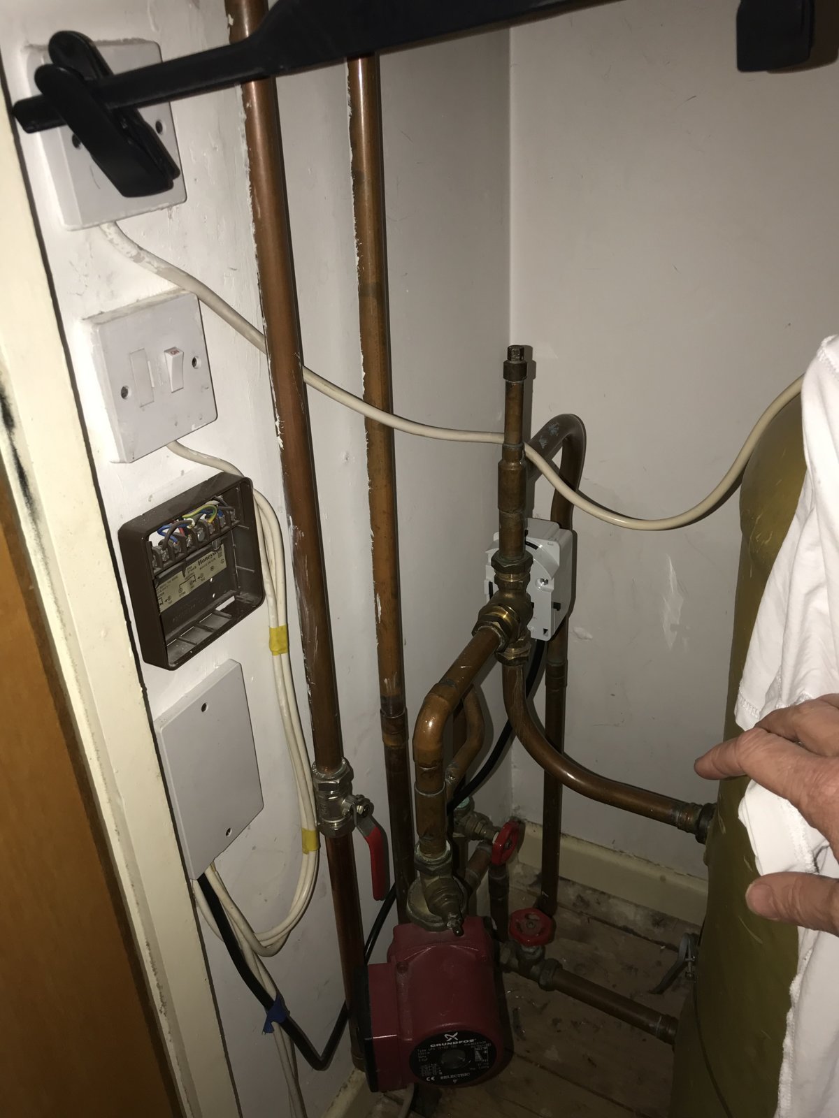

I believe it may be a an F&E? It has a boiler in adjoining garage, copper tank and water tank(s) in the loft. The thermostat is a Honeywell, control box by copper tank and remote thermostat on the wall downstairs. pictures attached.

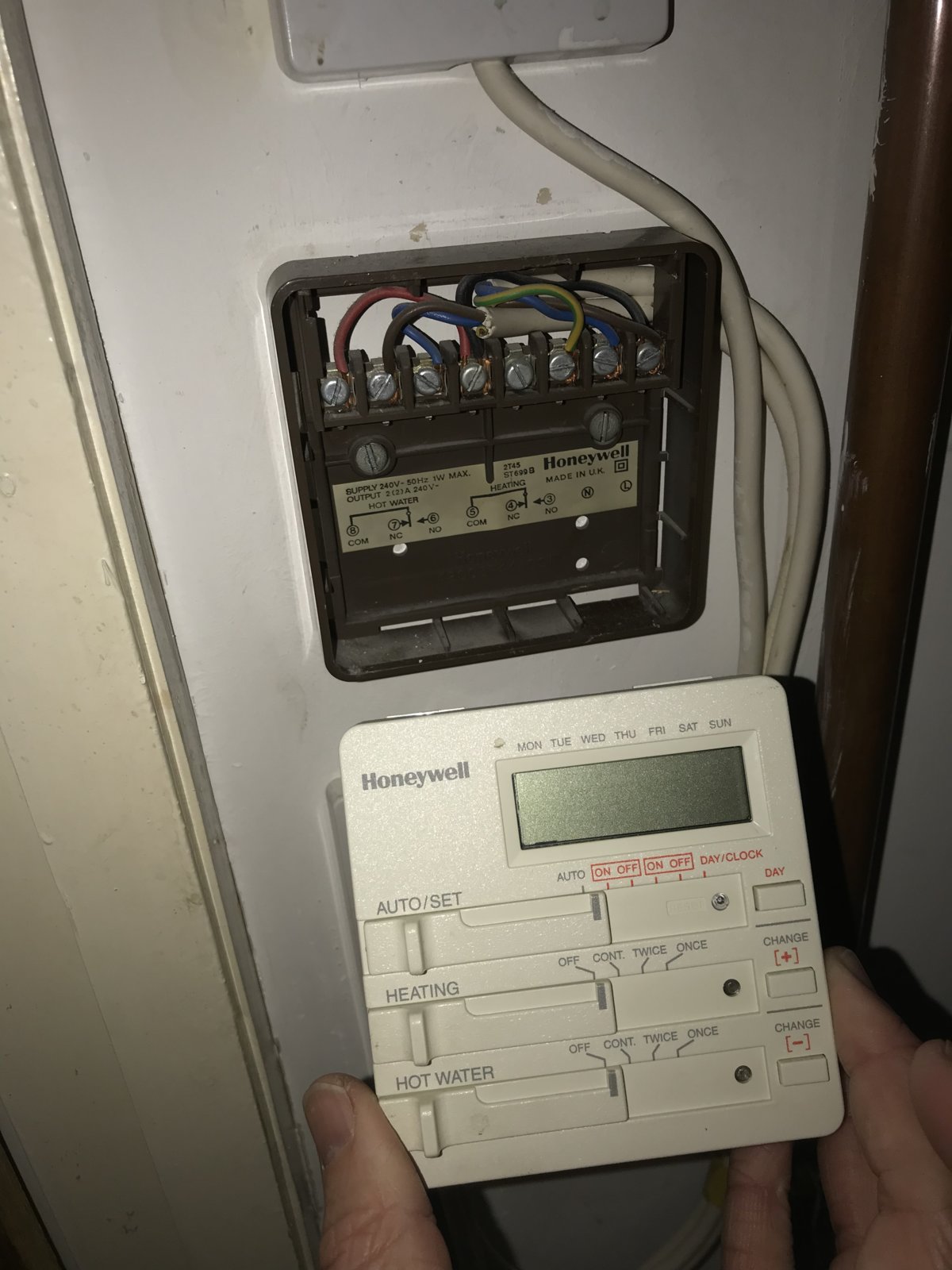

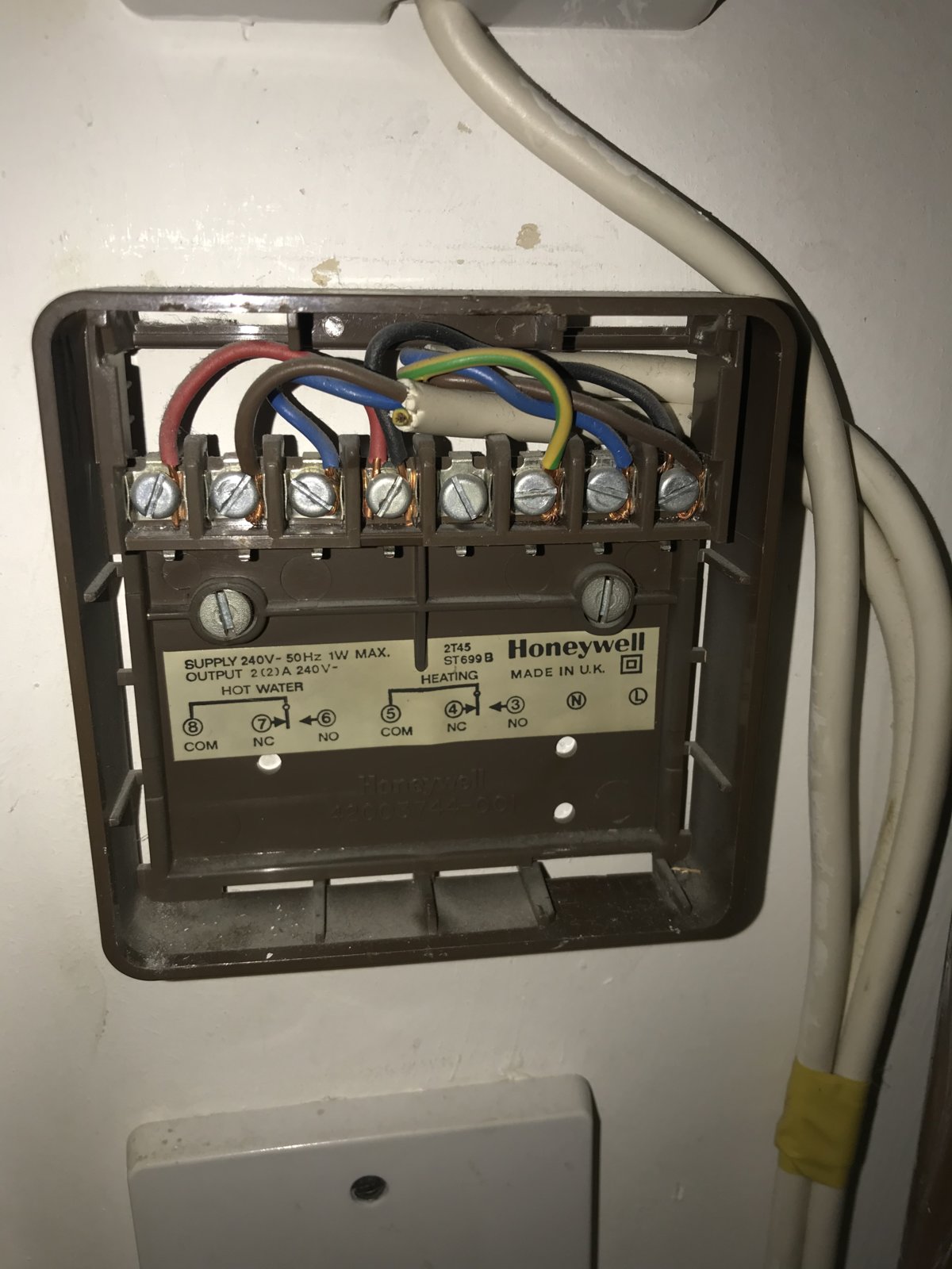

On closer inspection, it appears both have a mains supply and will fry my nest. I am keen to learn and do the install myself. Do I need a transformer for the Nest control box and remote unit? Is the thermostat on the mains rig or lighting rig?
Regards... J

you have an open vent Y plan system there should be a wiring diagram for Yplan with you nest if not google it there are loads open vent (what you call F&E) and sealed system are wired exactly the same so just look for Y plan
Thx Ian - knowing the correct system name is a good start
The Nest receiver is designed to switch 240vac, and is powered from 240vac. Its T1 and T2 connections supply 12vdc to the user display, allowing the old wiring to the old thermostat to be re-used, and avoiding the need for the Nest optional power supply (unless you want to use the optional desk stand).
The biggest bugbear with the Nest IMO is the small size of the terminals on the receiver, getting two 0.5mm2 wires into one terminal is a bit of a challenge!
