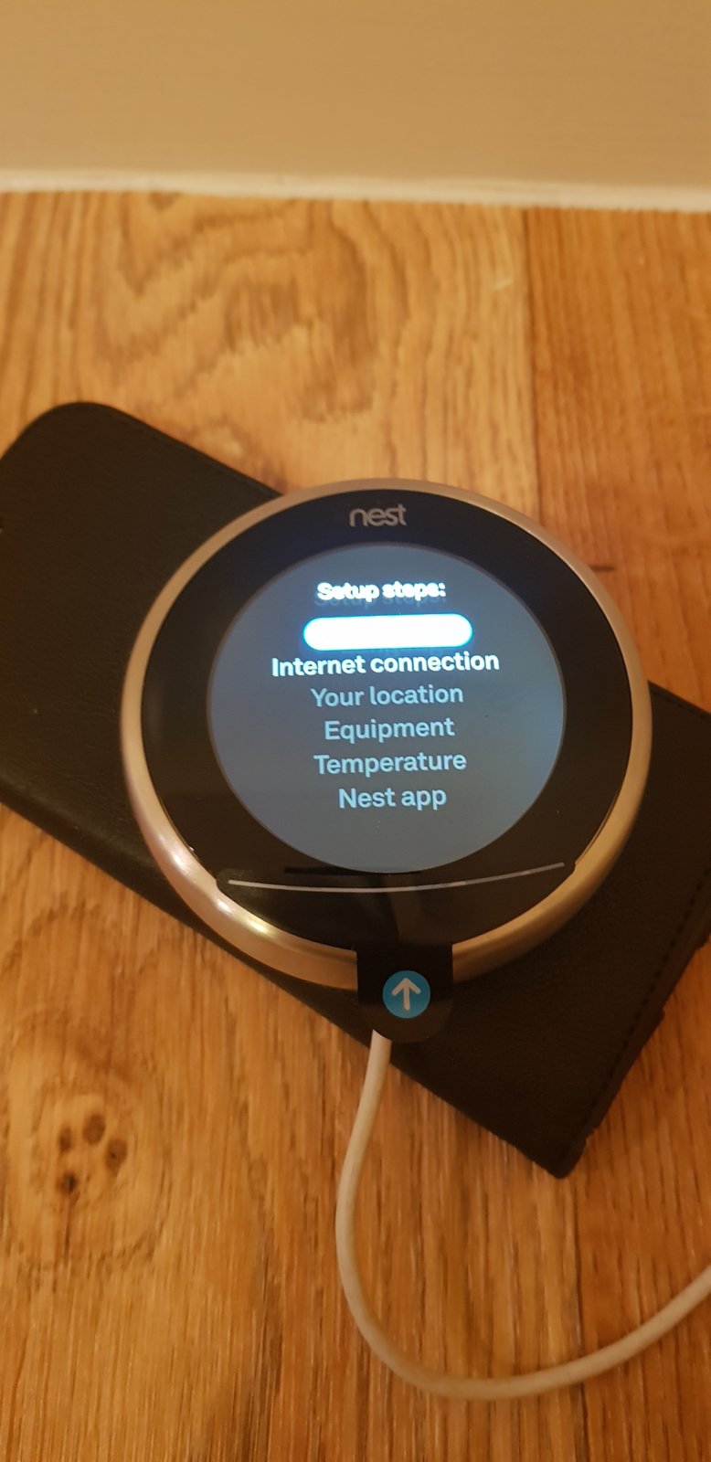

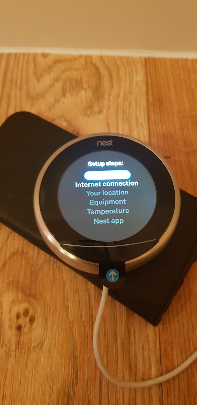

Just to confirm I can plug the USB cable that I would charge my phone with into the back of the nest to test it's working right? That usb cable is connected to the wall socket of a normal uk home....

Yes, plug it into a standard UK phone charger.

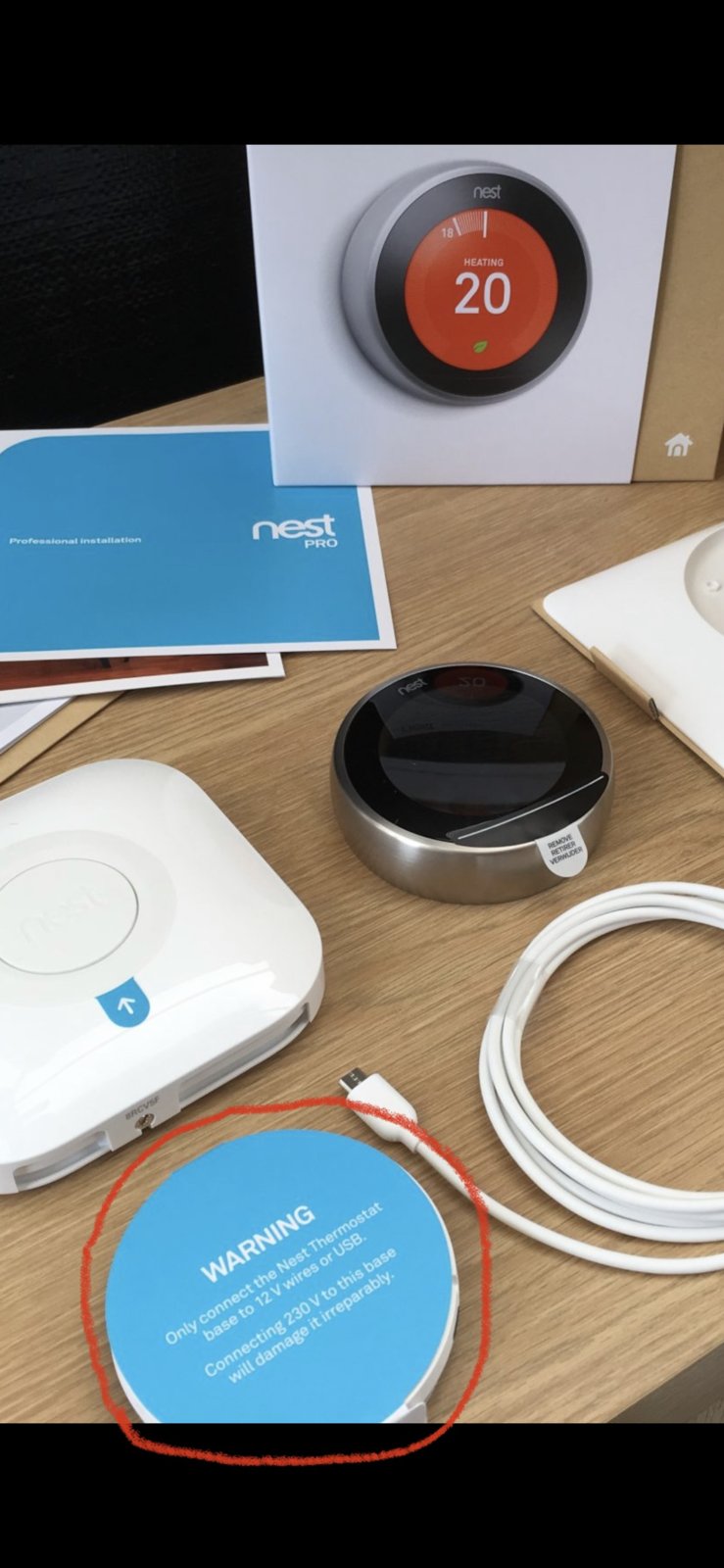

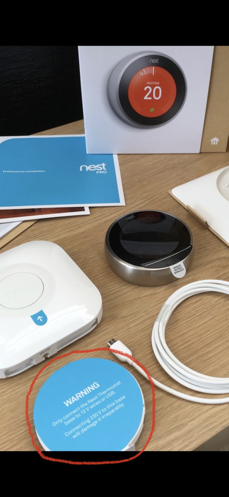

To be fair to Nest, they do a pretty good job of trying to stop exactly the scenario you’ve found yourself in, see attached - I know when I installed it, it’s the first thing I saw.

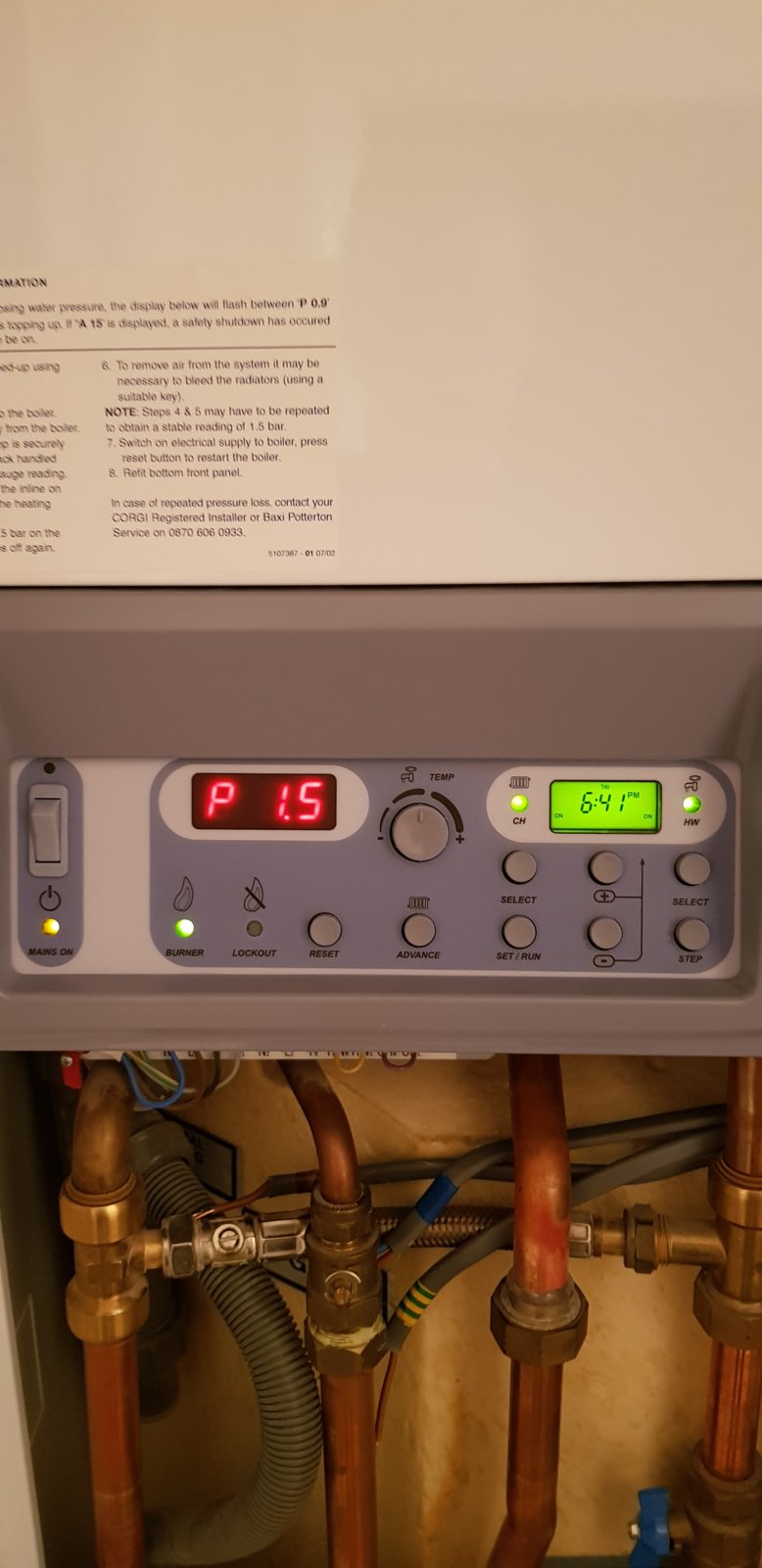

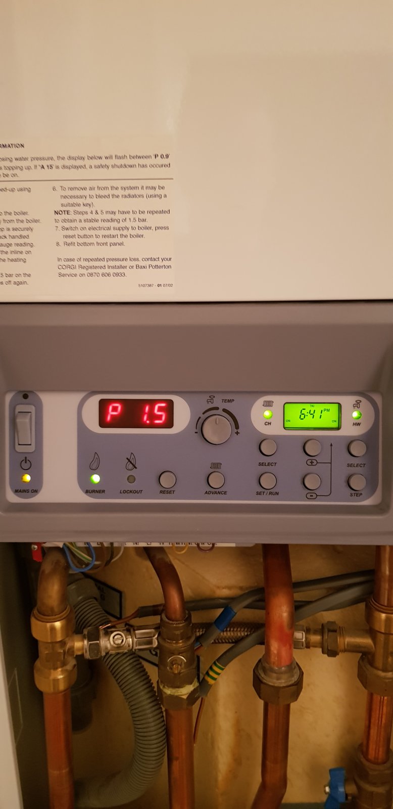

A bit of good news...
I didn't blow the nest
Oh yea baby, over the moon :)

I never got an electrician in. I have read the manual many times and looked at these pics here and have wired the heat sink up to the boiler. That worked. I then connected the thermostat to a USB charger and it all works.
