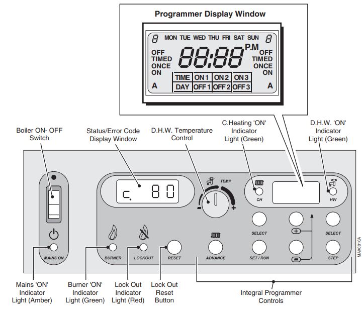

So assuming that your Potterton HE boiler has built in 'time control' as below,
then in a nutshell you are installing a device to provide time and temperature control, which you already have.

Hello guys,
I have just had the 2 fuses tested and 1 has blown and 1 hasn't. I have swapped the fuses over and still no power to the board other than the amber glow.
I am going to order some of amazon but I'm not 100% sure which ones to order. I'm searching for 3.15amp slow blow fuses. What I get is lots of glass versions and a few ceramic ones. Which ones shall I get? One of the ceramic ones says it's for a car stereo and the other one has (time delay) after its description. I dunno what that means.
The fuses that are in the pcb look exactly like the ceramic ones on amazon
Take one to an electrical merchants tomorrow, or a heating spares merchants. Either that or buy the ones I sent you a link to, which are definitely correct...
Oh yea I saw. Ok I ordered 4, bloody expensive but if it works then great. They will come tomorrow. I will keep you updated.
If they arrive tomorrow, having ordered at this time of night, I'll eat my hat. HSP close at 4 so they won't be dispatched until tomorrow morning. Expect them on Wednesday.
That's fine. Do you think this will sort the issue and I will have a boiler back. My thinking is that if no fuse had blown then power would of got to the pcb and destroyed it but because a fuse had blown then it would of protected it...right?
I wouldn't hold out much hope. You connected a device designed for 12v DC to a 230V AC supply, and if that's what caused the fuse to blow then the fault travelled through all the circuitry between the thermostat connection and the fuse. I think you'll have ended up joining Live and Neutral together, effectively, thereby sending voltage back down the Neutral wire. If it's just a fuse then you can congratulate yourself on having got away with it (although I suspect you'll still need to buy a new Nest).
