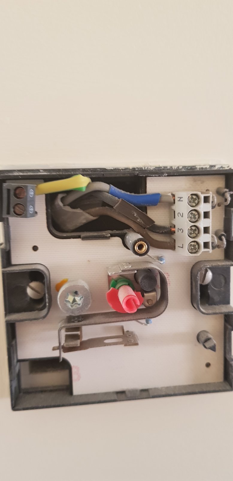

This is the cables connected to the old Drayton Combi-Stat controller. As said before I do believe I connected the Neural and live to the Nest Controller. After I powered the system on via the main switch box nothing has worked from then. No Nest, No boiler.

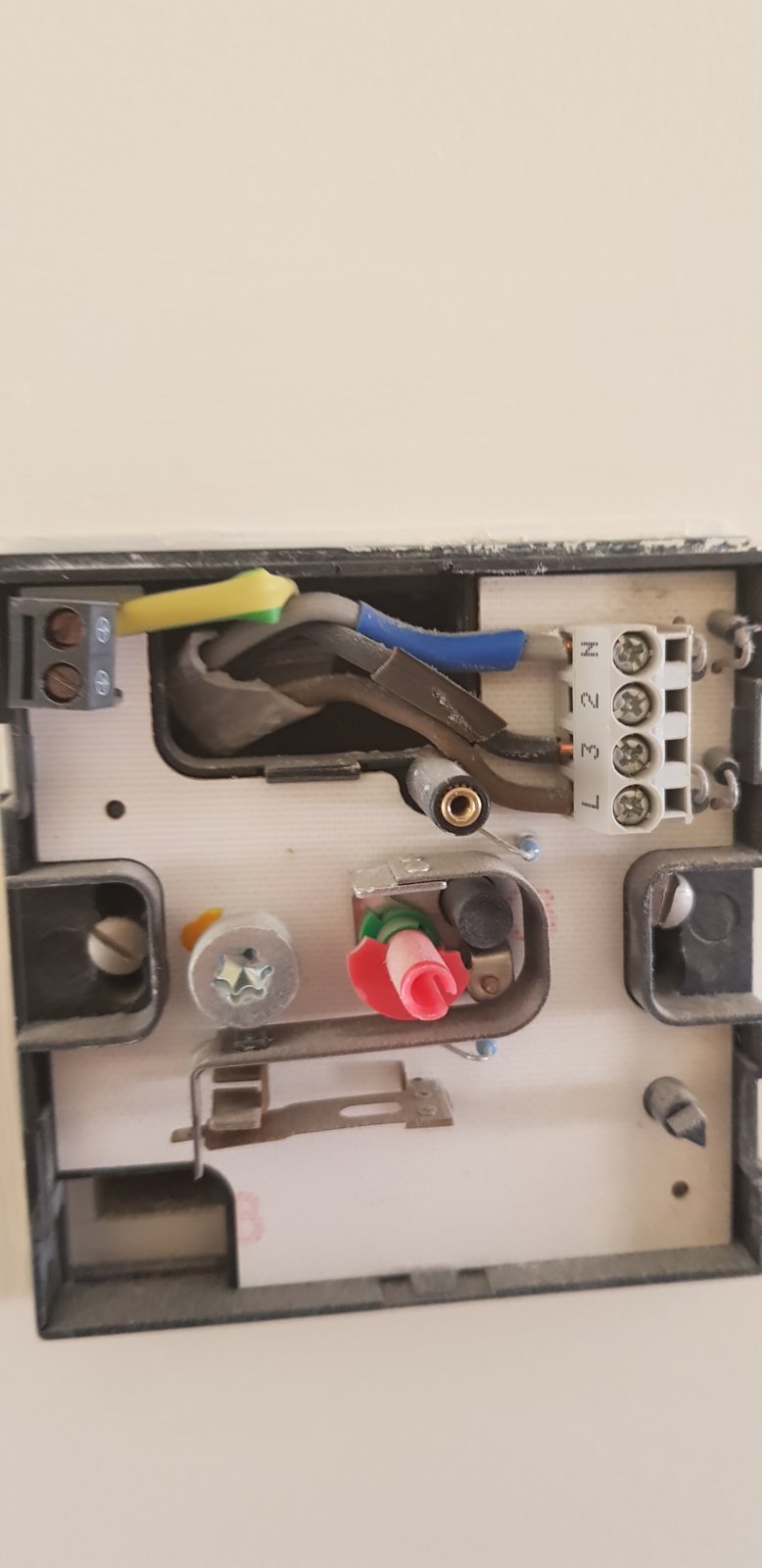

Can you post photos of what you've got now, wiring at both ends?
Ok, from your description in the other thread you've started (it would be simpler to keep everything to one discussion) it sounds like you've connected Live & Neutral directly to your Nest without installing the Heat Link. If that's the case then at the very least you'll have killed your Nest as fitting the Heat Link is essential. Nest is designed to run on 12v DC power, not 230v AC, and the Heat Link provides this conversion. You may also have killed your boiler's PCB. A replacement one of those is just under £400. Better hope it's just a fuse on that.....

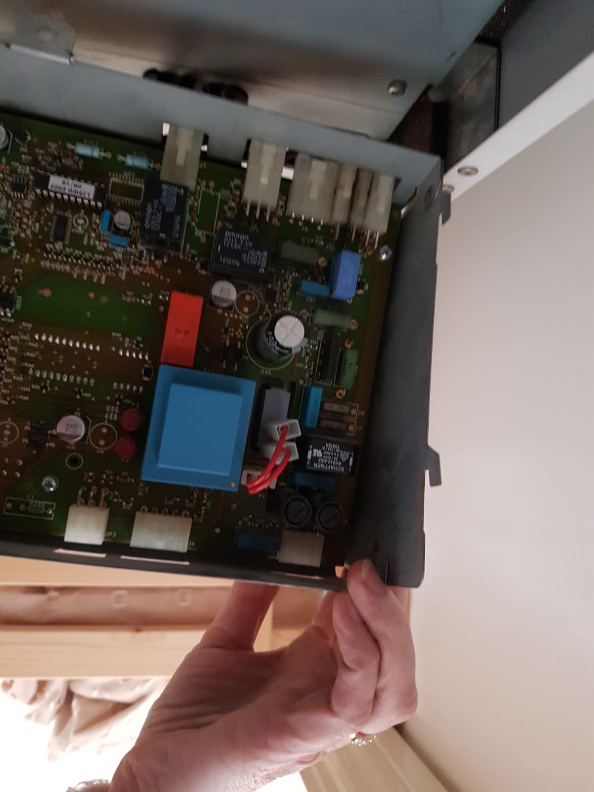

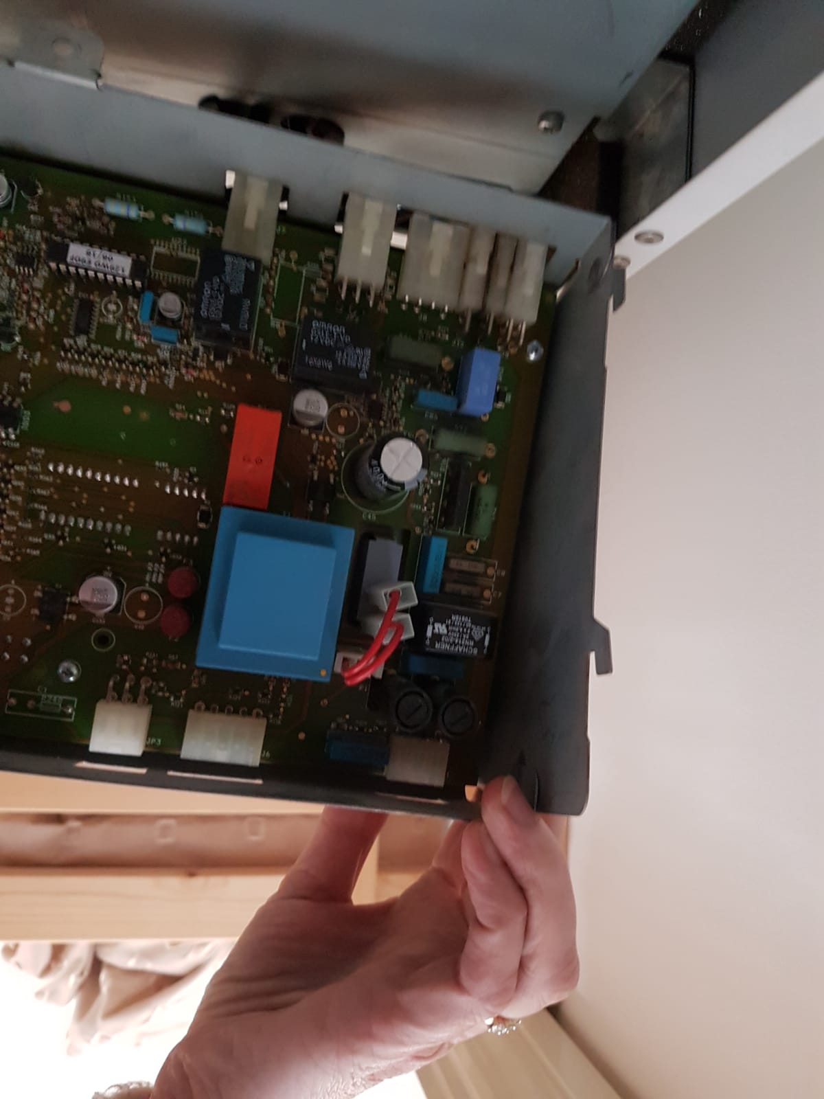

I was chatting to a gas engineer over the phone yesterday and he suggested it could be the internal fuse in the PCB. I looked for it as the instruction manual indicated where it was but was unable to locate said fuse.
I took a picture of the pcb (on my partners phone so I dont have it) to show him and he also could not locate an internal fuse suggesting there might not be one.
Any ideas? Could it be hidden in one of the boxes on the pcb? A website mentions it could be a ceramic fuse and not your usual glass one.
Yes, the fuse is internal on the PCB just to the right of the power switch. It's a 3.15A Slow Blow type.

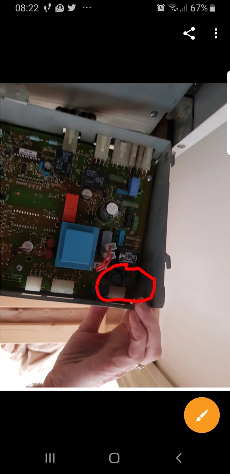

Can you show me in this picture I took last night....

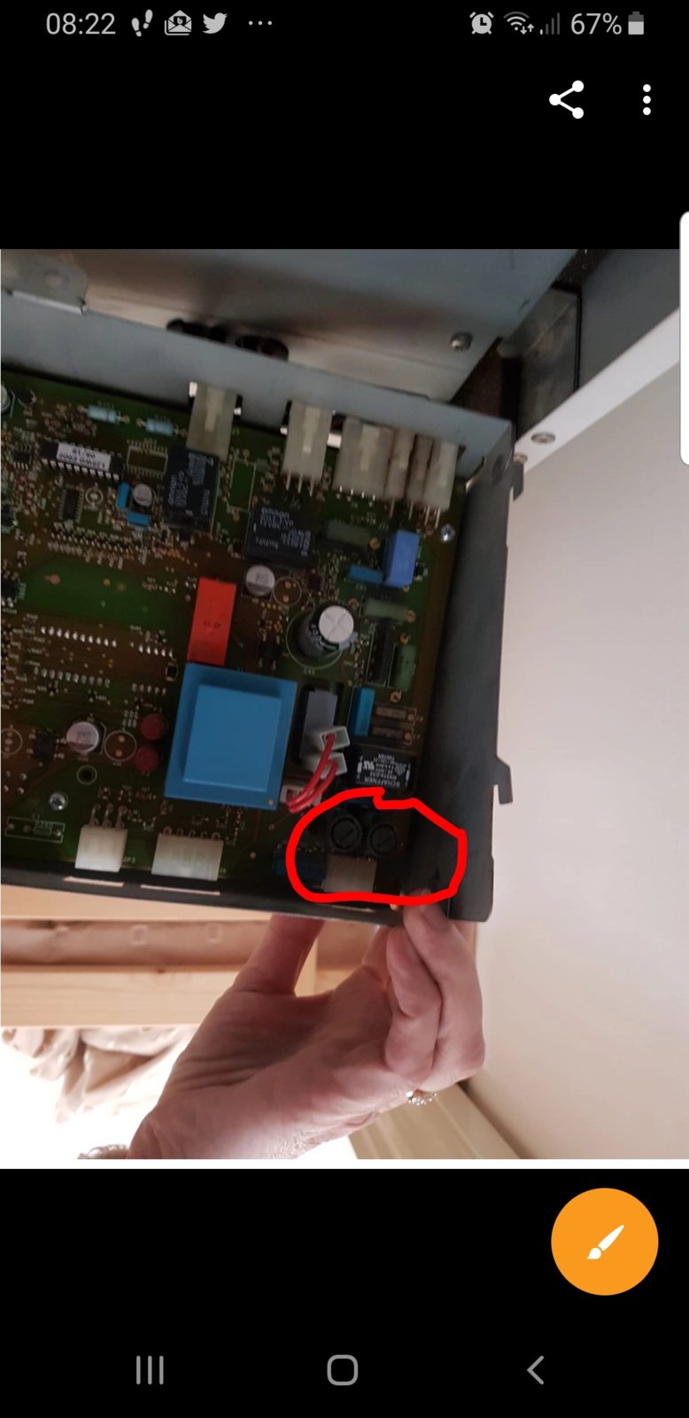

Sorry, it was upside down so I thought I was looking at the right hand side, and the fuses are on the left
Ah ok as I thought.....
Is it possible just to pull them out and slot in replacements or are they soldered in tight? If they are removable by an idiot like me what do I look for on internet to buy replacements?
