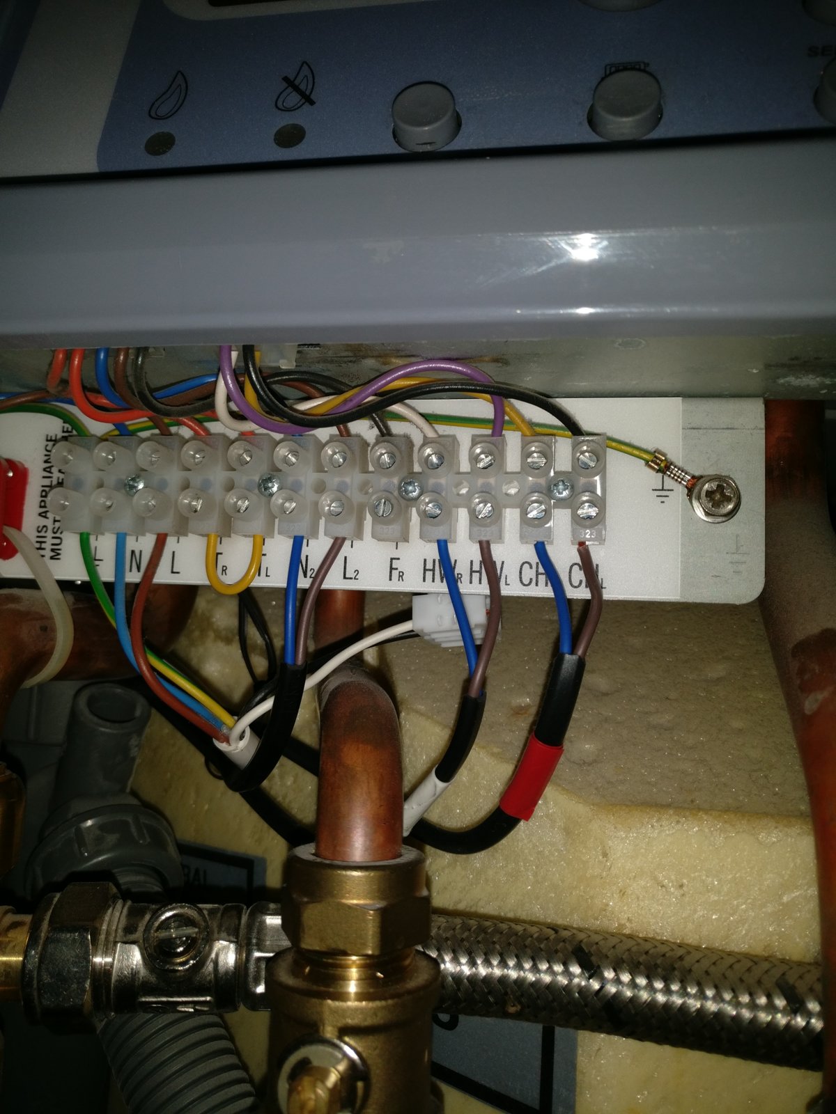

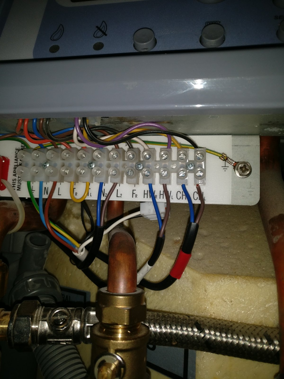

the only issue is not knowing how to connect the nest thermostat to the old wiring. As Muggles said above I connect the brown and brown sleeved wires at the wall to the header unit and then I do believe i have to remove 2 wires from the boiler and extend them and connect them to the T1 and T2 ports in the heat sink. please can you let me know which 2 wires from the picture they are? I don't have a meter and the £100 call out fee just to get the electrician to point to the wires for me to adjust. (this image was taken from an earlier post that i copied and works as i have written above).

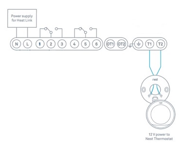

I'm not sure you understand the concept. The Nest Thermostat does not connect to the boiler. The Nest thermostat communicates wirelessly with the Heat link, but it needs 12v to power it. There are two ways of doing this, you can get the 12v power from a plug in power supply which is what you have said you have done already.
Or, alternatively you can get the 12v power from the Heat link.
To do this it requires a cable between the Heat link and Nest thermostat such that:
T1 at the Nest thermostat is connected to T1 at the Heat link, and
T2 at the Nest thermostat is connected to T2 at the Heat link.
The Nest thermostat is not connected to the boiler.

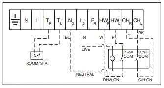

In that case the thermostat can go to boiler, as per the diagram below.
Except in your case, you don't have a 'room stat' connected to the room stat terminals, and the terminals Tr and Tl are bridged with a wire link.

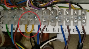

That picture that i posted above was taken after i wired the Heat Link to the boiler. I removed 2 wires from the room stat (Tr and Tl) and secured them away. I then put that link in between them as i was copying a pic from earlier in the post......
Now are those 2 cables that i removed from Tr and Tl the cables im looking for? If so how do i test them before plugging them into the heat link and the Nest header Unit???
YES! The wires would have been in those terminals

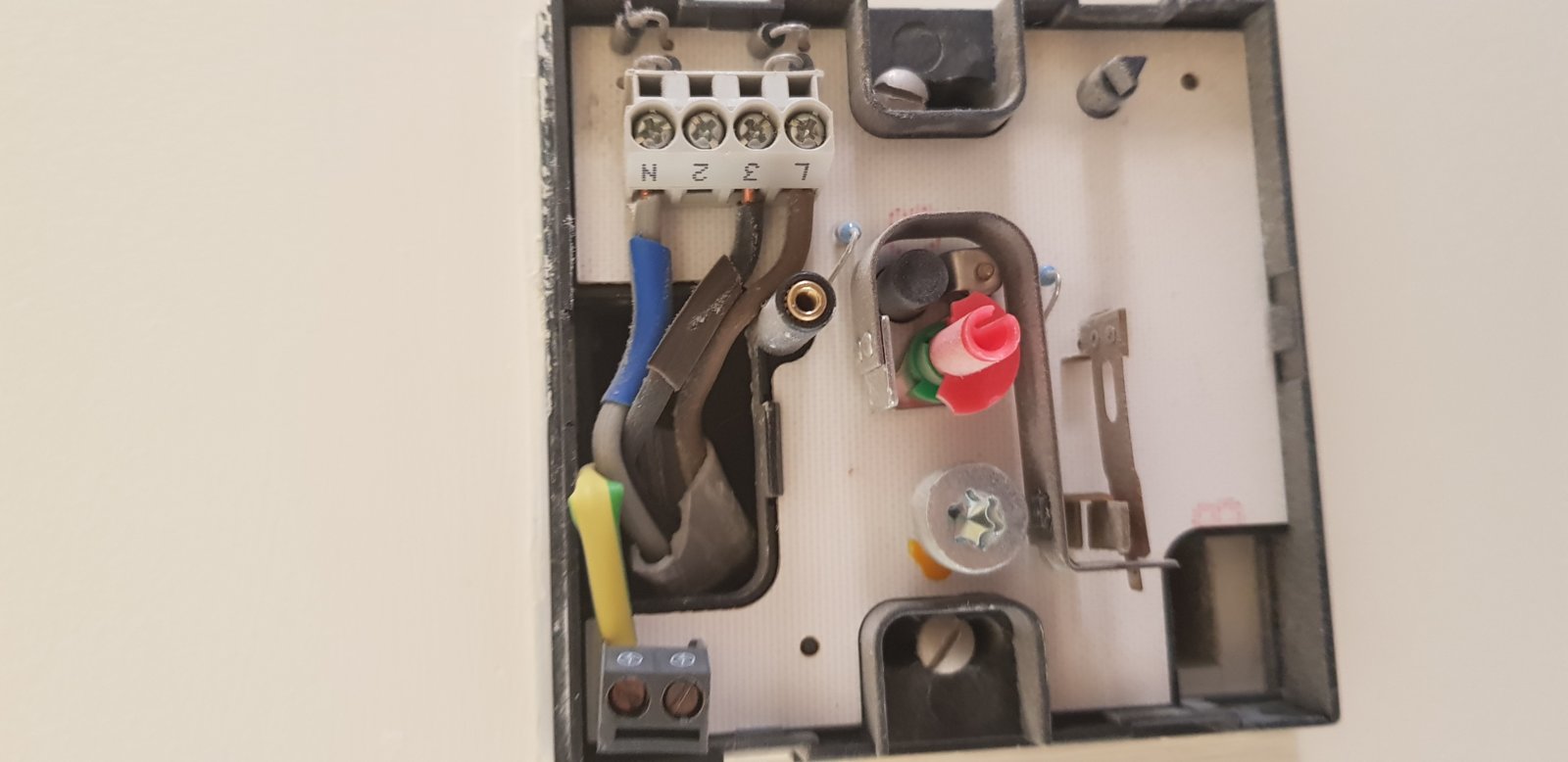

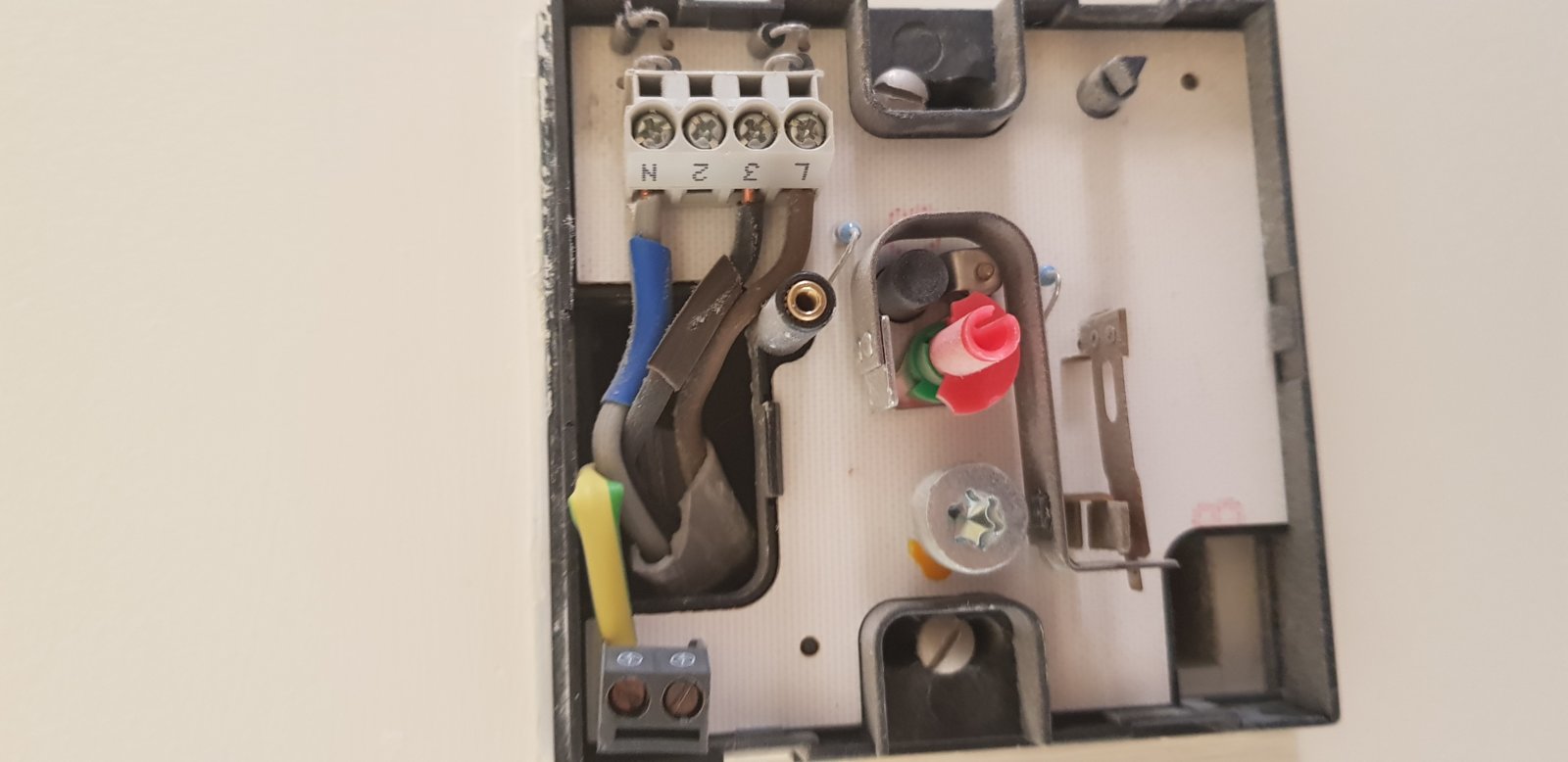

Also looking at this pic of my Drayton header unit which 2 wires do i connect?
On the boiler i disconnected a grey and black wire, so on the drayton i will assume i connect the N and the 3 wire as they are the same colour.
apologies about all these questions, i had a big scare the first time i tried to connect this all up about blowing the boiler and the Nest, I got lucky and only blew a fuse. This time im getting somewhere, just want to finish the job correctly.
The pictures attached shows the boiler end before i connected the Heat Sink. You can just about see the cables at the bottom connected to the Tr and Tl terminals. The other picture is of the Drayton still connected but not working (as i found out later that was another victim of my tomfoolery the very first time i tried).

Regarding the old room thermostat.
L is Live
N is Neutral
3 is switched live
This thermostat has an accelerator heater, hence the neutral connection. All of the wires in the cable should be disconnected at both ends before using it to connect to T1 & T2
OK, to me that sort of doesnt make sense, if the wires i removed from the boiler Tr/Tl terminals are the same wires connected to the drayton on the wall (grey and black) that would mean im connecting a Neutral and Switched Live to the Nest????
OK when i look at that pic of the boiler all 4 of those wires match whats in the drayton.
Drayton Wall end..............................Boiler End
Earth = Yellow/Green
L = Brown.......................................L = Brown
3 = Black........................................Tr = Black
N = Grey.........................................Tl = Grey
So im assuming that i:
Disconnect the black from the boiler and put it into T1 on Heat Sink
Disconnect the Brown from the boiler and put it into T1 on Heat Sink
Connect Black from Drayton into T1 on Nest Header
Connect Brown from Drayton into T2 on Nest Header
No.
One end of those wires should be connected to the Nest Heat Link T1 & T2 terminals, and nothing else.
The other end should bre connected to the round Nest base plate T1 & T2 terminals, and nothing else.
Thus the Heat Link is connected to the Nest and provides power for it.
