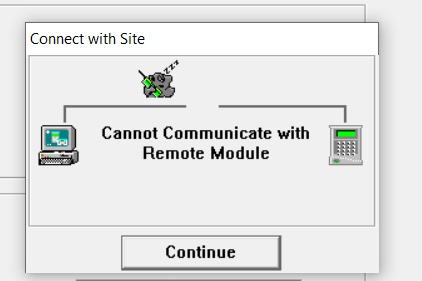

Dear All I hope find solution for my issue at galaxy dimension panel

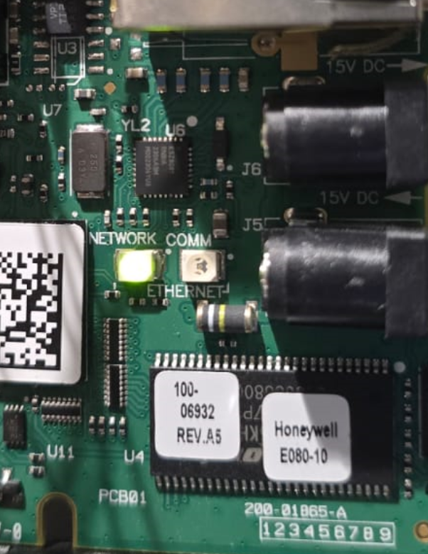

I trying to communicate to panel Galaxy dimension 48 VR.7.4 throw Ethernet Module E080-10 VR.5 . it is already IP is pinging but I can’t connected throw RSS software , pls see attached pic .
Only I can open software throw RS232.
Appreciate your support ASAP .

You need to ensure that the following Ethernet settings are selected:
1. remote access 56.4.3.1 to 4 (Any time) which is default
2. mode 56.4.3.2 to 1 ( Direct access ) which is not default
You responded quickly and answered correctly, thanks
yes i miss mode 56.4.3.2 to 1 thanks

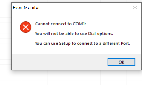

2-Event Monitor when i connect i show this message how i can change this port
