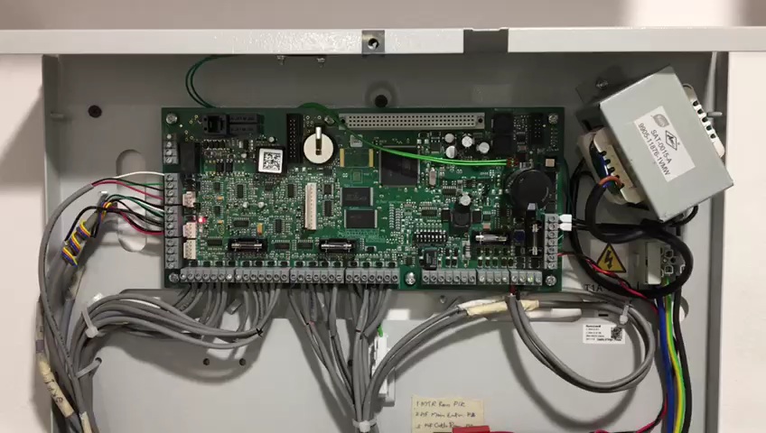

    I AM HAVING Galaxy® Dimension Control Panel 3-264 WHERE AROUND 70 ZONES ARE CONNECTED.
    1 KEYPAD CONNECTED IS CP050-00-01.
    I WANTED TO CONNECT THE CONTROL PANEL WITH WINPAK-GX, AND FOR THAT I AM TRYING TO CONNECT THE ETHERNET MODULE E080-10.
    I HAVE BEEN TRYING MANY WAYS , BUT EVERYTHING SEEMS TO BE A FAILURE.

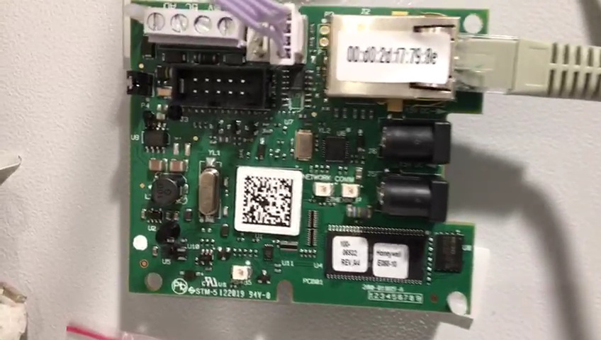

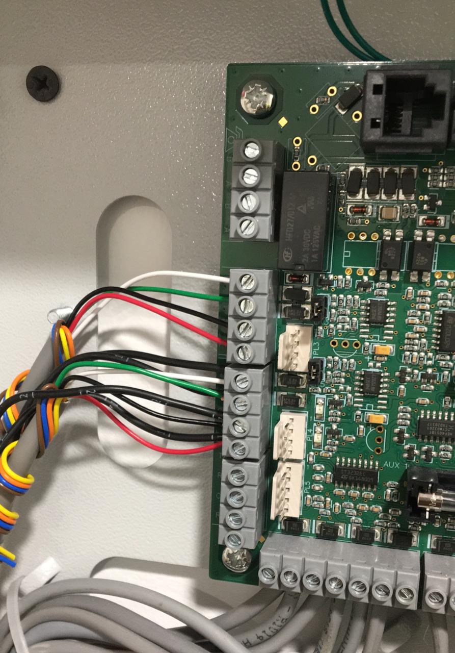

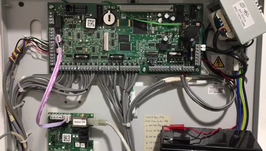

    Earlier the Ethernet module(E080-10) was connected to the Galaxy® Dimension Control Panel 3-264 using the port 12v,0v,BC,AD(in E080-10).The LED in the module was blinking but even after configuration, it was not able to PING. Later, I connected the E080-10 to the Control Panel using Primary bus cable. But it seems to be no power in the module, LED from the controller is blinking, but the E080-10 LED is not blinking, means the module is not working. Is there anything which i missed??
    If anyone could help me in this it would be so great. Coz its been a while I am stuck with this :( Already crossed the deadline.
    Just to get a reply from anyone I tried to post the same question in many threads. Coz the situation is lil worse.
    Attaching images.

    That bus cable does not look like the correct cable. It looks like it's going from pin 1 to pin 4. It should be going from pin 1 to pin 1. Let's hope you haven't blown the RS485 transceiver chip by applying 12v across it.

    Also, when wired directly, are you sure you have the E080 module wired into the primary bus ? I ask, as you do not have any wires going into A1 B1 screw terminals. The Ethernet module will only work on the first bus.
    Scratch that. I see you have them in the other picture. I think you should go back to hard wired as you don't have the cable. Then:

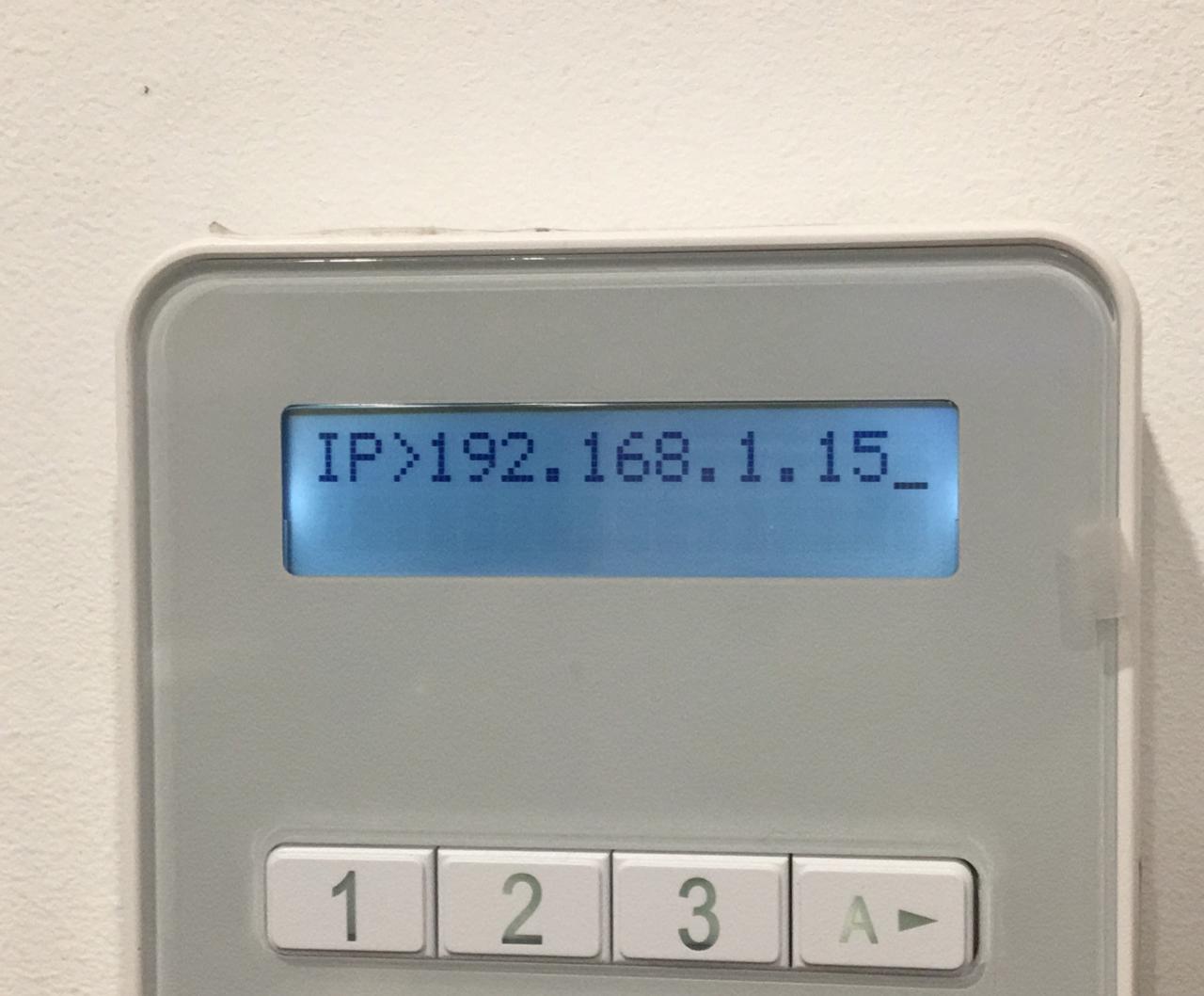

    Settings done from keypad side:
    ip address- 192.168.1.15
    subnet 255.255.255.0
    gateway-192.168.1.1
    Settings done for my laptop:
    ip address- 192.168.1.145
    gateway 192.168.1.1

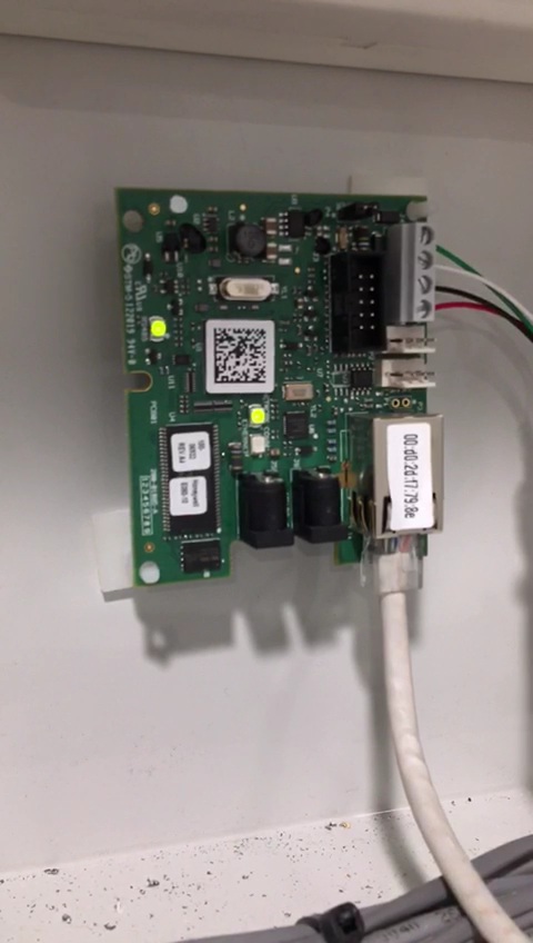

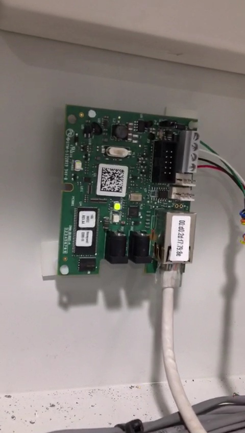

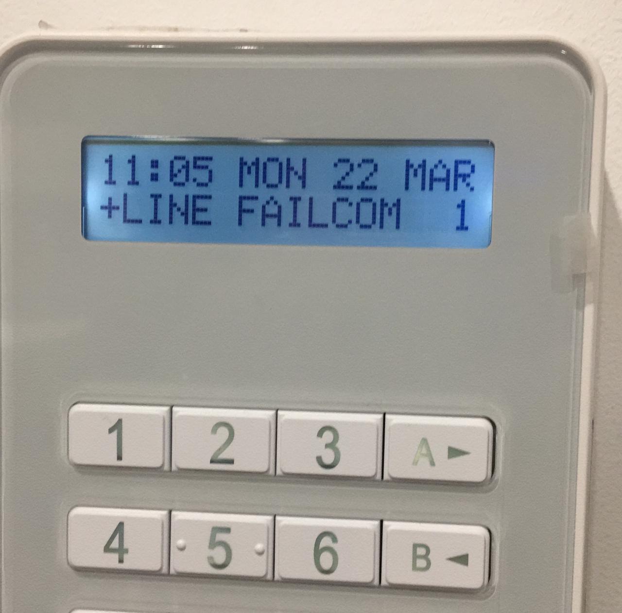

    One thing i noticed is without connecting the Ethernet module, the keypad shows LINE FAILCOM 4.
    Once ethernet module is connected, FAILCOM4 vanishes.
    So i think its communicating, but something is missing. Even the LED's in the ethernet module is blinking.
    RS485 LED IS BLINKING EVERY 2 SECONDS.
    NETWORK LED IS STABLE.
    COMM LED BLINKS EVERY SAY 20 SEC.
    IMG-20210322-WA0033.jpg IMG-20210322-WA0030.jpg VideoCapture_20210322-115807.jpg VideoCapture_20210322-115812.jpg
    Attaching images for your reference.

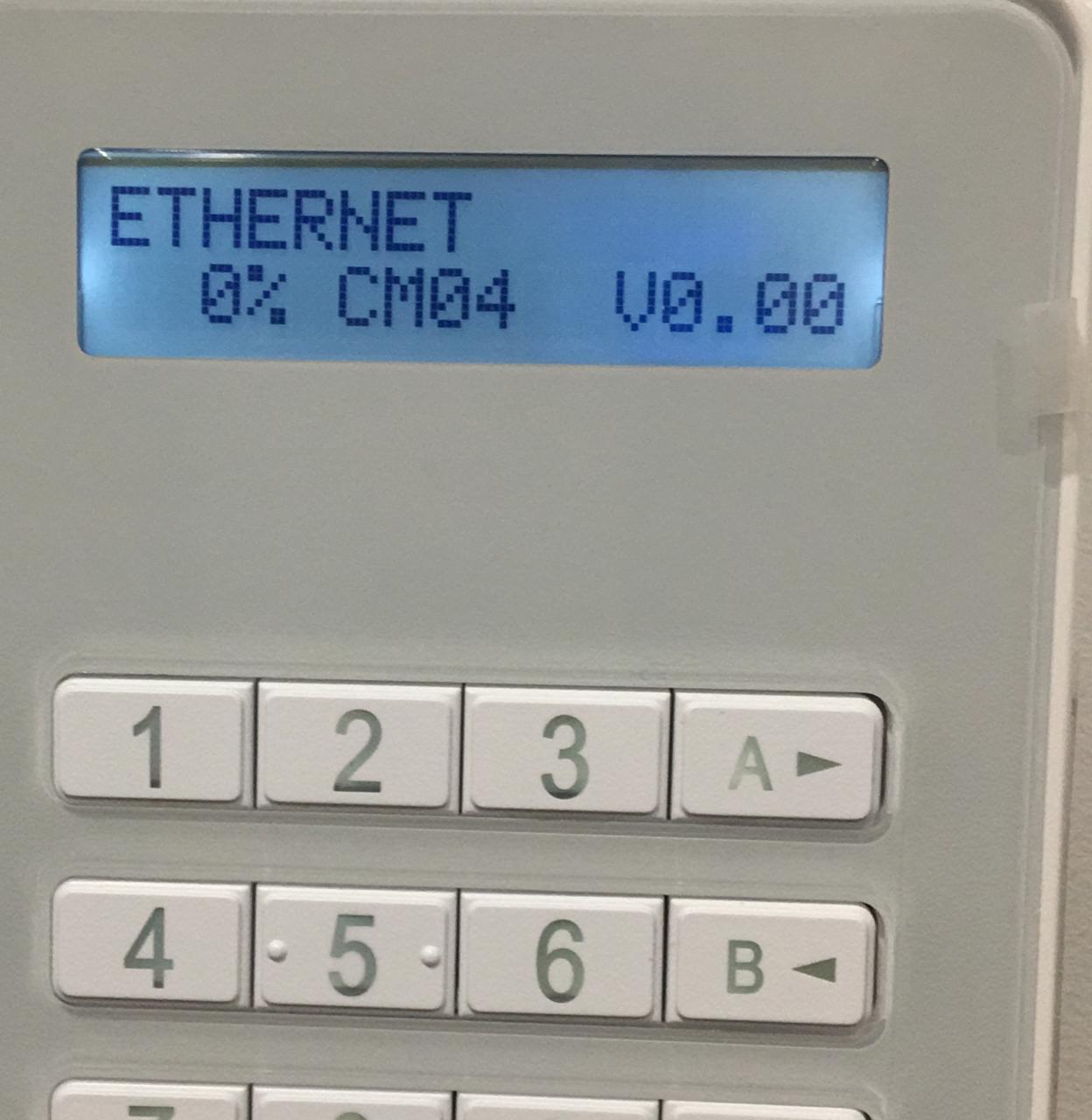

    And what does diagnostics menu 61 show for the com 4 module ?
  7. MBoy
    MBoy
    Joined:
    21 Mar 2021
    Messages:
    13
    Thanks Received:
    Country:
    United Arab Emirates
    It is showing the below.

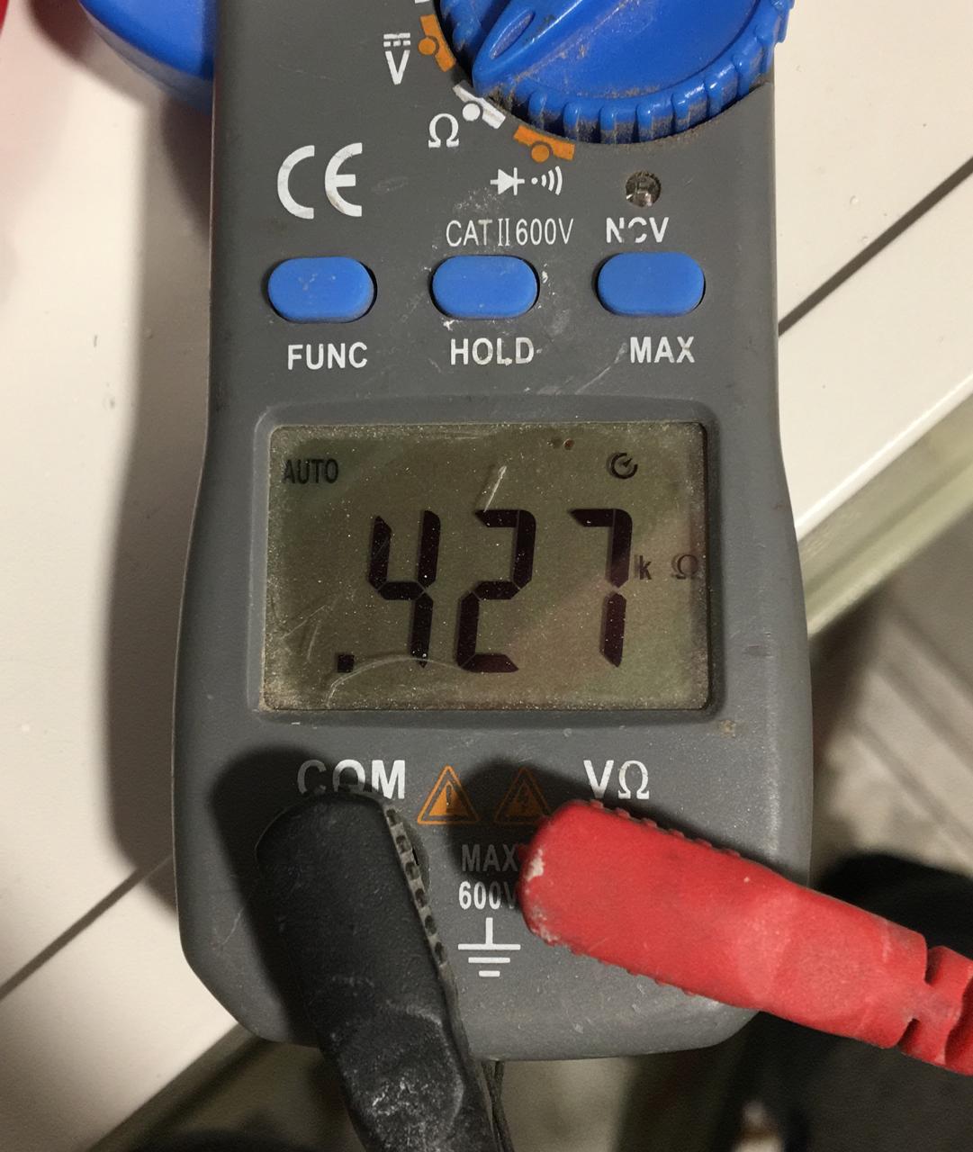

    With the panel powered off what is the resistance between A1 and 0v ? And what is the resistance between B1 and 0v ?

    No, no keypad is working on bus1(Line1). Only ethernet module is connected there.
    FYI 2 keyapads are used.CP050 is the model for both. Both are connected parallelly in the port just below the port where -10 is connected(LINE2).
    In the ethernet port nothing else is connected,only -10 is connected.
    The port under this, 2 keypads and RIO boards are connected(LINE2).
    I would like to ask you reading your last post, is it something like Ethernet module and Keypad should be connected to LINE1?Then only -10 will communicate with Keypad??
    Using LINE2 connectivity for keypad and RIO boards, i have already finished the testing for all sensors, all are working fine.

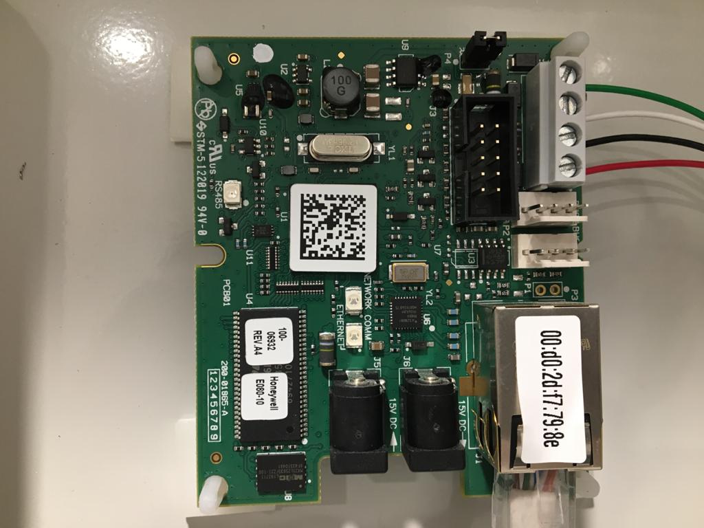

    Attaching images of:
    -The connections in Line1,Line2 ,
    -The value showing for A1,0v and B1,0v are same 427k ohm.
    -Also Panel Model Number attached.

    Did you originally wire the E80 module with the incorrect flying lead or hard wire to the panel? I am suspecting that you may have damaged the E080 module by wiring 12v across the A and B terminals when you used the wrong cable.

    Initially I didnt have the bus cable(flying lead), it didnt come with the E080 module. So I did hard wired. And as explained earlier, LED's started blinking, assigned the IP, Subnet,Gateway in the keypad. Thought it would ping. But it didnt. So bought a flying lead from local market, but that didnt work at all, it didnt even power up the module.
    So came back to the hard wire.

    From your current config, it looks like the COM4 was found and added to the bus. This means that it was working at one point. Now, when you have the module connected it is showing 0%. This makes me think you have damaged the module using an incorrect lead. You need another module to prove this is the case.

    This is a normal config, so it would not cause any issues. Bus 1 supports 4 keypads, 1 Ethernet module, multiple RIO's and many more devices.
    When you had the wrong lead connected to the Ethernet module, the reason it did not power up is because the lead was connecting pin 1 to pin 4 on the module. This means that you had connected +12V to A and 0v to B. This may have damaged the E080 module. Do you have another E080 to try ?
