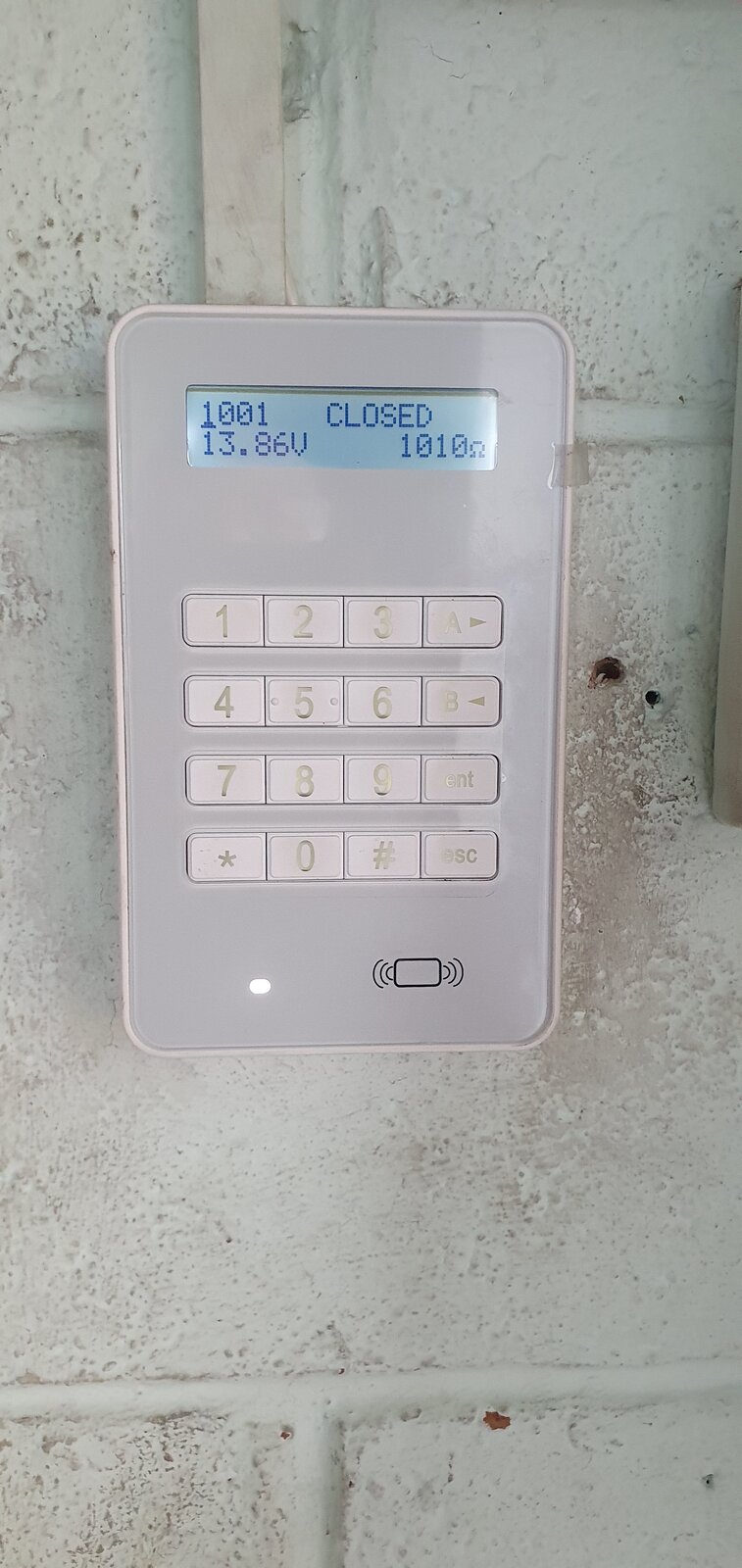

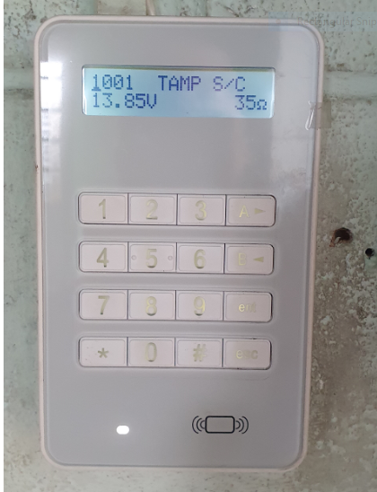

Hi there, looking for some assistance, i have a Honeywell Galaxy FX020 and decided to replace my standard contact switches (3No) for Texecom Impaq SC (Type AEKA0000). i have connected up the EOL to one zone and the MAG to the other zone, with both zones programmed as intruder on the panel. the 1k resistors for both alarm and tamper on the Impaq switches have been applied. The shock sensor works as well as the contact works, However, when I try to come out of engineering mode the alarm reports three tamper faults all related to the Texceom Impaq SC. When i interrogate the panel it states Tamp S/C 35ohms when the door is in the closed position, see photo below.
Post the instructions for the sensor. It's not configured properly.
Also, this should be a new thread as it's not related to the RF thread.
Hi GalaxyGuy, thanks for responding i have created a new post. However, here is the manual for the sensors.
Hi, here are the resistance and voltage readings for when the door is closed.
I've not used that sensor before, but it hints that the door contact and shock are separate. The manual is really poor - they should provide a proper circuit diagram of the internals. Have you wired these separately ? From the manual, it sounds like only the shock has the resistors. You can either program the contact zone as NC or add resistors for that circuit in the sensor.
