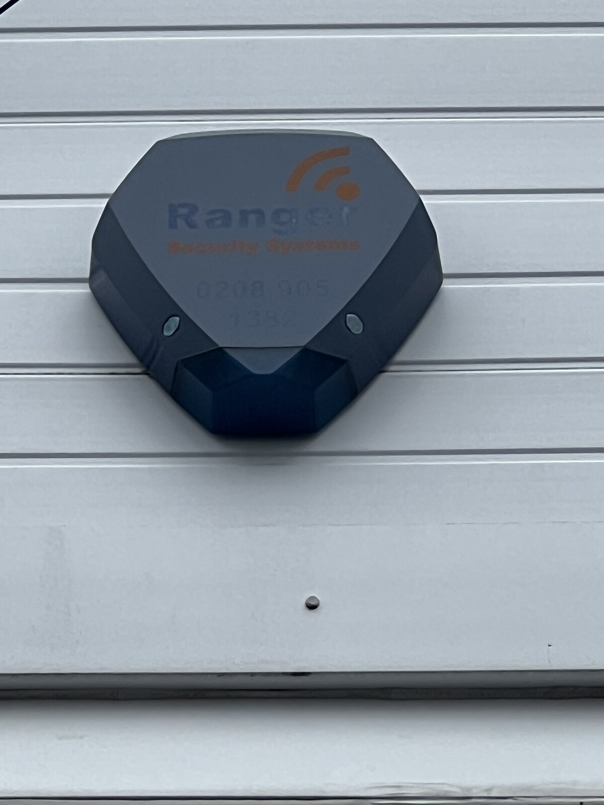

Hello,
I seem to be having an issue with my old alarm system. Intially i got very low annoying noise from the outdoor bell but the following day it was on full blast.
This went on for hrs until i had to disconnect mains and panel batterly after around 20-30 mins the bell stopped.
I tried connecting main power and battery but same issue again, the outdoor bell just doesnt want to stop.
Any ideas what could be wrong? In mean time as i use my alrm frequency is it possible to remove this bell, atleast i can still get a phone alert if there are issues.
Water in bell box or corroded tamper switch / bell box pcb water damaged
OK so how do i remove this from the system for now until i get someone to look into it or resolve it.
I have engineer codes if that helps in any way. If i remove wiring from PCB will it solve the alrm being on all time.
I would remove the + and the - at the control panel and put a link from - to tamper return ….but that bell is probably ok from the picture , i have see them with a burn resistor on the bellbox pcb before !
