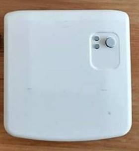

I'm not actually sure where this is. The manifold is in a basement under our kitchen, would it be with that?
You’re looking for something that resembles this:
Try looking next to the boiler or near the wiring centre
It's not near the boiler. Will have to look in the basement when it's daylight! Will revert in the morning.
Thanks so much!
(What will I do if it is flashing red?)

Novice, I paired the two devices as described. But.... the thermostat is still acting up.
I believe it's misreading the room temp (I feel cold, and it's showing 22.0'C) and the fire symbol is appearing at a temp higher than I've set.
Do you think I need to buy a new thermostat? Anything else it might be?
