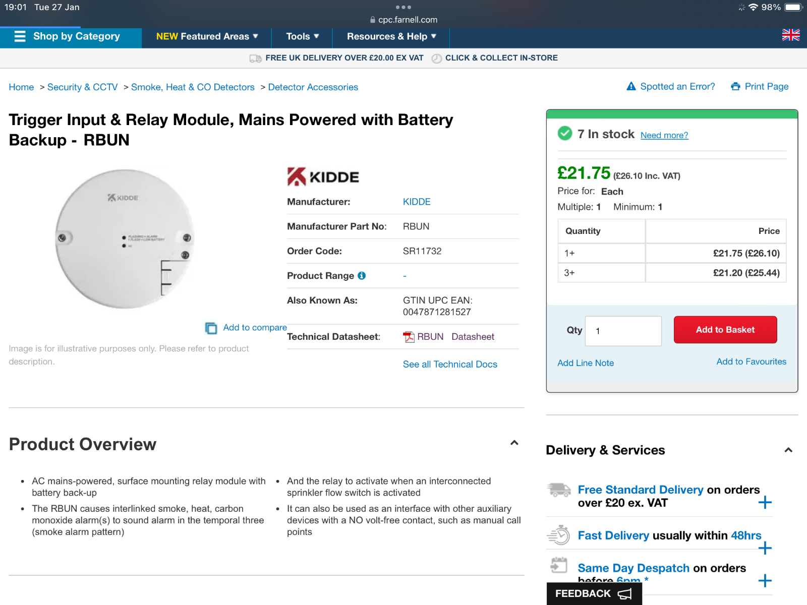

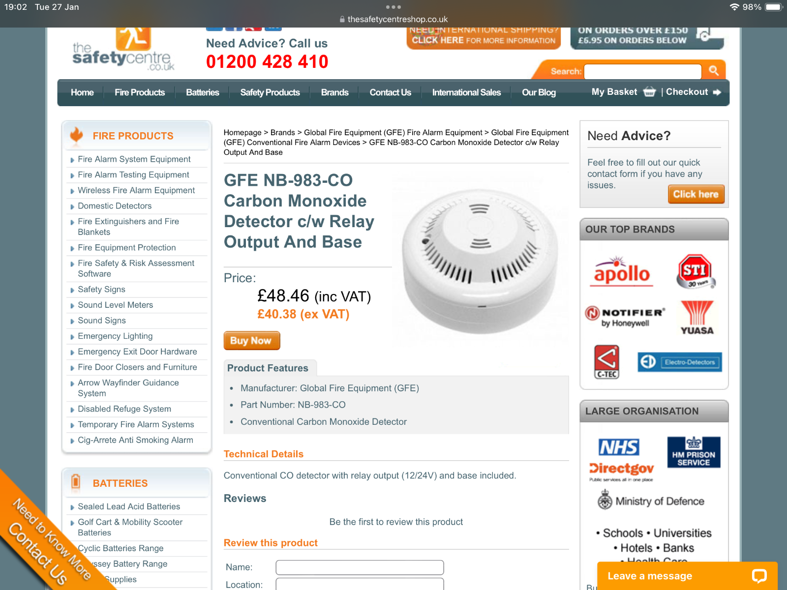

Had the same issue a few years ago …only thing I could find was….not sure if the 12v one is still available, the 240 one will need mains power but it does have a relay to connect to the alarm
Global Fire Equipment do not appear to have any carbon monoxide devices in their current range of detectors.
