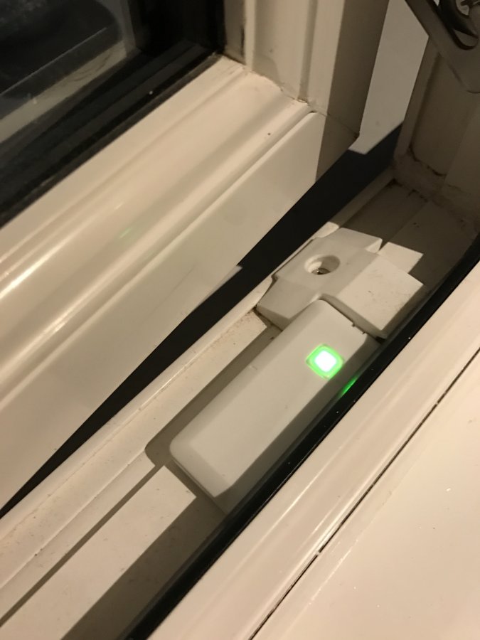

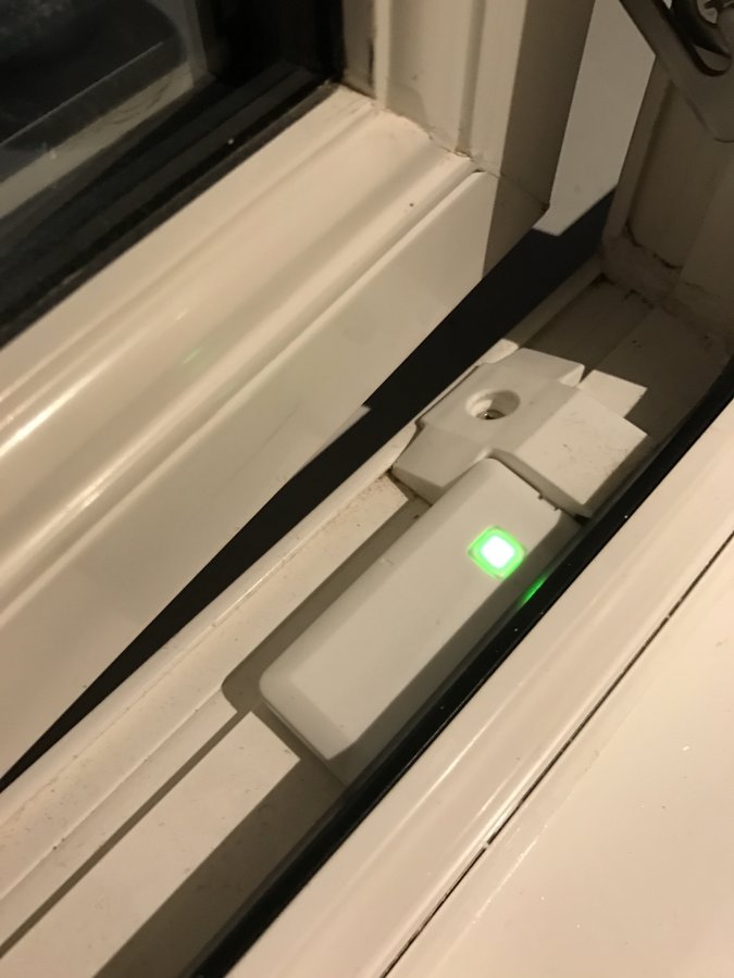

Wow, the micro contacts are small.. somehow the measurements don't do them justice..
they are micro, theres talk of shocks being the same at some point, I hope so, means we can hide the things, rather than trying to make them blend in
I wonder how long before they can put a wireless contact inside a door. There are already zwave battery door contacts that can be.
The texecom micro contact is designed to fit inside euro upvc door/window frames.
