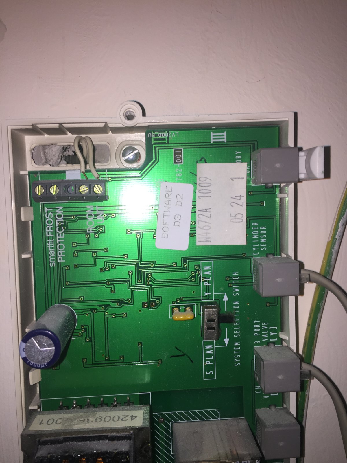

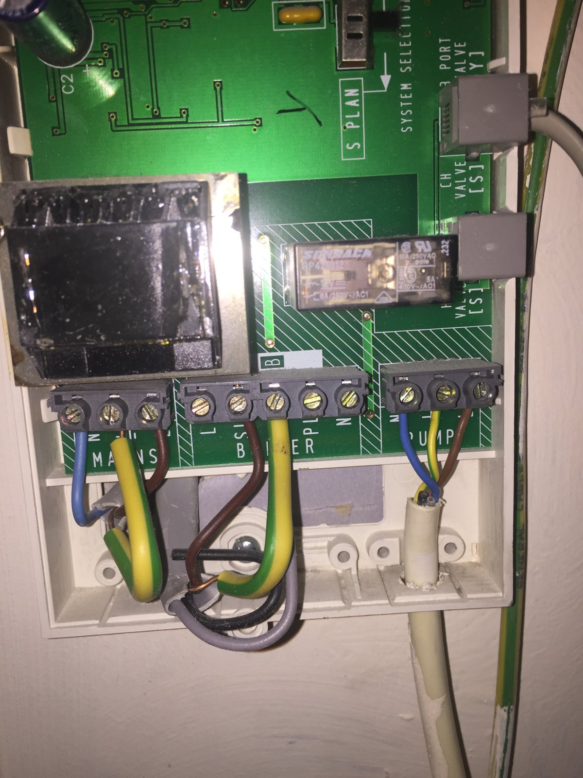

Hi,
Just looking for a little help and guidance on installation of a nest heating system. I currently have a conventional boiler system with hot water tank. I have a Honeywell Smartfit thermostat system; the wiring is basically specialised so not able to “plug and play” the nest system as it were. I’ve included some photos of the wiring on the current system below.
I think I need to replace the cylinder sensor and actuator on the valve with proper wired versions. Then re-wire all in a junction box. I can then connect the hive heat link into the junction box too. I think the existing low voltage wires (twin) can be used to connect a wired hive thermostat.
Am I on the right tracks here? Or are there any glaring mistakes?
Thanks in advance!

The smart fit peaked my interest in car crash projects... But you start off with a Nest, then change to a hive. Which is it? And why do you think be wire can take 230vac?
Sorry I meant nest heat link. Been looking a both but decided on the nest. The smartfit is a right pain!
Which wire do you mean for 230vac? The mains in the picture are connected to a switched fused spur. Do you mean the wire that connected to the old thermostat?
I don’t think it can. The nest thermostat says it has to be 12v which this connection also was from the smartfit system. Says on nest website that the thermostat can’t take 230.
Ah, I see for some reason I thought you were talking about the cylinder thermostat. It's been a long day.
You'll need to use the Center Brand heads from plumbcenter on your valve bodies; or replace the whole valves.
Thanks Dan. I’ll get replacement head then do a wire diagram to put on here just to double check!

The smartfit system works on thermistors so its fairly straight forward to fool the heating using a relay and a couple of different value resistors, the hot water also works using a thermistor but that is better left alone.
