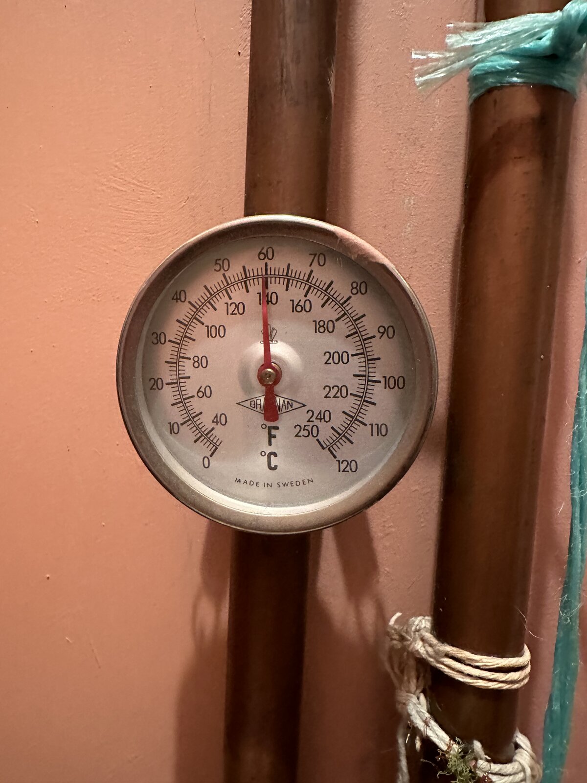

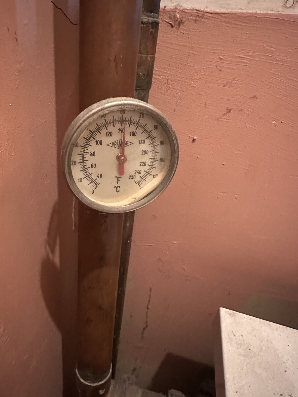

You are correct, just checked. Can’t believe I did not notice that. Tbh when I turn the heating on 90% I turn the water on at the same time. So that’s prob the reason why I never noticed.
On a gravity hot water system, it is the hw channel that only fires the boiler and ch channel that only runs the pump.
When you ask for hw, boiler fires and heats the water in the cylinder to boiler stat temperature.
In present situation for ch the pump is running but boiler is not firing because that is a function of HW channel.
On 699 this was achieved by clever wire links. On some programmers like Danfoss FP there is a gravity setting.
