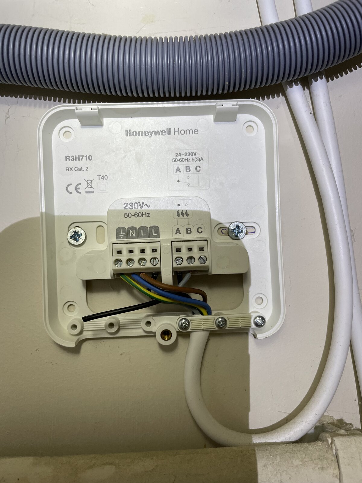

Hi,

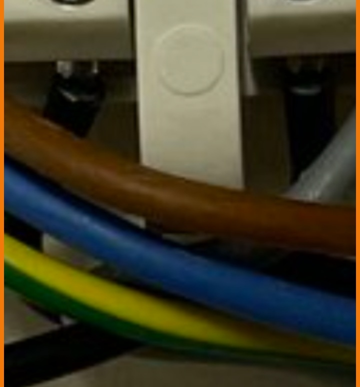

I’m about to switch our Honeywell T3R over to Hive multizone set up. There are 2 Honeywell receivers from a main control box. Can anyone help with correct wiring for the hive backplate?
Currently on each receiver there is a link wire from L to A, this is the bit I’m getting stuck on!
I’m thinking:
N to N
L to L
L to 1 (link)
B to 3
Is this right?
Any advice appreciated!
sorry for the poor photo but thanks for the advice.. have wired up as suggested on both recievers and all working well.
