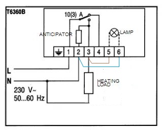

If it is as per the T6360B shown below, wiring the lamp is optional so it may simply be that the lamp has not been reconnected. Check that the links I have added to the diagram in blue (between terminals 2 and 6) and brown (terminals 3 and 5) are present.
It doesn't matter if the wires are transposed at the lamp.
You're welcome. :)
If you find these wires are in place, which is likely if the thermostat hasn't been touched at all, it's difficult to say what is going on at the other [timer] end of the wires as you haven't given any details of the timer, or its wiring connections. However, the T6360B thermostat should have 3 wires running out to it.
1) A live wire connected to T6360B terminal 1.
2) A neutral wire connected to T6360B terminal 2
3) And a switched live wire that controls the heating connected to T6360B terminal 3
It's possible that the the neutral wire hasn't been reconnected at the other end, in which case the thermostat will still turn the heating on and off, (albeit not as accurately as it should do) but the lamp will not light up. So what follows assumes that the thermostat is actually turning the heating on and off.
If you find that the neutral hasn't been reconnected and you wish to reinstate it; just a note of caution. Some installers will use blue wires as a live wire, so it will be necessary to find a neutral terminal and not just assume that any terminal with a blue wire in is the neutral.
Finally, if you do manage to get the light to work and find that it stays 'on' instead of switching 'off' when the thermostat turns the heating off, the live and switched wires have been transposed. Should this happen post back for further assistance.

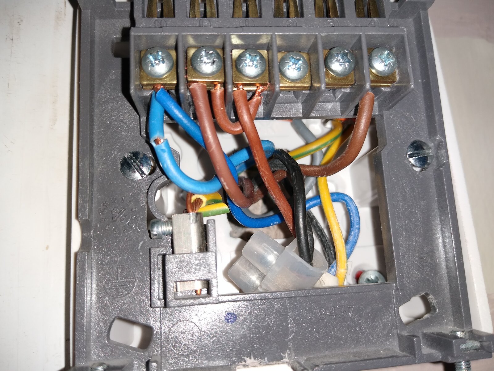

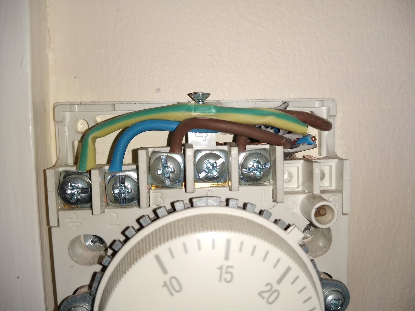

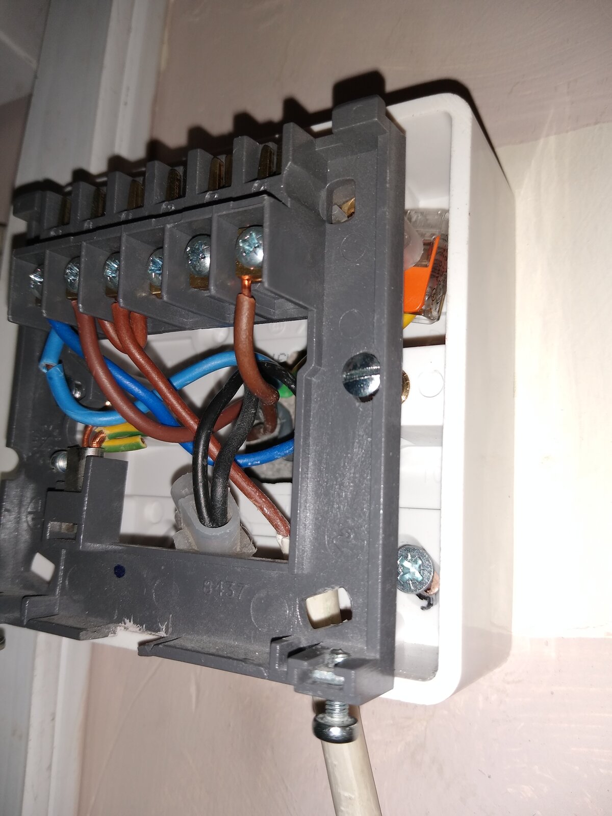

Hi thanks so much for your detailed reply. I took the cover off the timer switch and the Honeywell stat to take some pics. The timer is a Danfoss TS715 Si.
Ah OK. That's slightly different to the T6360B diagram I posted. There aren't separate terminals for the lamp it is wired internally, so forget the bit about the links.

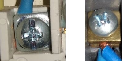

The thermostat wires are connected where I would expect to see them. Terminals 1, 2 and 3. However, the clamps appear to be on the insulation, so may not be making perfect contact with the conductor.
There should just be a tiny bit of copper on show, so that the clamp is pressing on the conductors and not the insulation. Those in the TS715 terminal in the righthand photo are how it should be.
So the question is, were is the other end of the blue wire that goes to the thermostat terminal 2 connected? It should go to the N terminal of the TS715, but looking at the photos it's impossible to tell remotely whether it does or not.

just isolate the power and pull the neutral wire out a tiny bit till tou can see copper then tighten it back up , that might be all you need to do
