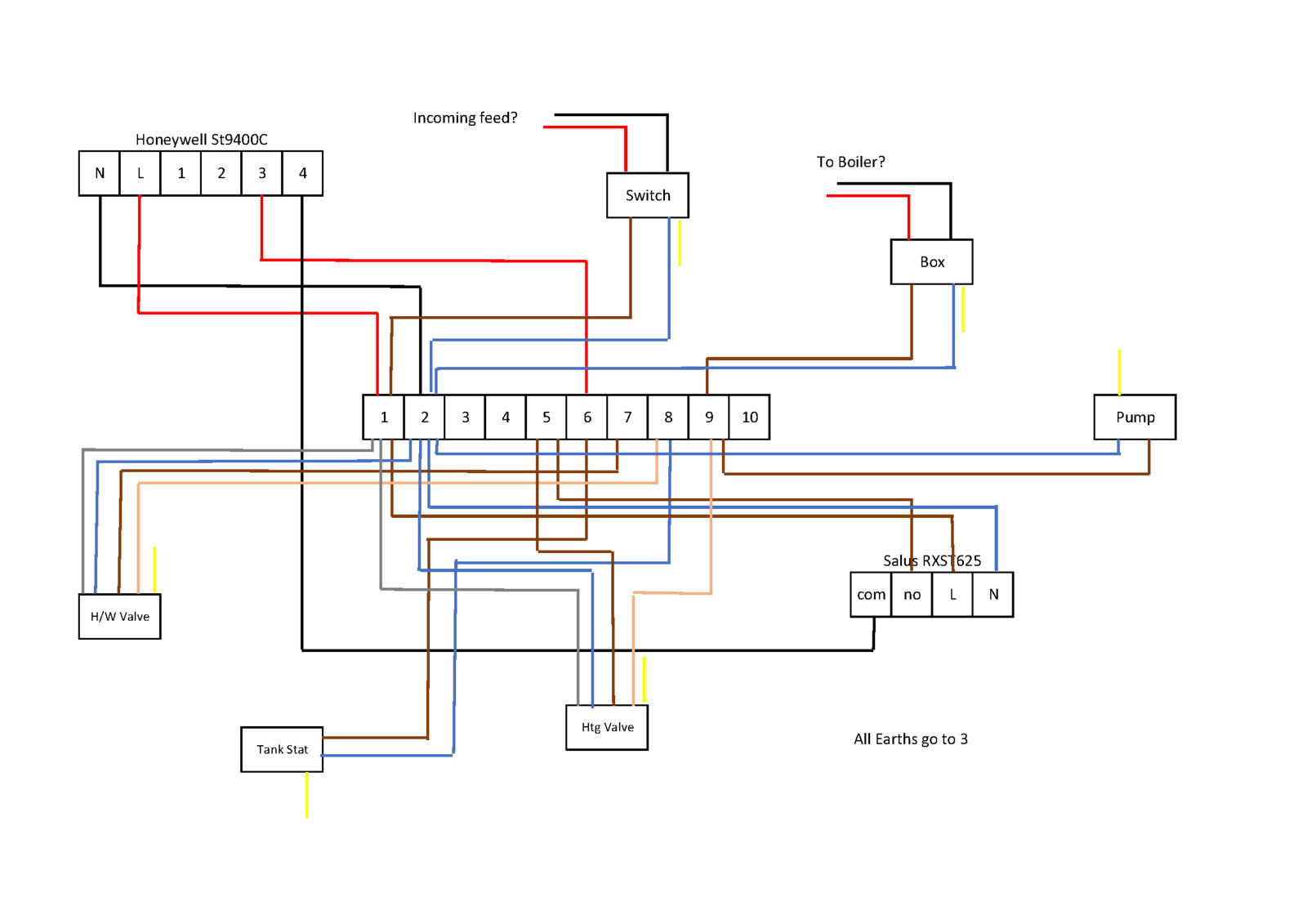

Now I have looked at the wiring diagrams etc for the nest and other existing components. Every time I think I have sorted the replacement, I doubt myself and start over the thought process. Could someone out there confirm what should be fed into the Nest heat link box please? I have sketched out the current set up, it will be a good opportunity to tidy up the wiring that is so jumbled at present it took some deciphering to get the sketch!
I should add that the Nest is replacing the Salus wireless stat so will be wireless to the heat link box as there are no existing stat wires.
Ben

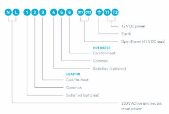

Step 1. The Nest Heatlink replaces the ST9400 programmer

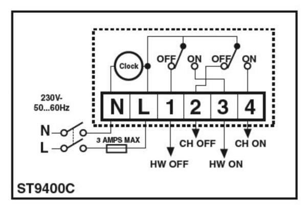

From the diagram of the ST9400 shown in the thumbnail below we can ascertain that the wire currently in 3 is Hot Water Call for Heat, and the wire in 4 is Heating Call for Heat
They are moved to the Heatlink as follows:
1. The Hot Water Call for Heat wire then goes to '6' at the Heatlink
2. The Heating Call for Heat wire then goes to '3' at the Heatlink
3. The 'N' and 'L' supply is self explanatory and is just moved from the ST9400 to the corresponding terminals at the Heatlink
4. Heatlink terminal 'L' also needs linking to the two common terminals '2' and '5' (these connections are made internally with the ST9400)
Step 2. Removing the Salus Thermostat Receiver
Because the Nest carries out the functions of the room thermostat, the old wired thermostat receiver needs to be decommissioned to prevent it overriding the Nest. It can't simply be disconnected as this would leave the heating wiring 'open circuit' and it will not operate.
1. Disconnect and remove the N & L 230v supply to the Salus receiver
2. Connect the wires in 'com' and 'no' together, so that the end result is that the Heatlink terminal 3 (Heating Call for Heat) is connected to the wiring centre terminal 5 ie the live to the heating motorised valve.
