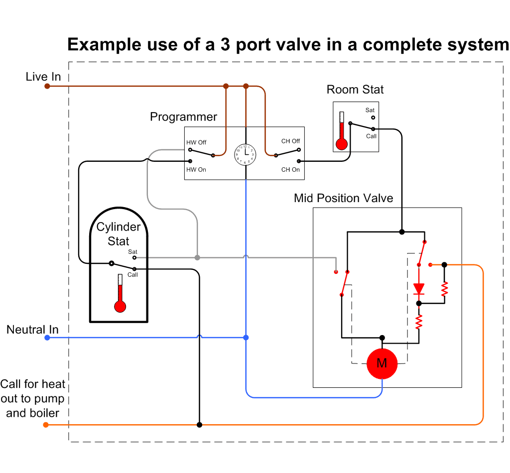

I have seen it mentioned in some posts that the HW will only heat if boost is selected unless the Nest is told what type of boiler is installed, write
"Nest Y plan" in the search box, above right, there is all sorts of info available from the posts there.

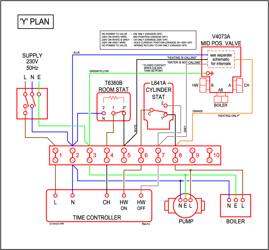

Also have a look at these basic Y Plan schematics to give a idea of how the "641" cylinder stat is wired

I traced the wiring it connected as per the y plan std. Fault is either the 3 way actuator or thermostat.

To check that the valve is spring returned to its HW (B) position, switch off the electrical supply, there should be resistance immediately you start pulling on the manual lever.
Suggest next, programme CH & HW programmed On, ensure CH thermostat and cylinder thermostat turned down (not calling), restore power, again check for (immediate) lever resistance.
Turn up cylinder thermostat, check for (immediate) lever resistance, (boiler should also fire up).
Turn down cylinder thermostat, turn up the room thermostat, check for "floppy" lever (no resistance), valve should then have moved fully over, boiler should fire and (CH) port A pipe only should get hot.
Turn up the cylinder thermostat, valve should move to mid position and both CH port A pipe and HW port B pipe should be hot. If this happens then there is NOT a cylinder thermostat fault.
