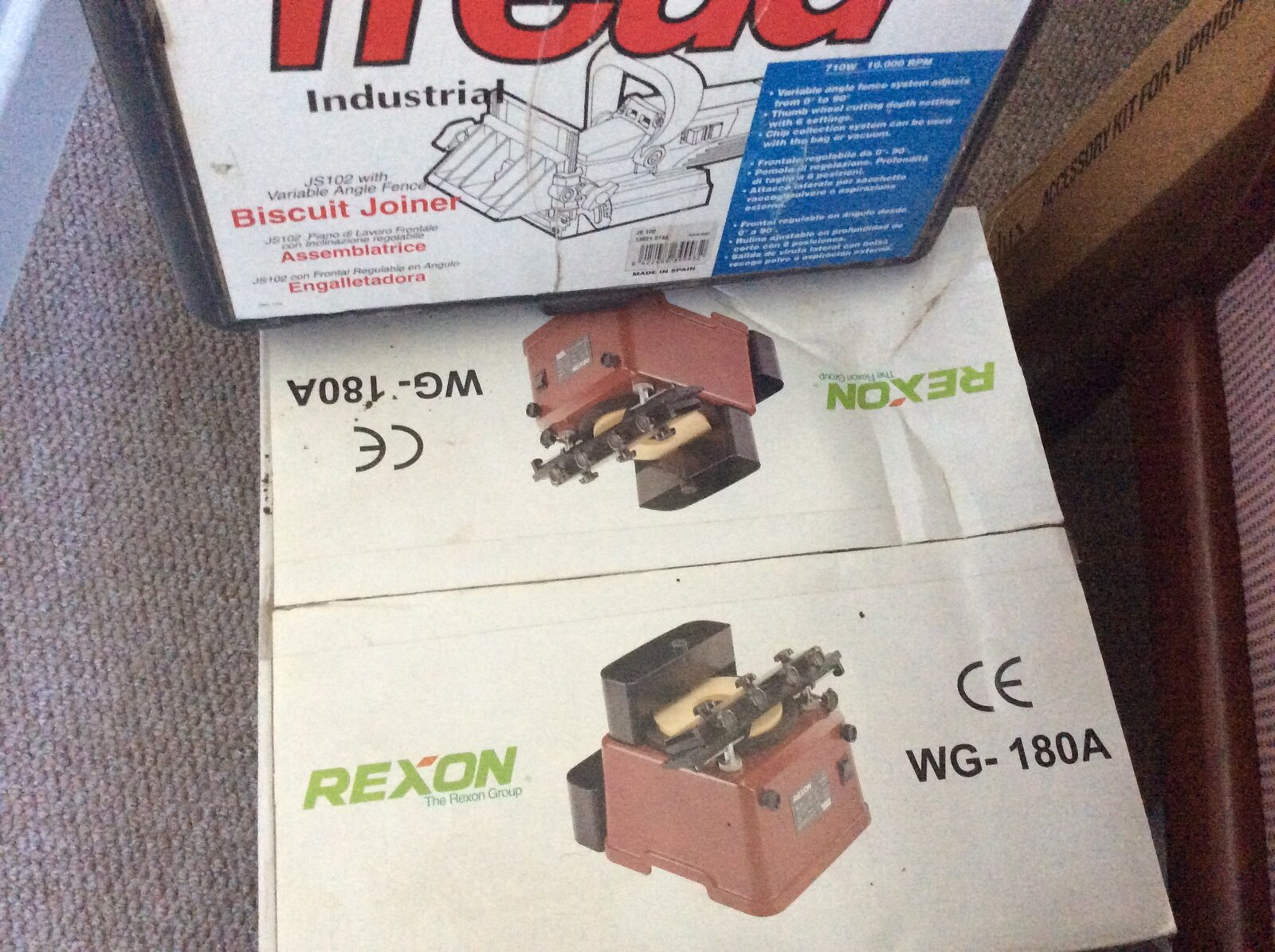

Amongst other things, I picked up a new horizontal wet grinder at a garage sale but not had chance to try it yet.
Looks like a copy of the old Makita horizontal wetstone. You may need to make up a jig for it - the long jig is more suitable for pplane knives than chisels, I feel. I found the Makita stones rather soft (typical Japsnese wayerstones) so you need to be cautious when using them and keep the tool moving from side to side. Also, make sure that you soak the stone well before use - used dry they tend to clog rather quickly
