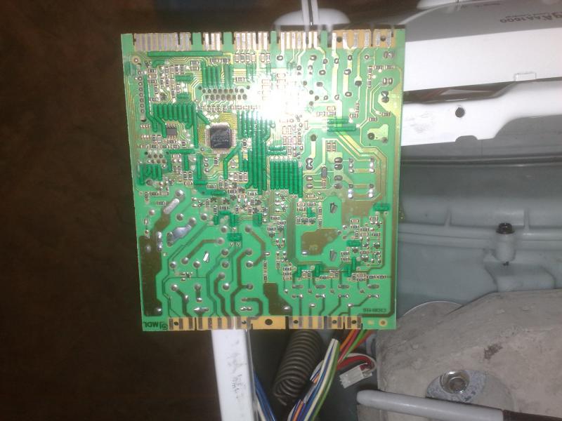

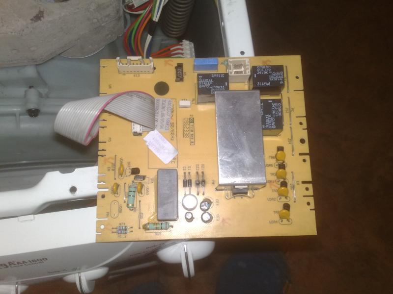

I recently dried to put it on a spin to get rid of the water in the drum but noticed a bit of smoke coming from the top of the electronic PCB on the right hand side of the washer :cry:
I have powered off and disconnected the 8 pin and 9 pin connectors from the top of the PCB and will leave to dry out overnight - am I right in saying this isnt the main PCB ? If I have damaged this board then what price am I looking at for a new one ?
Smoke & pcb in the same sentence does not sound promising :(
Pull the card & check it for blown track/components. Post a photo of what you find.

I have reconnected the PCB and the washer is currently on a spin program with no signs of smoke so it would appear to have dried out.

Pressure switches don't fail very often. To be honest I think you may have fried your pcb after water leaked into the motor (the motor could also be history). I don't see any obvious damage from the photos you posted....but you are nearer the pcb than me. Take another look (on both sides) for damaged tracks/components. Like they say "no smoke without a fire".

Im sure the smoke came from the 8 and 9 pin plug due to dampness on the terminals.. There isnt any obvious signs of damage that I can see.

Can you mark the photo (or take a new one & mark that). It may help identify which component(s) belong to the smoking pins.
The 9 pin connector controls the motor & NTC....the 8 pin controls the drain pump & inlet valve.
So...why do you suspect the prossostat? Unless the machine overfills/underfills/or has an oddball heater issue the chances are that it is just fine & enjoying another wonderful day in the washer world. Faulty pcb's don't always need to have scorch marks, blown tracks/components etc to be defective (neither do motors). A triac could be shorted & you probably wouldn't see a thing. I don't know where you want to go from here...I would consider sending the pcb to http://www.emwelec.co.uk/ & get the motor checked out.
