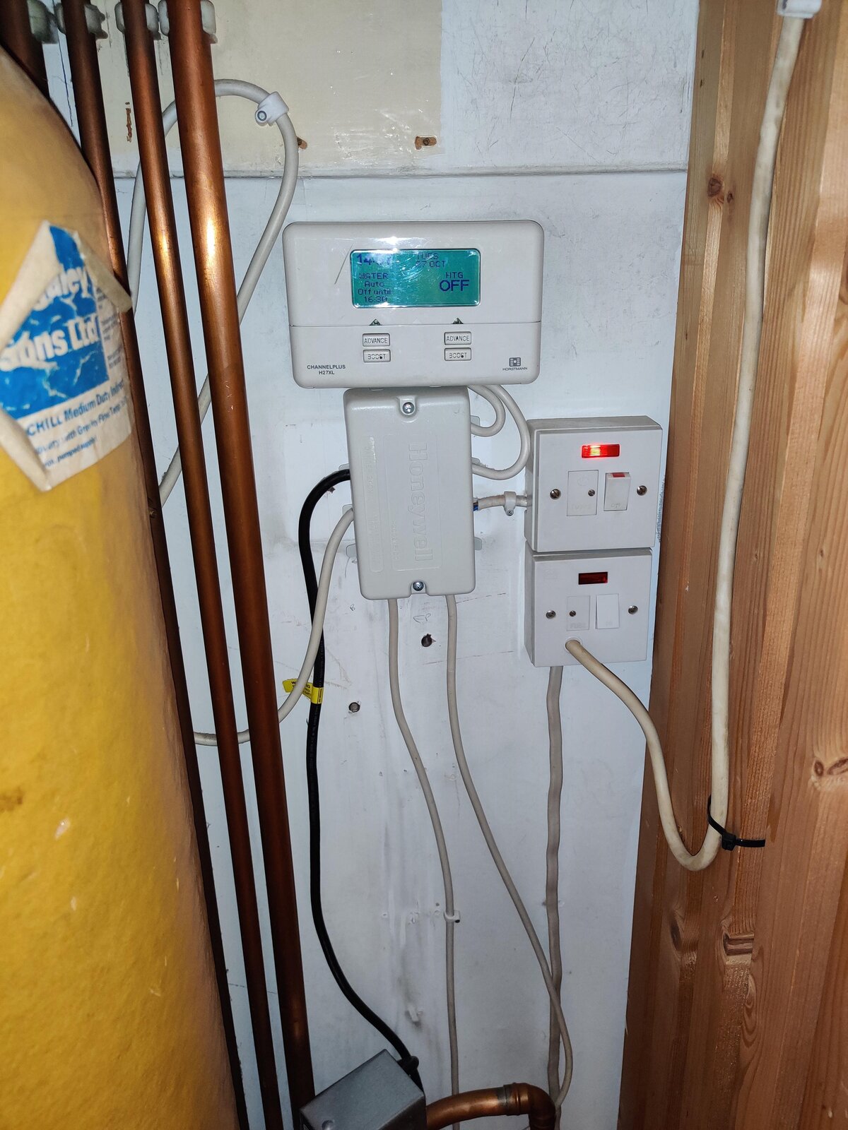

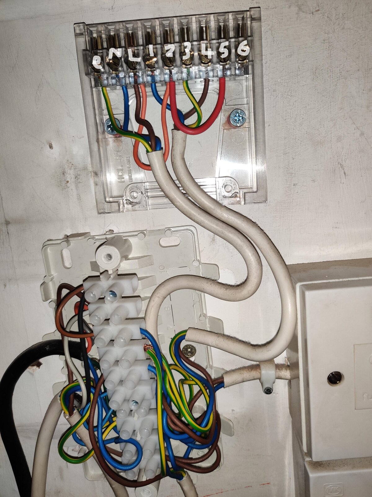

Hi all, appreciate this thread is quite old now, but I'm just looking through it as I also have a Huntsmann H27XL.
The diagram Stem posted is what I was looking for, (thanks, that's very helpful), however, when looking at my wiring, I can't figure out what each wire corresponds to, especially as an earth wire is in no.3 (HW off) and nothing is in 6 (CH off). I was wondering if someone might be able to help me work out which wires are which, so that I can replicate them onto the hive receiver (I'm on a system boiler, with no thermostat, just the Huntsman, and I have a dual channel Hive).
I've also attached some pics if that helps. Cheers.
View media item 105405
View media item 105406

I've attached some pics of my current wiring set up. Where I'm getting confused on my set up is there is an Earth wire for connection 3 (HW off), and 6 is empty (which should be CH off).
I don't have a thermostat to disconnect, so I assumed this would be quite a straighforward switch over. If anyone can help me figure out the wires, that would be much appreciated.

Hi NJAY
Whilst a green and yellow wire has been connected to terminal 3, it is definitely not being used as an earth wire. It is being used as a live. This is very bad practice because people like yourself will assume it is being used as an earth wire and it's not. Ideally that cable should be changed, or as an absolute minimum a brown sleeve should be slipped over it to identify its true purpose.
...and nothing is in 6 (CH off).
Don't worry that terminal is very rarely used. I've seen 100's maybe even 1,000's of installations and only seen it used 2 or 3 times. Slightly unusual though that someone has gone to the trouble of adding a link between 5 and 2 though. This is the electrical supply for 6 (CH off) so the link is not actually doing anything.
What you have is probably the most common set up (known as a Y Plan) and is the same as per the original posters system, so the advice I gave to Elnew is the same for you should you wish to install a dual channel Hive.

One thing I have since noticed is that the op didn't have a wire in terminal 3, this is because his is an S-Plan and doesn't require that connection. However as I said, the advice is the same. You move the existing wires from the H27XL to the Hive terminals that have the same function. If there isn't a wire in a certain terminal now, that will be because your system doesn't need it.
So just to confirm on my set up:
L, N, E - all fine
In 1, I have the blue neutral wire, denoting HW ON. This goes in 3 on HIVE
Slot 2 - I have the linked-Live (dotted connection in pic). You mentioned Hive has this made internally so this can be discarded.
Slot 3 - I have the yellow and green wire (will change the sleeve to brown), denoting HW OFF. So this goes into 1 in HIVE
Slot 4 - I have the brown wire denoting CH ON, which goes into 4 on HIVE.
Then that leaves the connection of Live extended to 5. So again this can be discarded.
Where is the wire for CH OFF? Is this done automatically in the internal channel that HIVE has created?
Cheers.
First of all it's not a neutral. All of the neutral wires are in N and only in N. It's a blue wire being used as a live wire (so another brown sleeve over it would be a good idea) But yes 1 to 3 is correct
Correct
Correct
Correct
Correct
This terminal is made 'live' by both the Horstmann and the Hive when they turn the CH off. There will have never been a wire connected to it because your heating system doesn't need this connection. If there's nothing connected to this terminal at the Horstmann and you won't need it with the Hive.
If you have an existing room thermostat somewhere that will need attention to stop it interfering with the operation of the Hive. It can't just be disconnected. If you need any help with that, post back details of it and a photo of the wires connected to its terminals.
