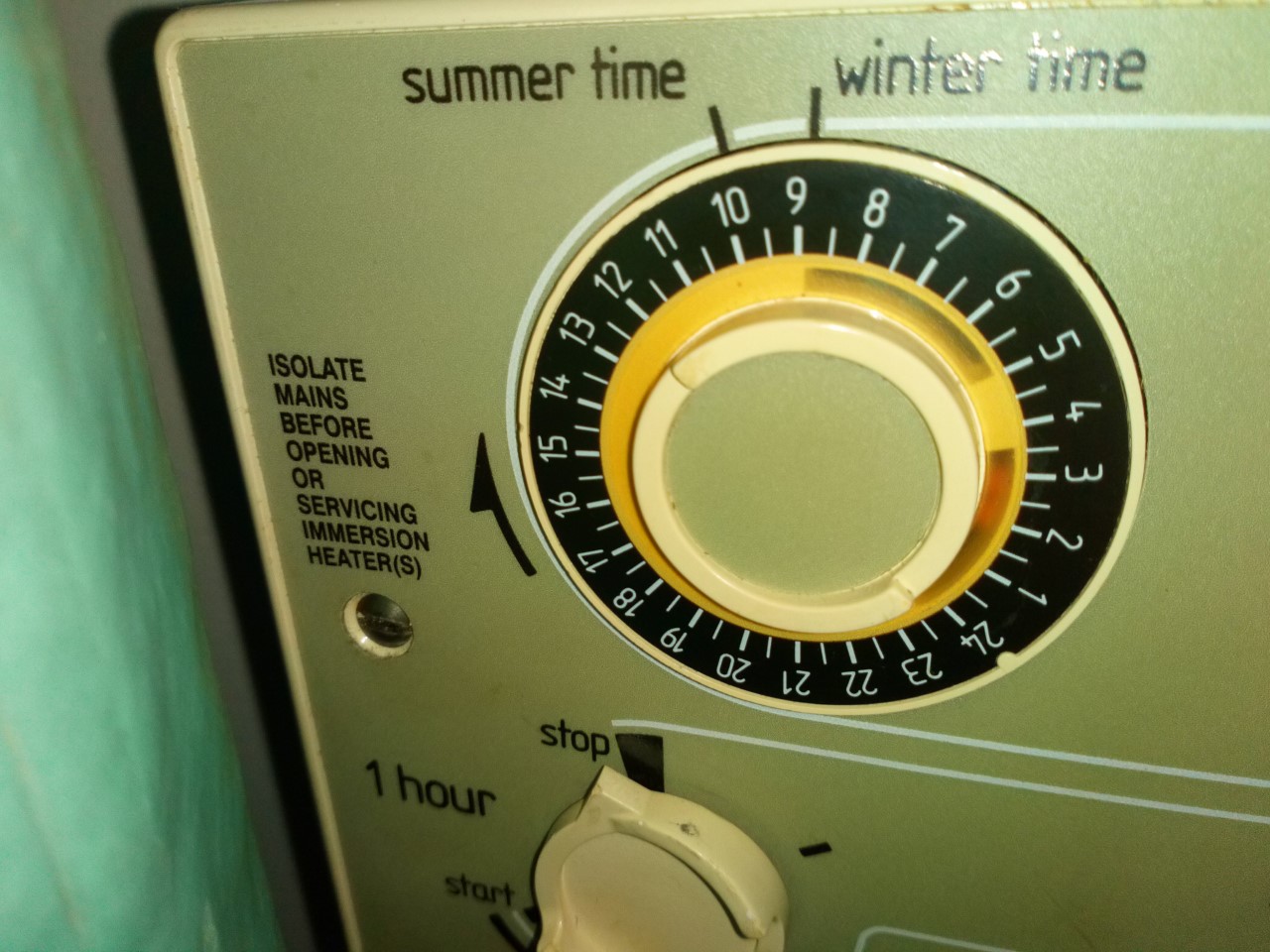

Hi everyone, Ive read a couple of threads re setting this but still confused. Can anyone tell me what numbers this timer should be on. Weve just moved in and have no hot water unless we use the boost. Many thanks.

There isn't any setting, other than turning the dial to the correct time. Shows approximately 10am in the photo.
Although the switch times can be altered when it's installed, those being incorrect would not result in no hot water, only that it would use the more expensive electricity rather than the cheap rate.
If there is no hot water at all, it's likely there are other problem(s) such as the thermostat failed, element failed, fuse/circuit breaker, or it wasn't installed properly in the first place.
Make sure:
1. Clock is set to the correct time.
2. Heater switch is set to "Timed"
If it still doesn't heat up overnight, then as flameport suggests there are other problems. You will probably need a plumber's assistance.

Hi Thank you weve just had a plumber out whos suggested fitting a new thermostat and a new element !
