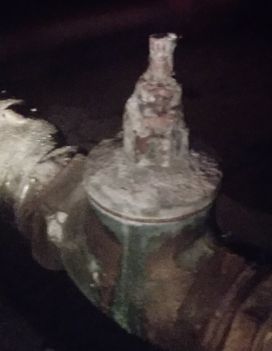

For a while our running water is scalding hot, read somewhere it could be a faulty Cyltrol Valve - as layman I never heard of it before, could not find a stat on hot water cylinder (32 yrs old, we have traditional indirect heating sytem). In addition there is a trickling overflow into small water tank - could that be result of water in hwt heating up too much and therefore pressure builds to release some water into overflow? I include photo of valve I spotted on a pipe near the hwt, is sits quite low
img_20190726_094438-jpg.168392
this is the valve (Cultrol Valve?) if found on a pipe close to bottom of hot water tank
do you mean an overflow trickling out of the tank? Or do you mean fresh water trickling into the tank from the fill valve?
Or trickling into the tank from the large copper pipe hooked over the top of it?
Post a photo please.
View attachment 168393 this is the valve (Cultrol Valve?) if found on a pipe close to bottom of hot water tank
It might possibly be, though your picture is poor. There should have been a blue plastic knob to turn it (which probably broke because the spindle is seized). If you look at the flat base, there should be two brass "lugs" that prevent the knob rotating more than (from memory) about 45 degrees.

It is very old and a replacement valve is expensive. Better to modernise it to a fully pumped system. I did. Or at least add Cylinder Thermostat control (this is a wiring change) It looks like you have multiple problems. Unless you are very fond of DIY plumbing, you'd do better to ask around for a well-recommended local plumber. You need not touch the boiler, so it does not have to be a Gas-safe person. Older plumbers will have seen lots of these.
I bought a new Cyltrol valve, didn't need it in the end, sold it for around £80 on ebay. They are seldom used now. There are much better ways.
If you HW is very hot, try turning down the thermostat/temperature knob on your boiler. Your boiler is probably also very old and may have a temperature problem. It's hard to see how you will get round of this without spending a fair bit.

don't turn the spindle or it will leak

Do you have an electric immersion heater that may have been inadvertedly switched on
It has been asked you post a photo of cylinder, if it doesn’t have a thermostat it will be working from the boiler thermostat only. If your cylinder isn’t scaled up then get a cylinder thermostat fitted. As for the overflow issue it could be a crack in the coil (spiral as you call it), it I would be expecting this to overflow outside constantly. However you’re describing it filling into small tank so filling valve letting by?

It is very simple, your system is very basic, the temp of the HW from your tap can not exceed the temp of the water leaving your CH boiler, turn your boiler off and see if your HW is still hot

Is there a pipe directly above where that one goes into the cylinder - it could be as much as threequarters up the cylinder.
