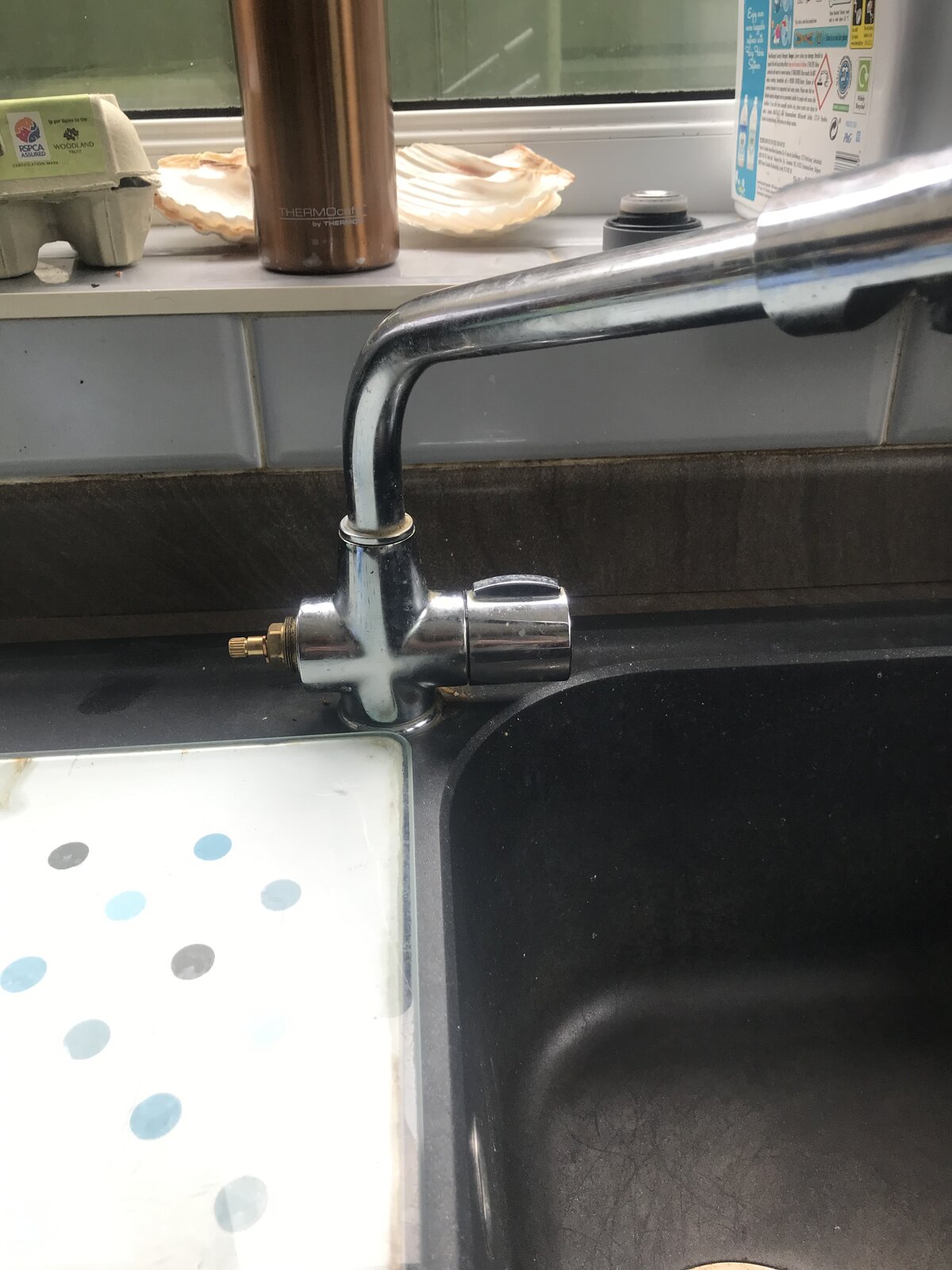

Hi

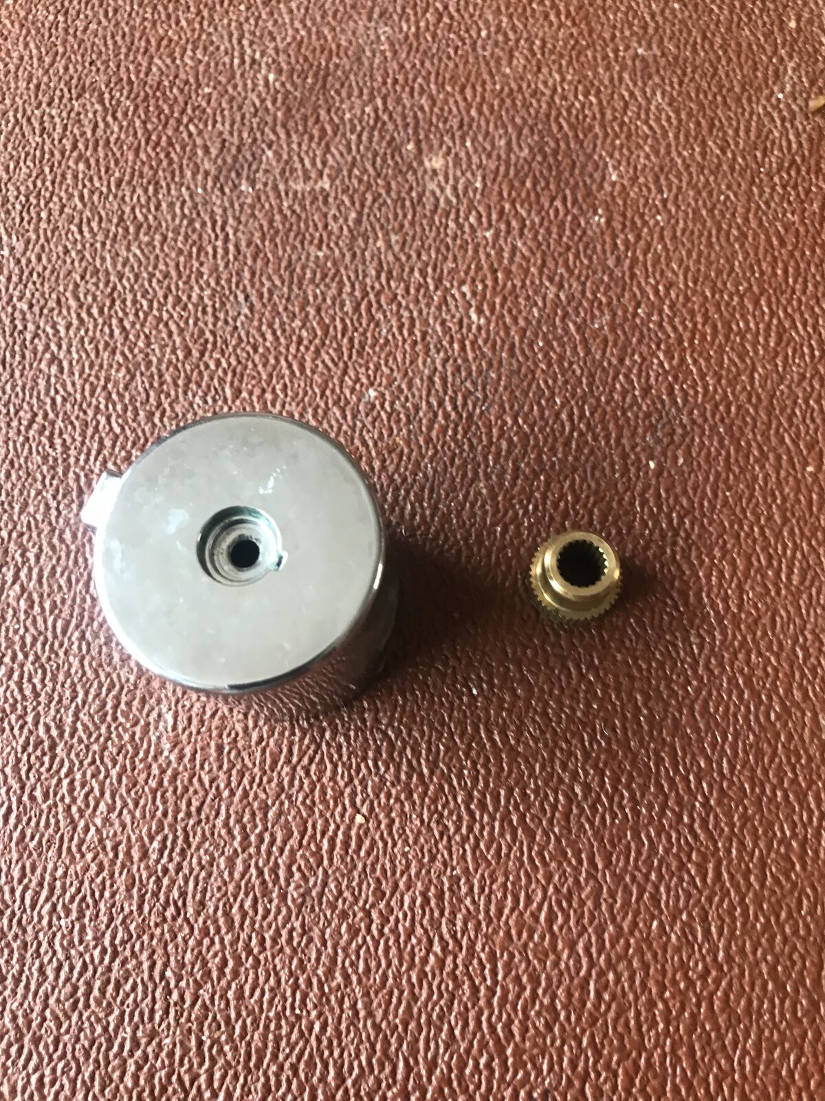

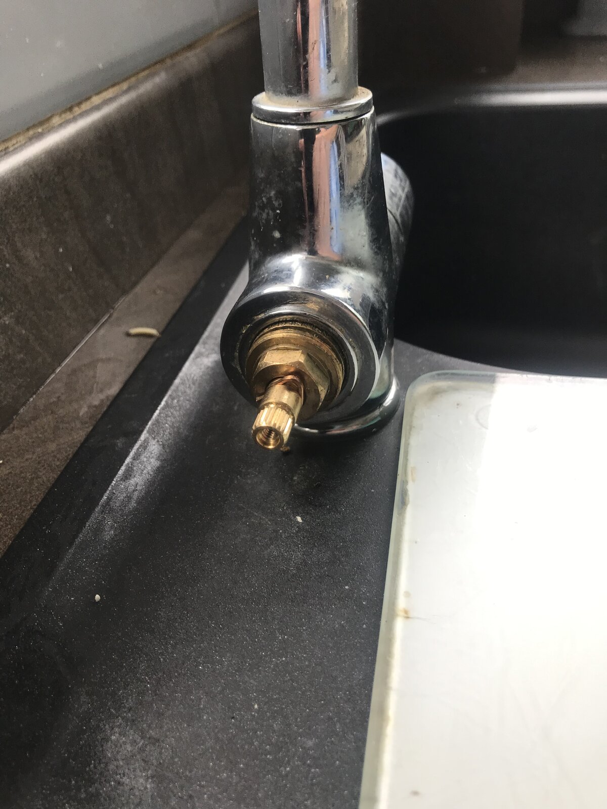

The hot tap on kitchen mixer is missing the red insert. Net result is tsp isn’t secured snugly to gland. Went to Screwfix, and nice guy suggested Amazon or EBay. Tsp is about six years old, but probably already well out of day. Photos included. Any ideas?
Many thanks
If it helps, the combined sink and tap is PK H Schock Viola Black + Arch Tap.
Cheers
I think you need a screw in there, the red cap will only be a cover to hide the screw. No idea what thread it would be, probably something like M3

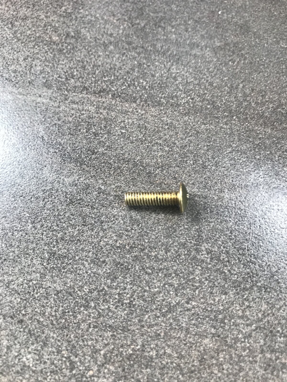

Morning
Saga continues. This is the mushroom head screw I need. (1.5cm long and just over 0.5cm head width) Just been to Screwfix, but they don’t stock
Thinking of going to B&Q
Thanks. Happy to order them, but head is different to ours. (Our screws are cross head)
Are you sure it is M3
Sounds very small to me
Metric screws are measured by diameter (not by head size)
And M3 means 3mm diameter
If it really is, search for
Screw
M3
Brass
Round head
Pozi
15mm
Small numbers are cheap on Ebay
A Pozi head has an "X" stamped on the head. A Phillips doesn't. Both are cross head but don't fit the same driver correctly.
A pan head or button head screw would also fit, a countersunk head won't.

Away from home at the moment. The screws are definitely Phillips head tho.
Compare it against a 3mm drill bit. An M3 screw will be about the same diameter (just a tad smaller), and the drill bit will not fit the threaded hole.
