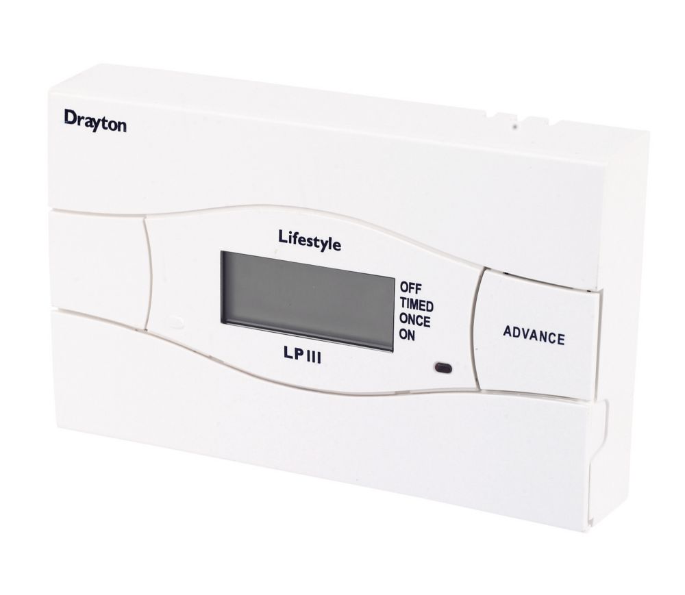

Also the timer on the boiler doesn't work anymore. Is a mechanical analogue timer.
Can I replace it with a digital one?

Is the time switch broken too, or just the timer?
i had the same make of boiler installed a few months ago and had a new timer and thermostat fitting
is this the timer from the original boiler and not replaced at the time the boiler was replaced
the hot water on a combi is on demand and so the timer I have is just for the CH -
if your timer is broken, then perhaps it has just turned the boiler off
I have a digital timer and wireless themostat installed
mine is a drayton timer , lifetime single channel
considering the low cost - surprised this was not replaced with the new boiler wiring
