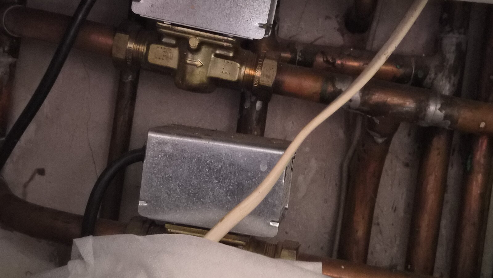

Look in your airing cupboard, where your cylinder and pump are located. Post a photo, and someone will ID the motorised valve for you.

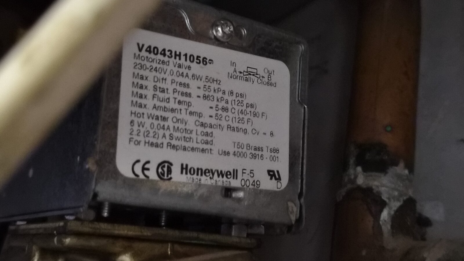

So below the boiler I found two silver boxes with Honeywell motorized valve written on them - that must be it :). I'm guessing I have two as one is for heating and one is for water? Both have the same P/N. Any way to determine which one is which? Photo attached. Sorry it is in a tight confinement so hard to picture...

You have what is known as a S-plan, which uses two motorised valves, one for CH, one for HW. The HW one is either sticking or the microswitch inside it is not operating correctly. If you call for CH, the valve with the pipes which gets hot, is the CH valve - which means the other one, must be for your HW.
What you may find, if the HW one is sticking, is that if your HW is all set to be on, yet the boiler is not firing - simply giving the HW valve actuator a thump, might be enough to get it to come on.
The long term fix, is to replace the actuator, the electrical part on top, which turns the valve on and off. In some models, but not all, you can swap just the actuator - others, you have to change the actuator and valve, as a unit. Your model, is one where it can be replaced as a separate part - https://plumbinbits.co.uk/product/honeywell-40003916001-actuator-head/

@Harry Bloomfield - thank you for all your help. You were absolutely correct, it was indeed the motorised valve. In the end I diagnosed it by listening to which one was constantly buzzing! Found the lower one in my picture above to be the culprit! I did try to tap it moderately, as suggested, but not joy!
In the end I did some research, found that you can indeed replace just the head/actuator in the V4043H Honeywell valves. Much more desirable to me given I'm more competent at electrics. I got a compatible Corgi head that is well reviewed and much cheaper than the Honeywell. Wired it into the boiler junction box, replaced the head on the valve and now back into life :)
