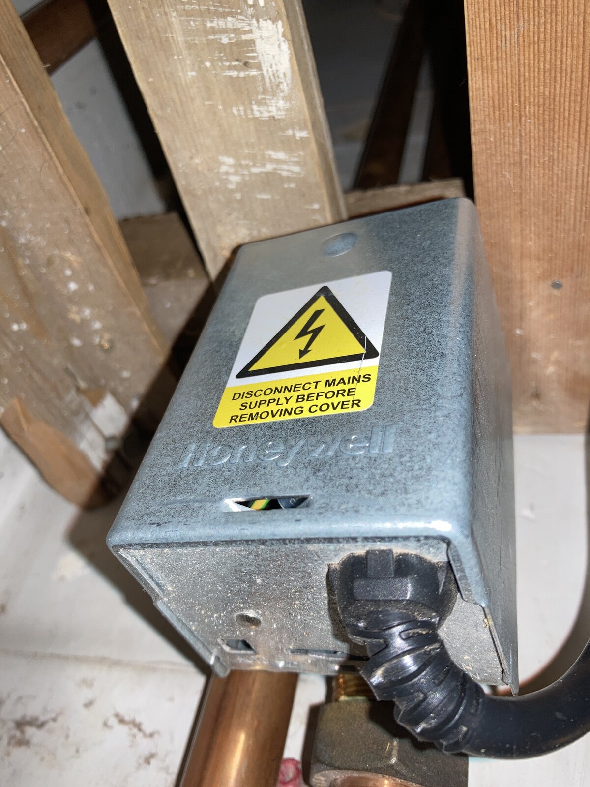

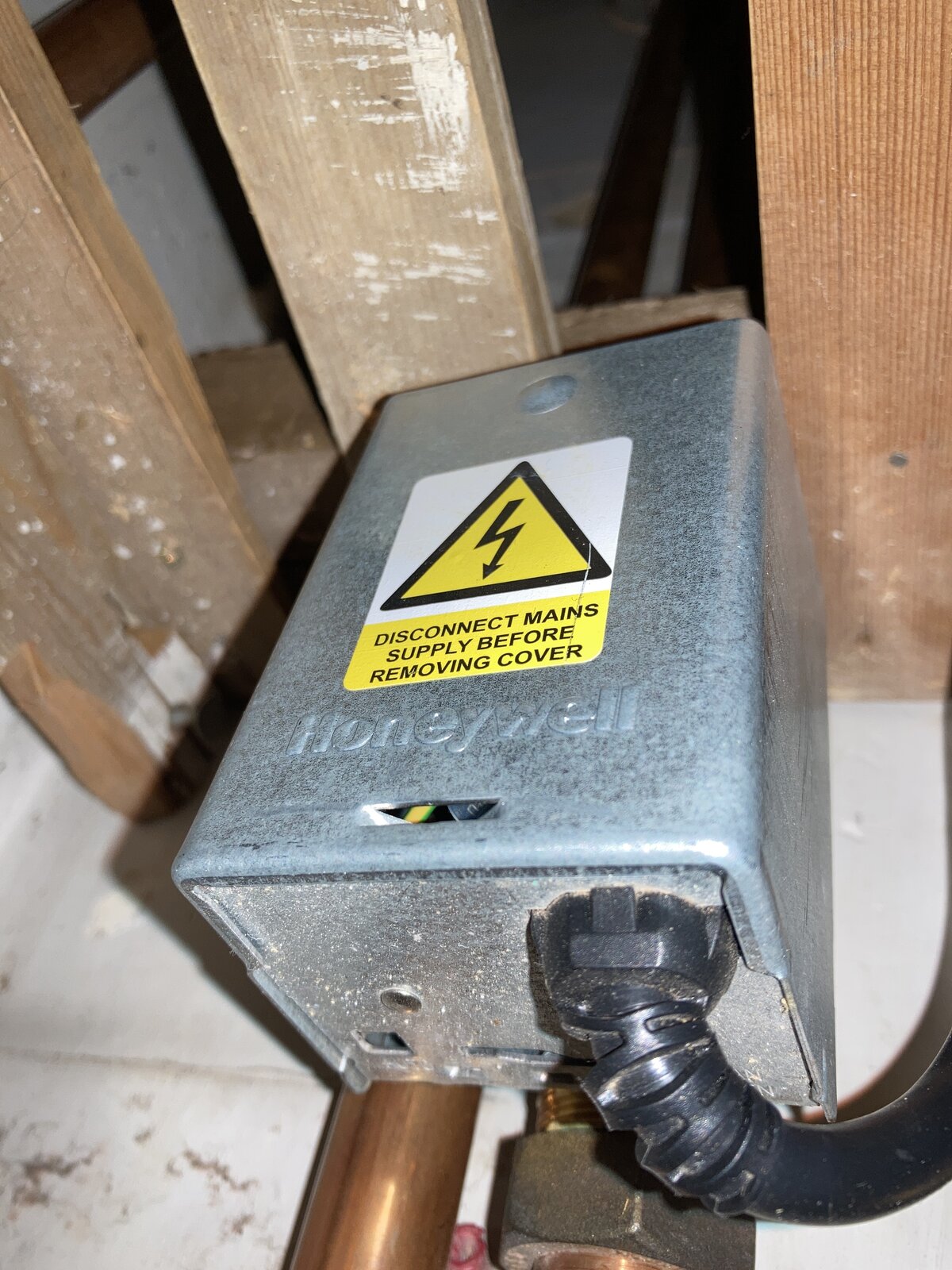

So, this is my valve. (All working fine now by the way).
Obviously I'll use genuine Honeywell parts but shall I change the whole head and wiring loom where it goes into a junction box or just the little motor with 2 wires inside the head?
With the power off pull the motor out (connect a temporary earth bond wire..I use croc clips etc), power on and create a heating/hot water demand.
With a good motor it should be a struggle to stop the cog turning with your fingers.
Only ever use the genuine motors (available badged as Draytons from screwfix)...the knock-offs are a waste of time.
Have you considered changing your holiday dates?:mrgreen:
If you know how to remove the valve head then exercise the valve shaft with a small spanner. It should be easy to move across its 90 degrees or so. If it's stiff at first, but then loosens after a few wiggles you can fairly assume that is/was the cause of your failure. After a week of sitting in one place doing nothing (that's the valve, not you) it may have refused to open fully.
If you do no repairs, and the same happens again in two years, try also turning on the hot water from the Hive App...if that valve has even cracked open you should see a marginal increase in room temperature as the hot water demand causes the boiler to fire.
90 degrees..sure on a Danfos or Sunvic shoe valve but Honeywell ball valves the movement is around 20 degrees.
