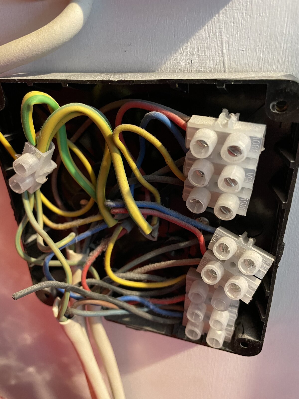

I can tell you that the wiring box beside the hot water cylinder and actuator has the following cables connected:
# / ACTUATOR CABLE / HTS3 CABLE
2 / BLUE / -
5 / WHITE / -
6 / - / BROWN
7 / ORANGE / BLACK
8 / GREY / BLUE

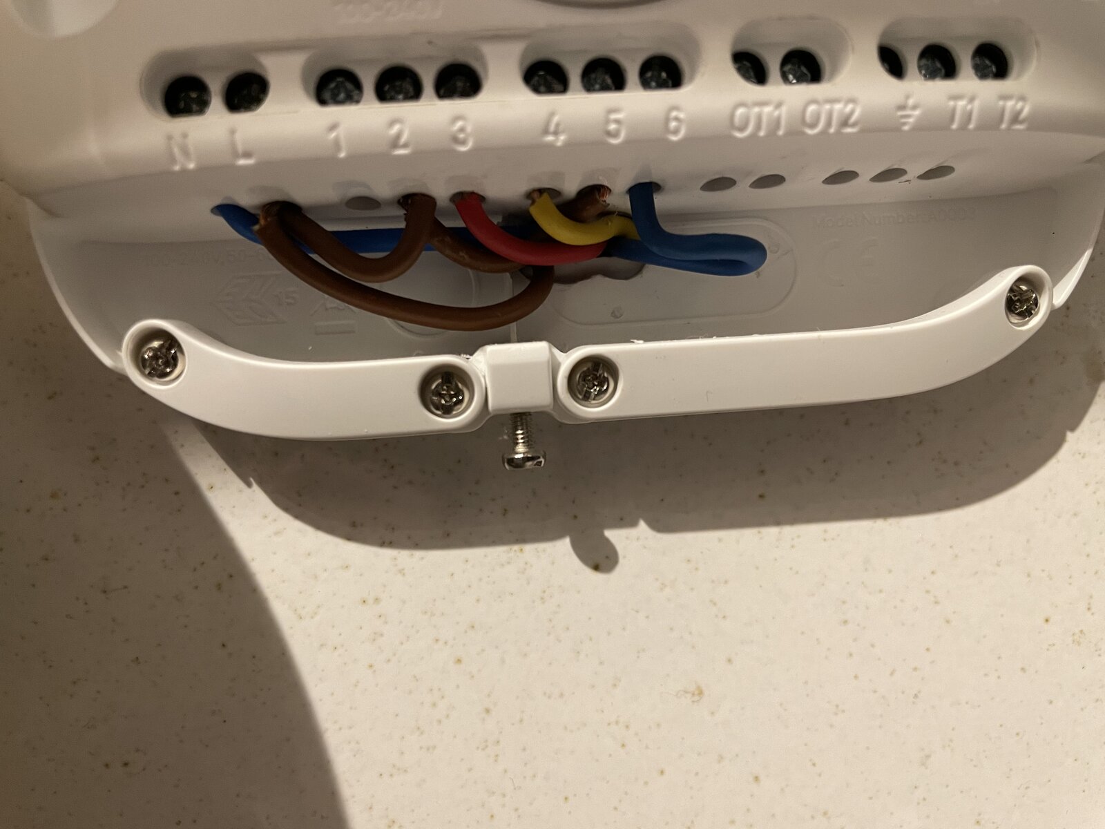

Here’s a picture of the Nest Heat Link

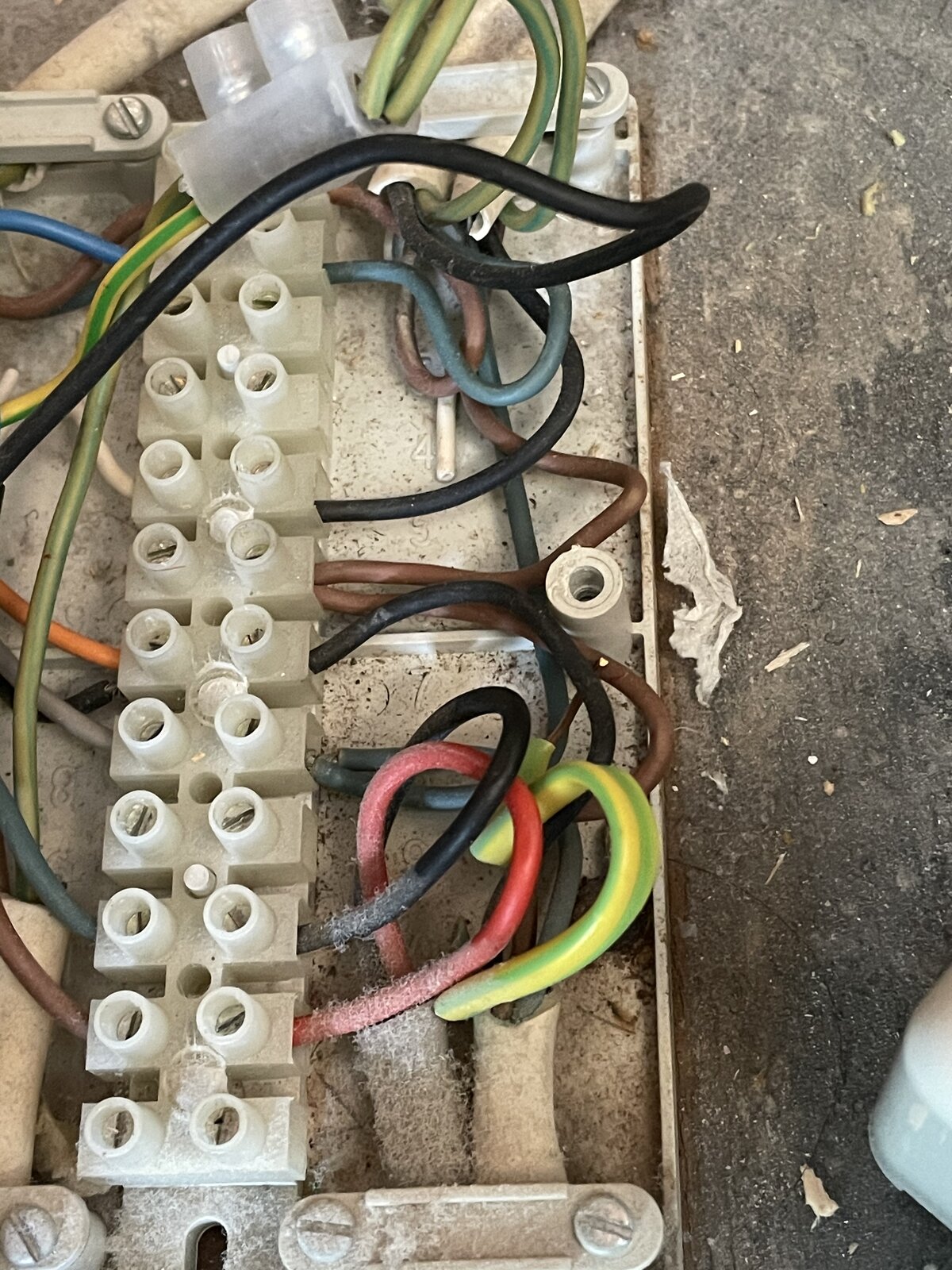

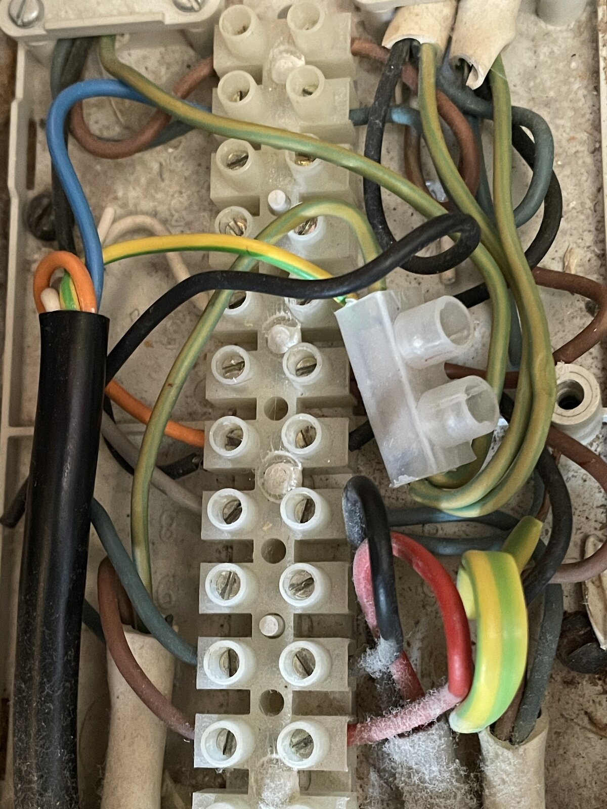

you will have a wiring centre probably what the motorised valve wires into, can you post a pic of the wiring in there
Do these help?

Wow! That will engage Ian.
If he was at your place then he might suddenly get a call to say his wife was having a baby and he had to rush off!
Others might post a photo of what a proper Wiring Center looks like!
o_O I hope so...! This is how I believe the installation has been since the house was built... we have had it for about 7 years.
it’s an ex showhouse from the 90s but you wouldn’t think it with the amount of things I’ve had to sort out. I believe the boiler itself was replaced in 2010.
