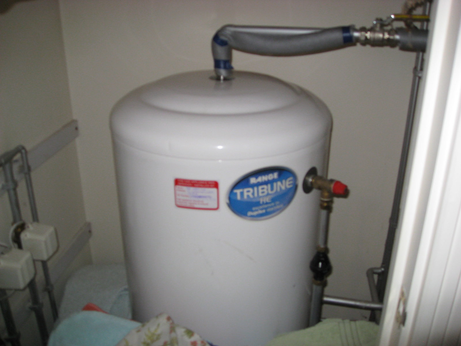

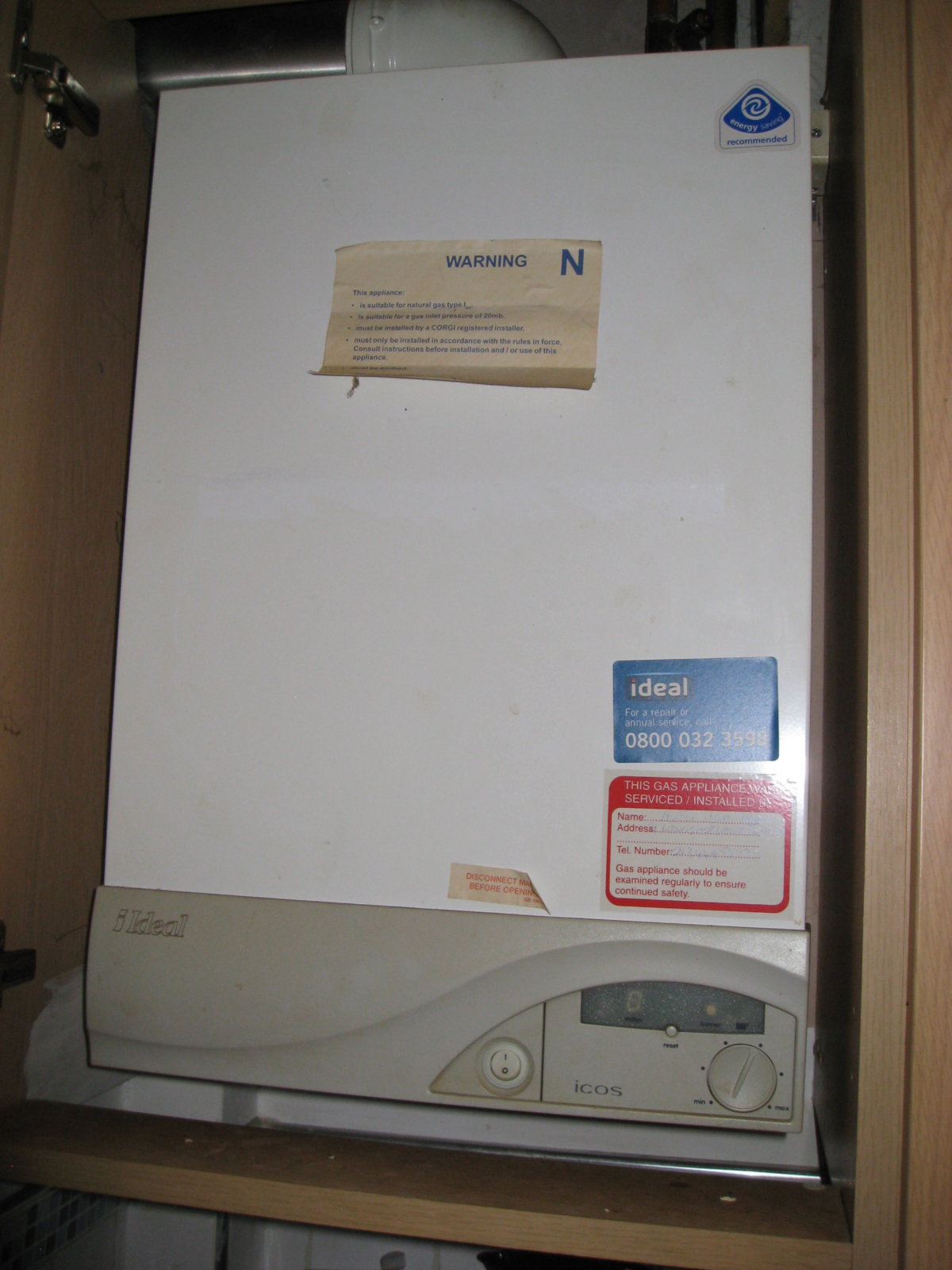

My father is having the following trouble
I have an Ideal boiler icos HE12 with a Honeywell control. I also have a Range Tribune HE Stainless Indirect 150l tank.
I can get hot water for central heating but no hot water out of the tap. However I can get hot water if I put the immersion heater on. What is the problem and is it easy to solve or do I need a plumber?

Is it a new problem, and it's been OK before?
Is the programmer calling for heat, at least for an hour or 2 each day?
Is the cylinder stat set high enough?
If all that's OK, it could be the HW valve (thanks ianmcd, I hadn't spotted the 2 valves in the pic :()
Most likely a faulty actuator on the DHW Zone valve, the two valves with white square actuators at the left hand side of your pic, there should be a small lever to manually open them, turn both the CH and HW on and feel the leavers and see if they are both in the same position, try pushing the lever across and if the HW one is resistant then you will have to do electrical checks to make sure it is getting a demand, the lever can be latched in the open position, if you do this and switch on the CH you will get a full tank of HW but only when the CH is demanded
Most likely a faulty actuator on the DHW Zone valve...
...the lever can be latched in the open position, if you do this and switch on the CH you will get a full tank of HW but only when the CH is demanded
Just to add that doing this will defeat the action of the cylinder thermostat and the hot water may be considerably hotter than usual. Tell your father to use caution when running the hot taps.
Have the faulty part replaced as soon as possible.
There is also an outside chance that the hot water will get hot enough to trip the cylinder's safety 'stat. Be sure to check this once the repair has been done, or you/the repairer may come to the wrong diagnostic conclusion (and replace the wrong part).

It might be something simpler, I'd like to see the answers to my questions first.
If it is the HW valve, it might be opening correctly, but the contacts to fire the boiler not closing, or burnt away, or something.
And I'm still curious where Dad comes into it :)
