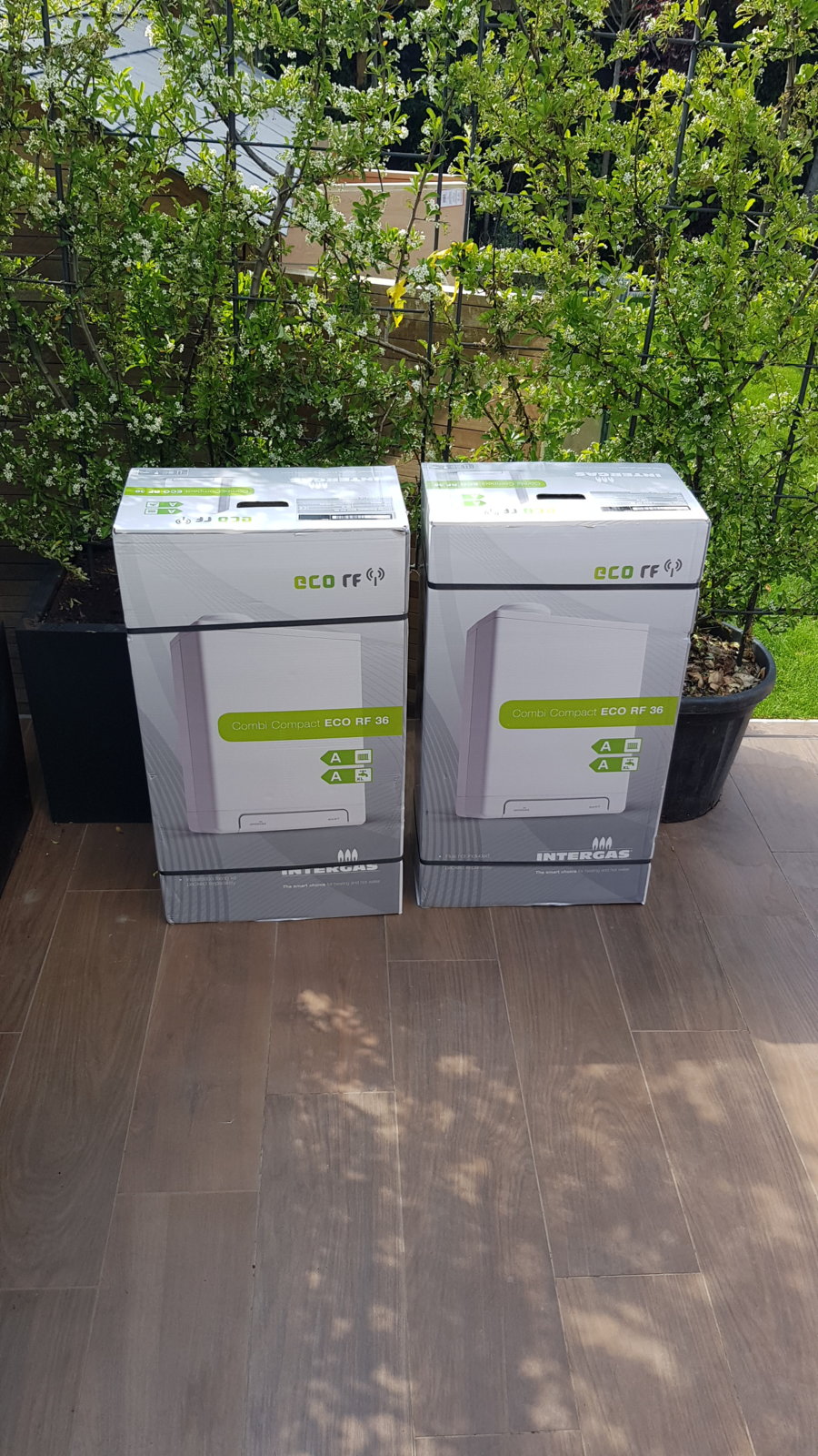

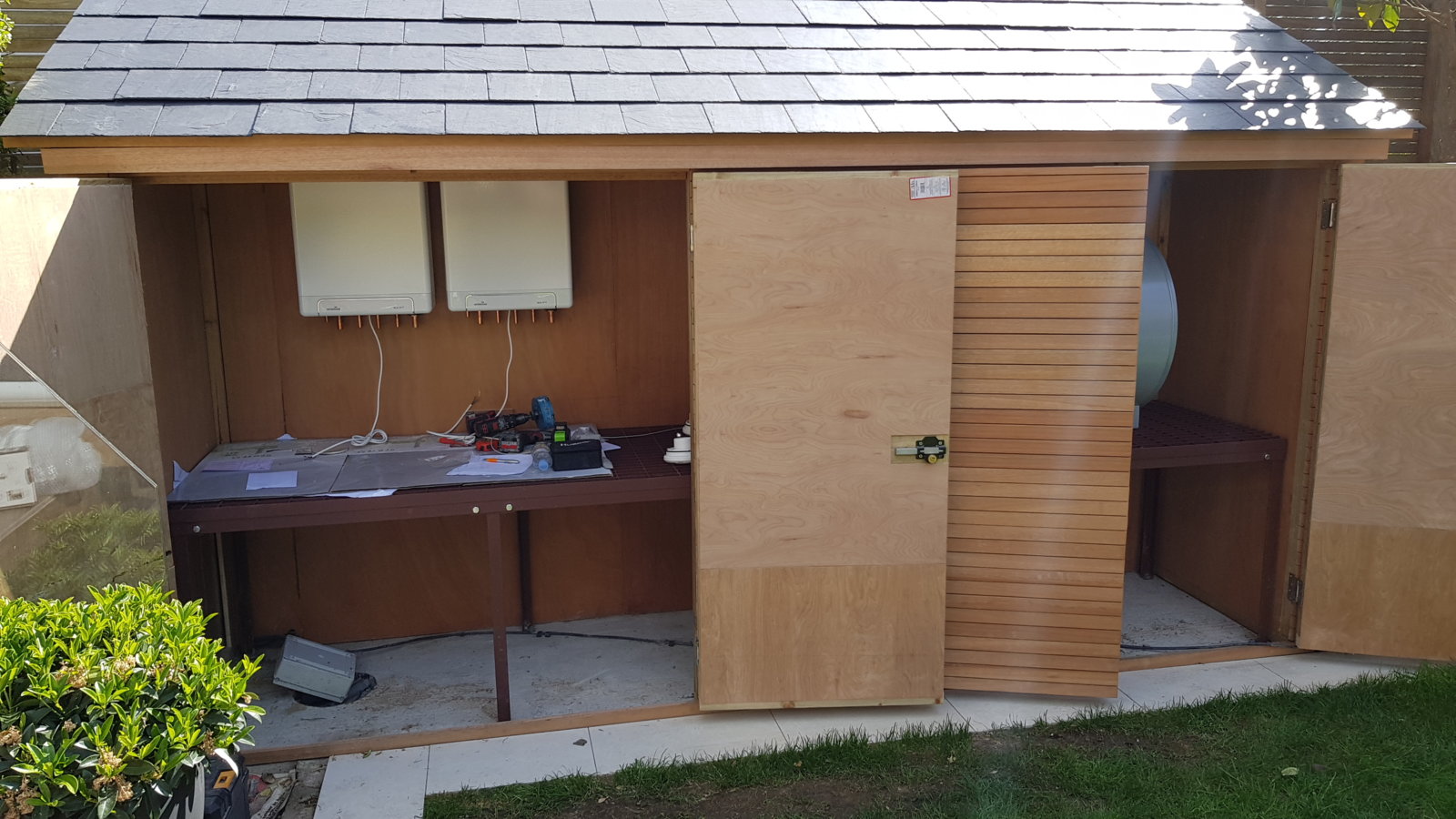

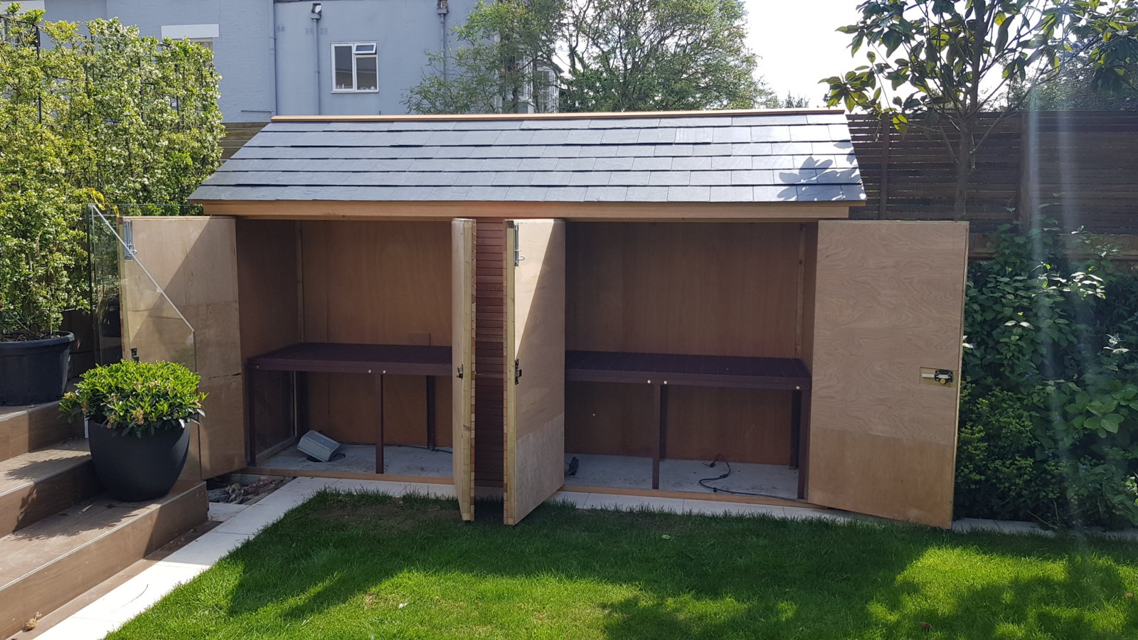

Still, spending the rest of the week in that dude's back garden fitting the twin Gashes and hot water cylinder.
