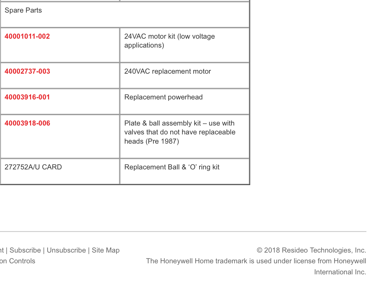

Yes, got that now. The Honeywell MVs on the system are 9-10 years old. Can the innards still be purchased ? I am having difficulty seeing a number on the box that covers them. It's all dark in there now and I will have to have a decent look tomorrow morning. Are all MVs serviceable like this ?

I am getting the impression that you are quietly confident that the problem is that the valve has failed in which case, if I can find the correct innards for the valve I can fix it myself. Are Honeywell MVs all the same inside or do I need to take the cover off first to get a number ?
V4043 is the complete valve, but you just need the powerhead really, or 230vac synchron motor (if this is the fault).
Have just watched a helpful video on YouTube. Are Honeywell synchron motors all the same or do I need to take the cover off and find a number ?
Genuine Honeywell I believe have the word Syncron written on them and cheaper ones have Syncronous. Price is a clue, but they do the same thing, but 1 should last longer than the other.
