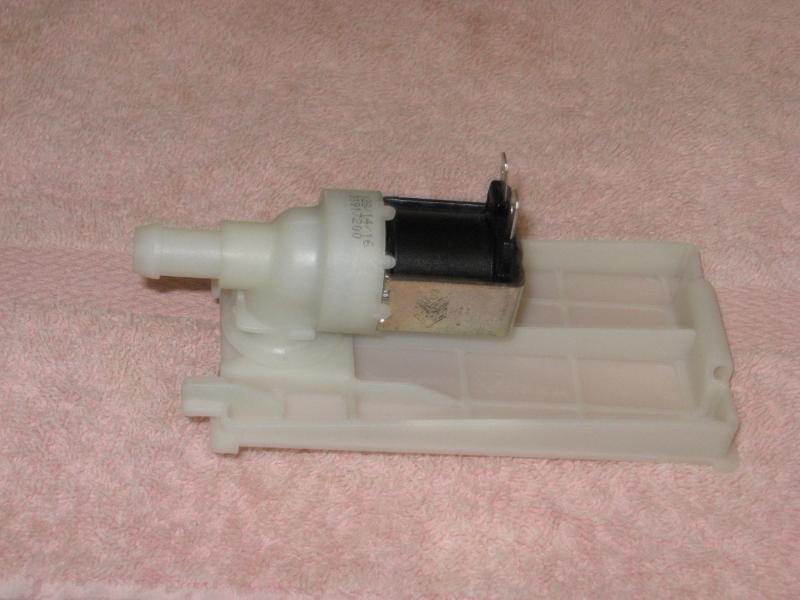

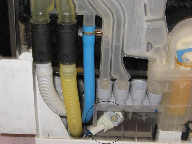

My son has come over today to repair the machine and get the lid off etc., I am not sure whether I have bought the right part though. I enclose photos but the part I have bought I think attaches to the blue hose where the main water comes in. Are you able to advise please? Many thanks. View media item 93682 If these images don't work, I believe you can go into my album.
You have bought an inlet valve, what you need is the white valve located at the bottom of the water softener container in the 2nd photo.
Thats the one.
You will need to remove it to match the valve due to variations of the plunger.
Can you easily get to the 2 retaining screws? Remember there will be water loss, amount is dependent on how much water is in the water softener container and in the tubes above.
