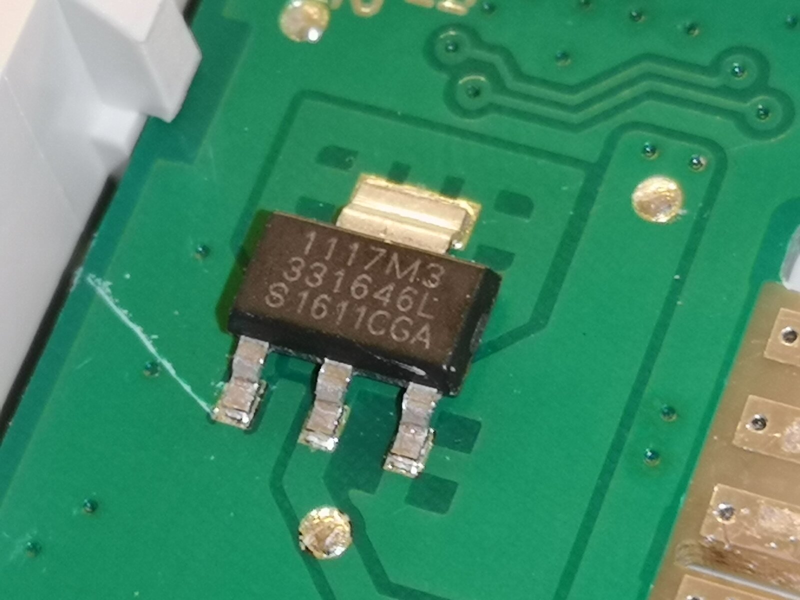

No water leaking etc, I have found this component on the switch board that is a voltage regulator. Input and output pins only 1.6 ohms so doesn't seem correct. I will order and replace and see how it goes, could be killing the 12v going up to the board, as some of the pins beep to this component.
Replaced the component above and the voltages are back up at 12v but it got very hot. Checked other components that this goes to and goes to main plc and other parts so ordered a new switch module.

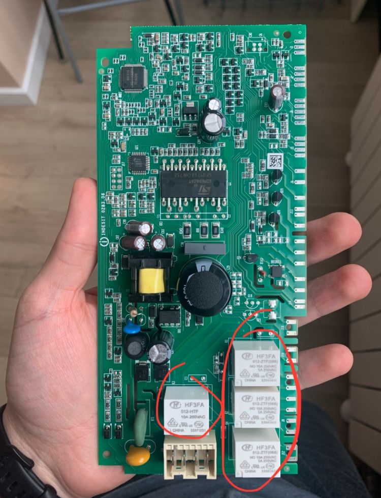

hi, dg_pug106gti! I have the same dishwasher and the same problem. It drives me crazy for a couple years. Tell me please what is the “switch module”? Do you mean elements on the photo?
The switch board was the small PCB that all the switches connect onto. There was something on the board that was killing the supply voltage.
